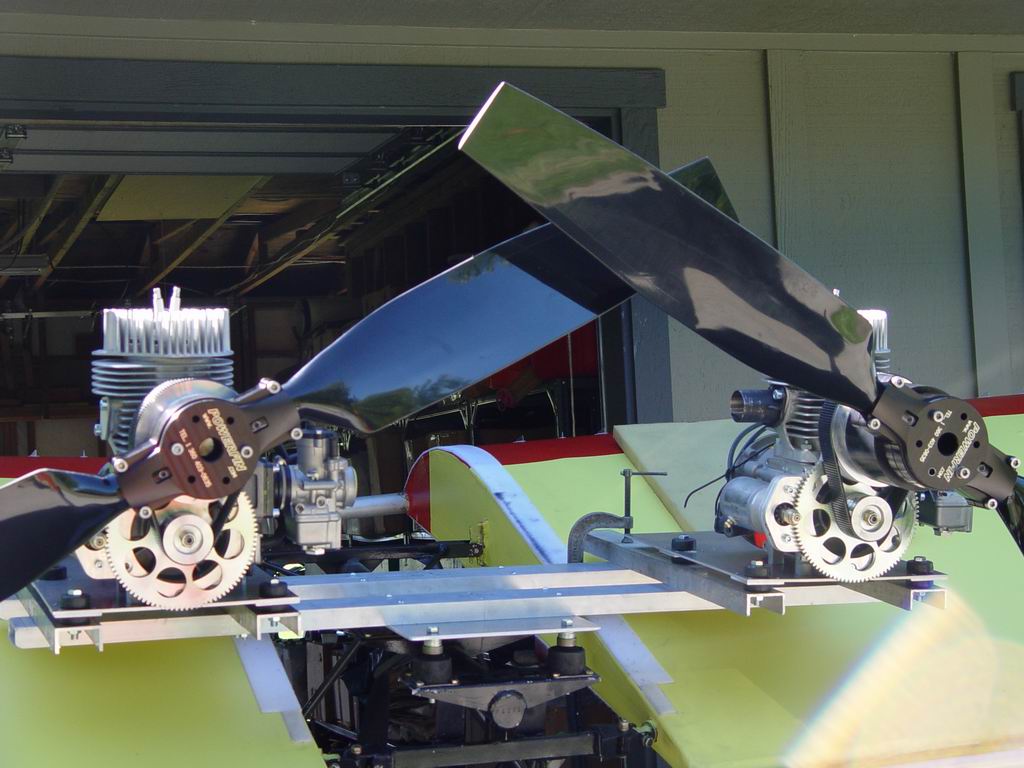

PostPosted: Fri Apr 18, 2008 1:07 pm    Post subject: Re: Homer Kolb Reply with quote
Dave put multi engines on a Kolb Firestar Smile Great idea, but there was interaction between the props that produced to much vibration.

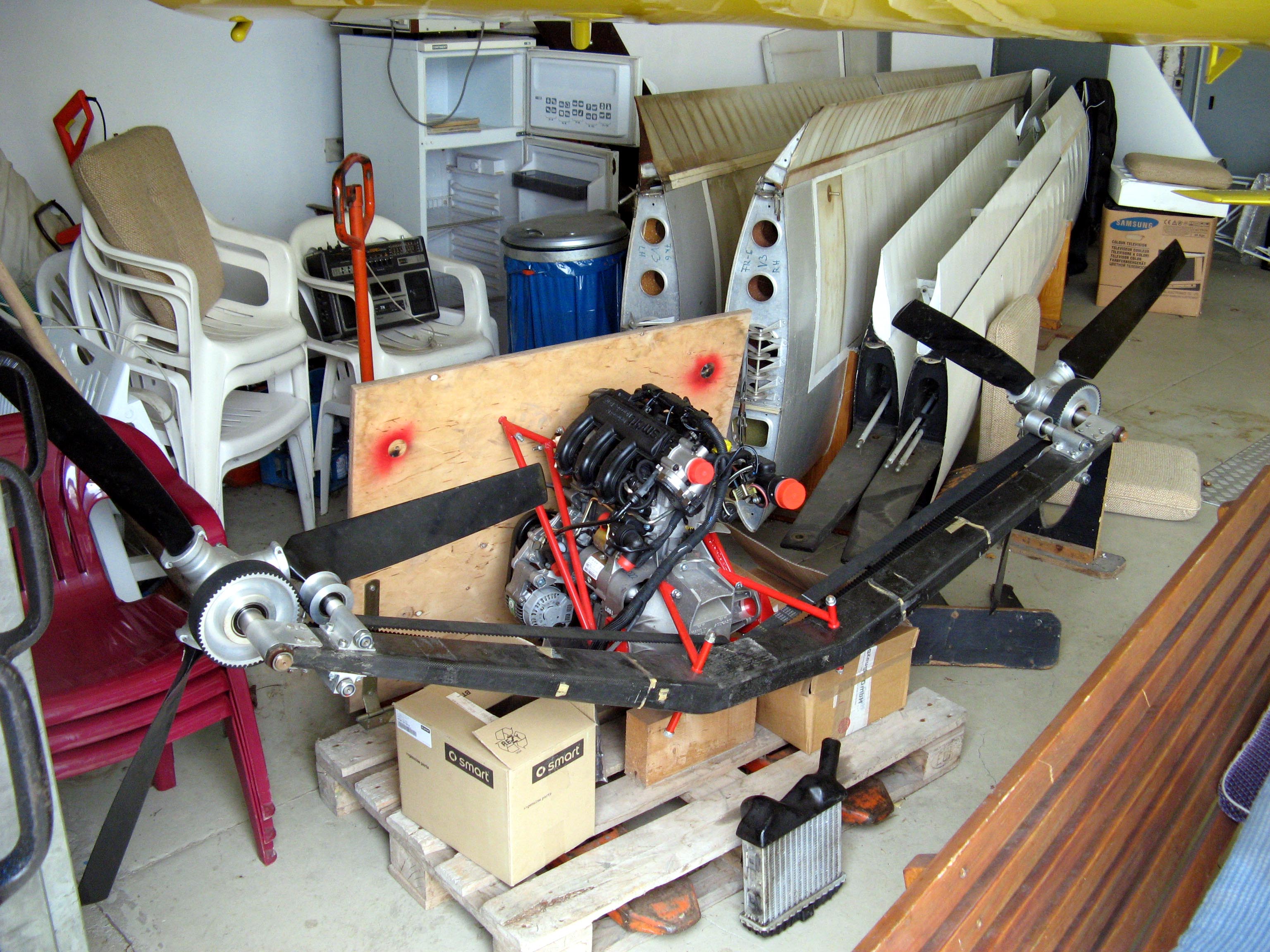

PostPosted: Sat Apr 19, 2008 12:47 pm    Post subject: Re: Homer Kolb Reply with quote
If twin engines pose a classification problem, how about a single engine driving two props ?
David.

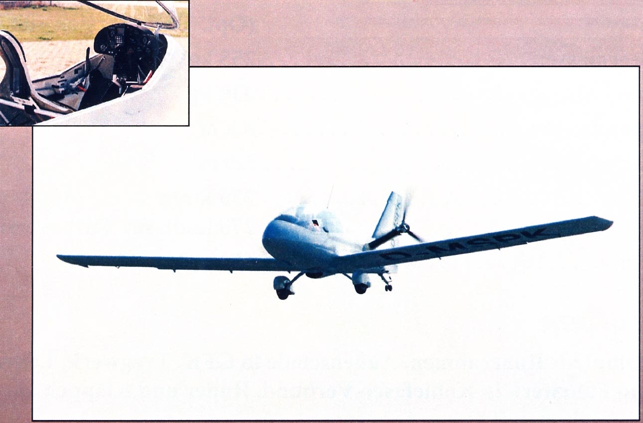

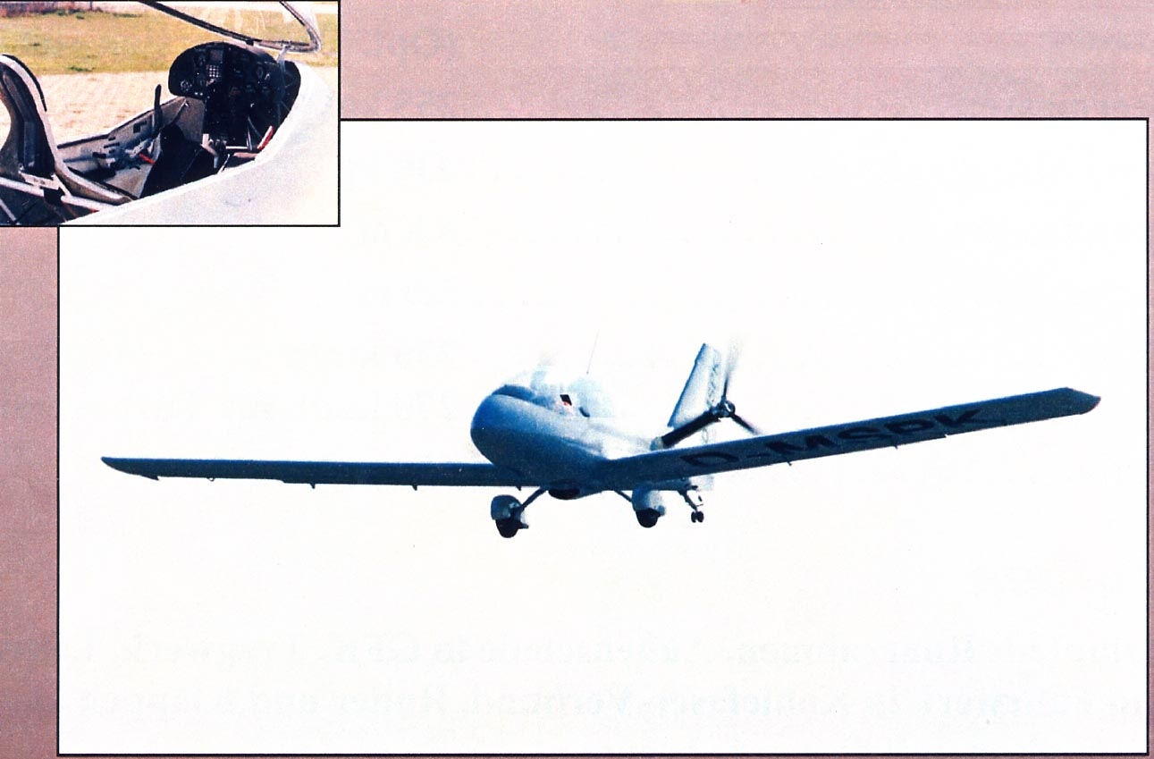

PostPosted: Sun Apr 20, 2008 5:27 am    Post subject: Re: Homer Kolb Reply with quote
There is always someone out there that will try something very stupid
Well maybe Mike, but this is NOT one of them. It is neither 'stupid' nor 'very stupid' (Nb. Your adjectives seem always to be way too strong). What it is, is the result of entrepreneurial spirit and technical expertise complete with the funds to follow up on it.
This application was flown on a proof of concept aircraft, the German FK11 (see attached photo), and while it did not go into production, this was because of other commitments stifling the project and not because of failure of the concept. It worked ! The idea was to get the props working in the cleanest air possible in a pusher application rather than directly behind the fuselage/wing area with all the conflicting air-flows there that negatively affecting performance and increasing noise levels.
driving 2 props with a single engine is definitely one of them
Wrong, some applications require two props to absorb the power, eg; the Russian Tupolev Tu-95 'Bear' one of the fastest subsonic aircraft flying today. but on the application I showed, it was for efficiency reasons, not power absorption. The reason for this layout I described above. A good reason !
The whole idea of twin engines is to be able to fly the plane if one engine quits, even if the second engine results in an extended glide, you have something...
Granted, this is one of the benefits of twin engine flying, even if, as you say, the second, or remaining engine only "takes you to the scene of the accident" Wink
With a single engine and two props, you have every disadvantage of complication, and asymmetrical thrust and with no advantage of two engines.
Well, that assumes engine failure being the one and only problem. What if a drive belt fails, it's happened right ? In this case the other prop will still be receiving power giving you further options that a single prop plane would not have. That seems like an advantage to me. You might well have to improve rudder authority in such a case, eg. Larger vertical stab or (dare I say) VG's, but if that's so, I don't see it as a disadvantage.
As to application to a Kolb, it might be possible. Someone had gone to the trouble to install twin engines but had consequential problems. This just might work. Someones curiosity might be satisfied by trying it. Who knows, that's all I posted it for.

David Lucas,
Do you know the diameters of the two three bladed props used and the power of the engine in the picture you posted? This would be more efficient if longer two bladed props were used to increase disk area. To do that, this mount would have to place the props behind the ailerons on a Kolb.
Also, it looks like the props are turning the same direction, but the belt tensioners are on the same side of the frame. If this is so, one belt is being tensioned on the loaded side. This is not generally a good idea.
As configured in the photo, I doubt that this set up would be any more efficient on a Kolb than one larger diameter prop.
Compare the disk area of a 66" prop (13,685 sq.in.) to that of two 50" props (15,707 sq.in. total) and you can see that not much is gained. The added weight, increased complexity and decreased efficiency of two smaller props v.s. one large one will likely outweigh any improvements from better airflow or the slight increase in disk area.
In short, I think this is a bad idea for a Kolb and I haven't used the word stupid anywhere. I do have to admit it looks very cool though.
