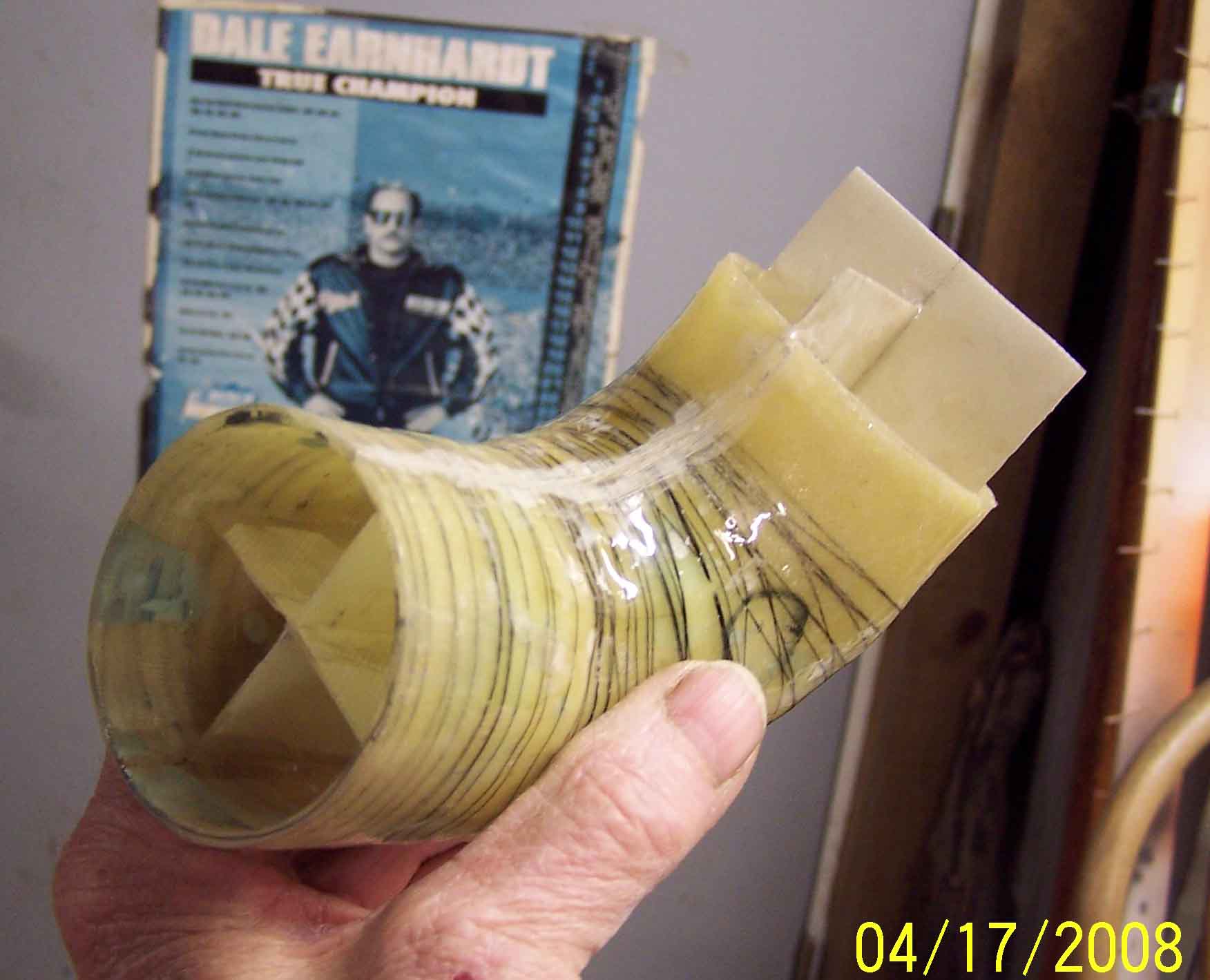

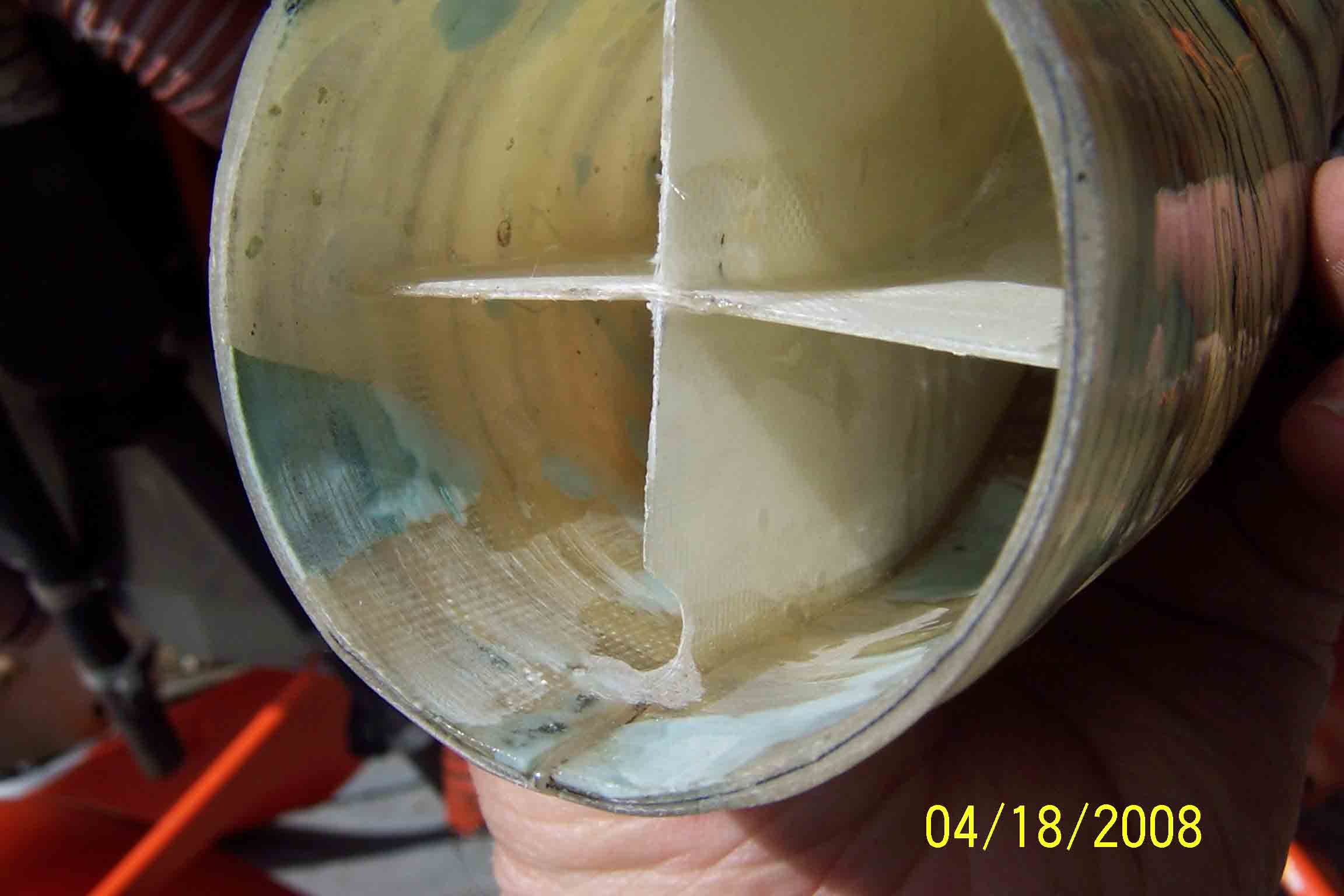

Here are pictures of the tube I just got done modifying, by adding
vanes throughout its whole length of about 6", measured right down
the center. I cut my tube lengthwise and made fiberglas vanes
inside...quite an ordeal, but it didn't HURT the performance, but
time and a less windy day than today will tell if it did any good.
Whether or not it was what did it, but I can now open the throttle
as fast as my hand will open it, and it responds NOW. Of course,
the weather has improved since the last time I tried it, so the
variables might have something to do with it. I also climb at a
better rpm...now it's 2840 or so, and before it was 2750 or so, but
that was during cold weather, so I can't really compare apples to
apples here.
