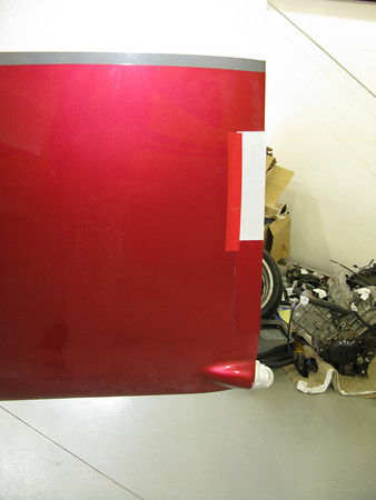

Scott - very nice - I like your KISS approach. Is there any way you could post a picture of placement. Also where did you get the tabs or how did you fabricate and locate them?

Here is a shot of the two rudder trim pieces that can be bought at Avery Tools.
The bottom one is a little harder to see because the paint matches.
I will now send out the top one to be painted.
I attach them with silicon rubber.
