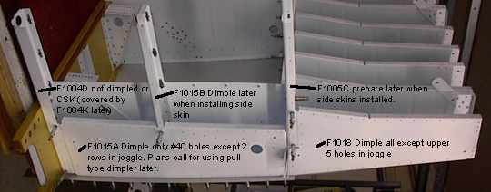

I'm about to rivet the Mid Fuse Ribs (Section 26) and I'm a little confused
on what to dimple/CSK, or leave alone. Attached pic indicates what I think
is proper. Can anyone confirm or correct?
Thanks.

Al, I just finished Sec 26 and benefitted from the dialogue on this
section that took place a couple of weeks ago. Here's what I've done,
... so far.
F1004D,F1015B,F1005C - nothing so far, I'll wait til the side skins get
attached, hoping it will be more obvious/self apparent at the time.
F1015A - I dimpled all of the holes that match with the side skins
outlined in Sec 29-17 (these were #40 only) Sec 29-15 say's don't dimple
the #30's
F1018 - Ditto

Albert, you seem to have it right to me except for the #30 holes in
F-1015A. They do not get dimpled at all the way I read it. See page 29-15
for the skin layout. I'm glad I looked at this as it would seem also that
the 3 holes behind the rear spar carry through-in the same row (in F-1018)
do get dimpled. I don't see those on your picture, you may want to look at
the side skin... I'm pretty sure you match drill those through the skin..
Cheers..

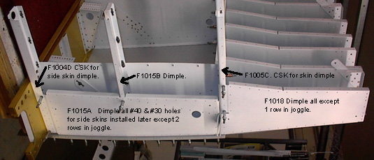

I got 3 feedback messages that corrected/clarified my understanding of
dimpling the mid-fuse ribs. Here is a corrected picture and the 3 messages
posted. Apparently all of this could be done in later steps but dimpling
F1015A and F1018 now is easier. Many thanks to those who have forged the
trail.

Al, I just finished Sec 26 and benefited from the dialogue on this
... so far. F1004D,F1015B,F1005C - nothing so far, I'll wait til the side
skins get attached, hoping it will be more obvious/self apparent at the
time. F1015A - I dimpled all of the holes that match with the side skins
outlined in Sec 29-17 (these were #40 only) Sec 29-15 say's don't dimple the
#30's
F1018 - Ditto

Albert, You don't want to dimple the #30 holes in the F-1015A because those
don't get dimpled in the skin (29-15). Don't countersink the F1004D because
it gets covered up by the F-1004K (28-9 Fig 1). Page 29-15 is helpful too.
For what it's worth, I didn't dimple anything at the step you're on. I did
it all right before I put on the side skins. At that point it's
real easy to see what needs to get dimpled/countersunk. The only thing I
wish I would have dimpled ahead of time was the #40 holes in the F-1015A
excluding the joggles and the F-1018. If you wait, then you need a #40 3/8"
(little) pop rivet die for the holes along the bottom of the rib. Oh, and
don't put the nutplates on the F-1076 bottom skin (26-7 figure 1) yet. They
make it really hard to get the side skins on.
