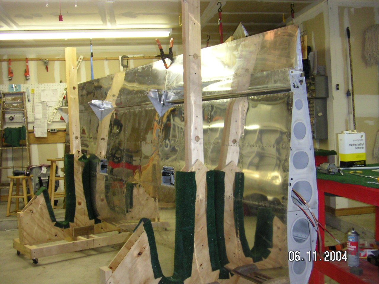

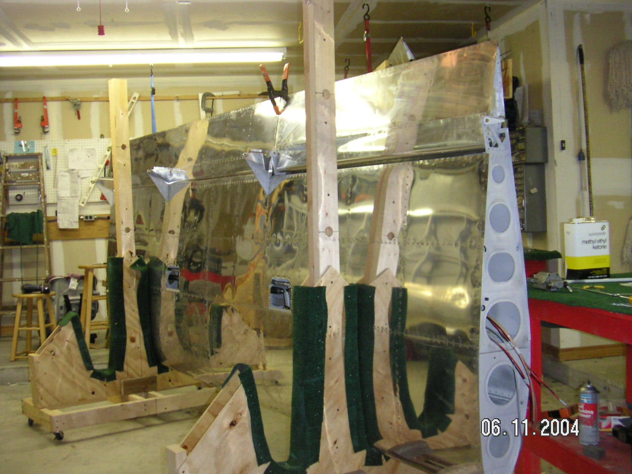

PostPosted: Wed Apr 16, 2008 5:47 am    Post subject: wing rotisserie & paint booth Reply with quote
The rotisserie wing stands where used to build my wings. I could
offset, rotate the wings vertical and slide them to the side of my
garage. My wife was then able to park in the garage and life was good.
There may be a better method and this may be overkill for painting. I
also used one pair of stands as wing cradles for storage and moving the
wings to the airport. Just cut the wing rib pattern in the plywood
bracing and cover with carpet.
