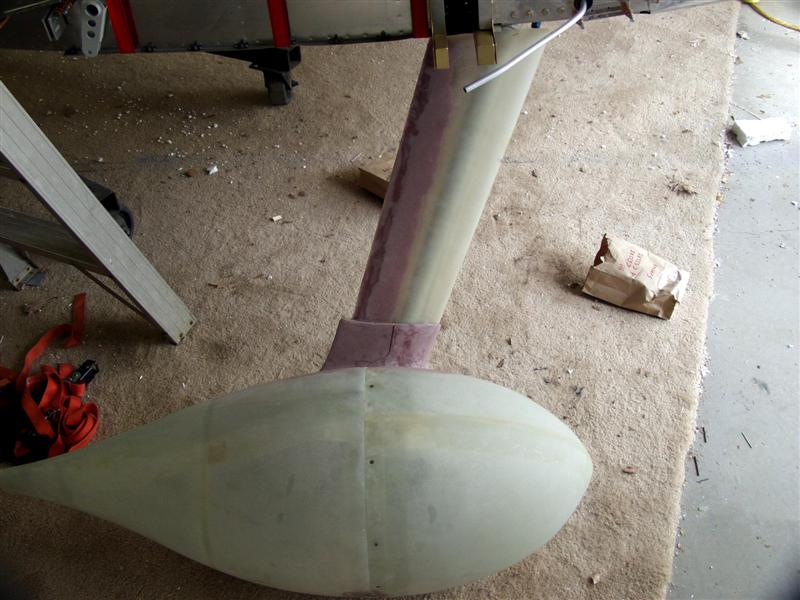

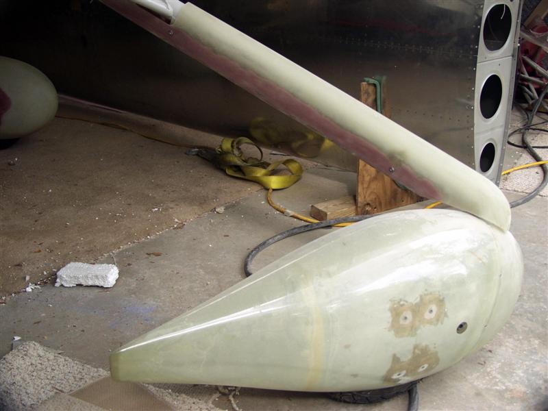

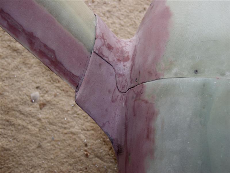

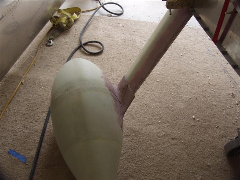

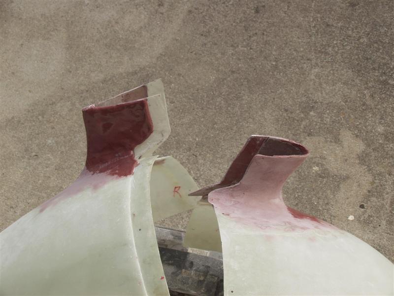

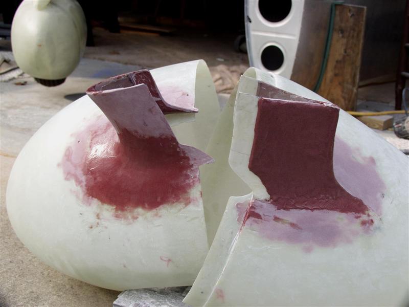

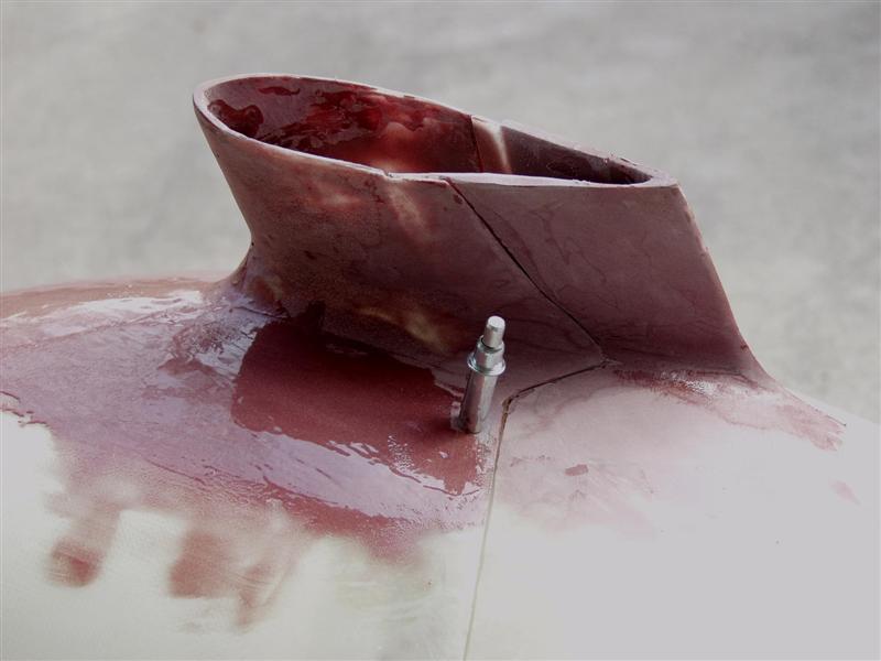

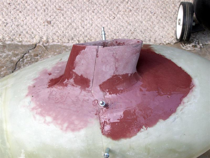

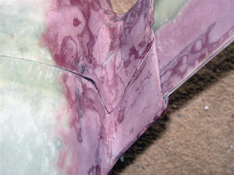

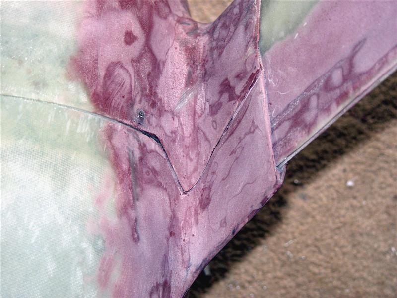

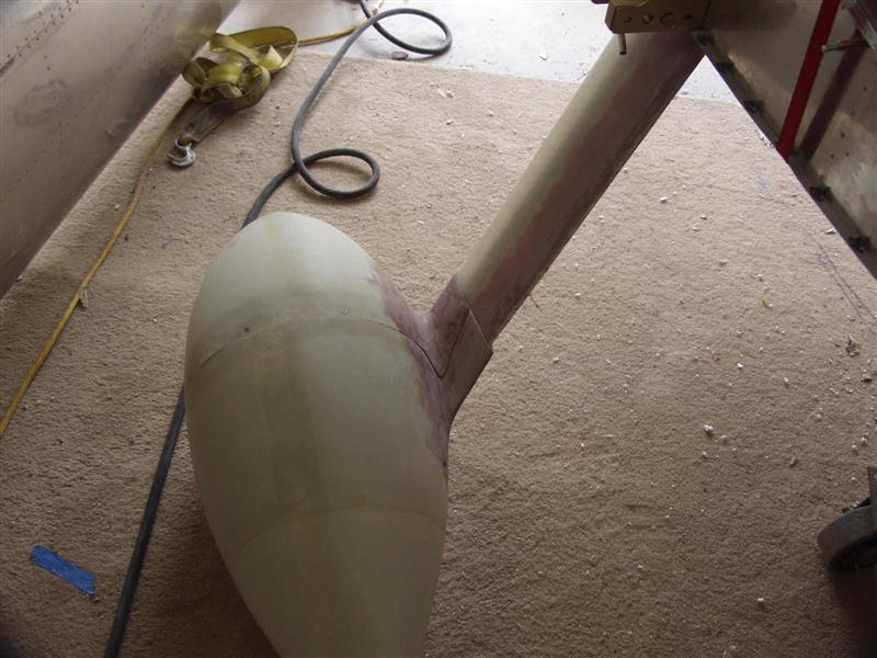

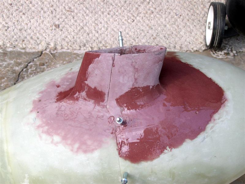

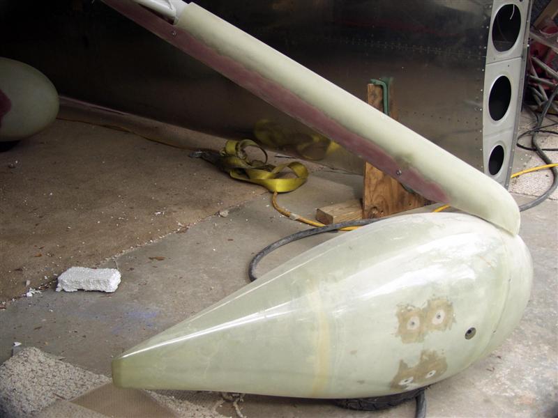

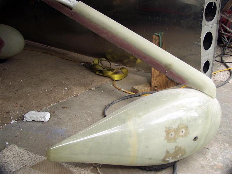

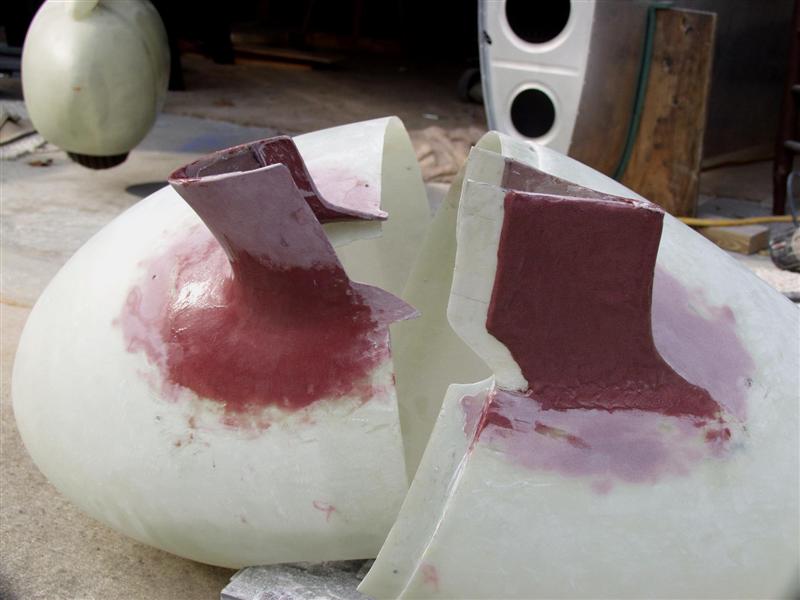

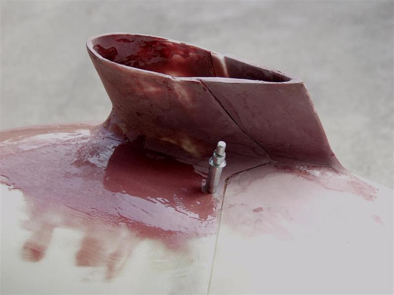

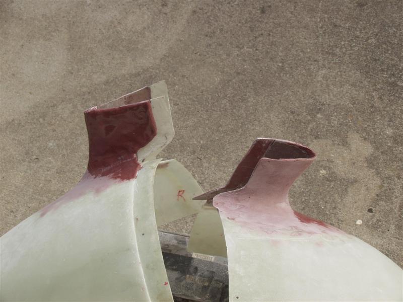

If anyone is interested, I thought I'd post some pictures of how the wheel pants fiberglass work is turning out. This is using Fred Williams' model. (THANKS FRED!) You can also see the covering of the hinge rivets on the strut pants.
I forgot to take pictures of the initial splitting of the lower fairings. I split them first, then positioned them on the strut fairing with the wheels off the ground, strings pulled to the step, etc. then drilled and clecoed the halves to the wheel pants, then fiberglassed them in position, filled the cleco holes, built up overlapping lips (2" glass cloth/resin) ... and there you go.
They sandwich together and hold the strut pants perfectly in position, eliminates the screws on the lower strut fairings. If you are planning on doing this, it's best to split the fairing just forward of the apex of the strut curve -- otherwise you have to spread the front lips to install them on the back half.
No Bondo -- you convinced me! Mixing the microbeads in the fiberglass (Western systems) is a bit more trouble, but it smooths OK and no worries about bonding. With primer (2K urethane) they will slick up just fine.
The plans for the upper strut fairings look a little dinky to me -- sheet metal screws? Has anyone improved upon this? I guess it's not really critical and since they overlap the fuse and the wing joining panel, they have to be removable.
Probably a little weird, but this glass work gives me lots of satisfaction.
Later, - Lew
