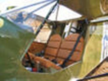

Mike Sinclair's 701 tail dragger has a canister BRS which you can just barely make out in this thumbnail. Maybe he kept the weight down:
I’d post the full-sized picture but Barnstormers is down.
