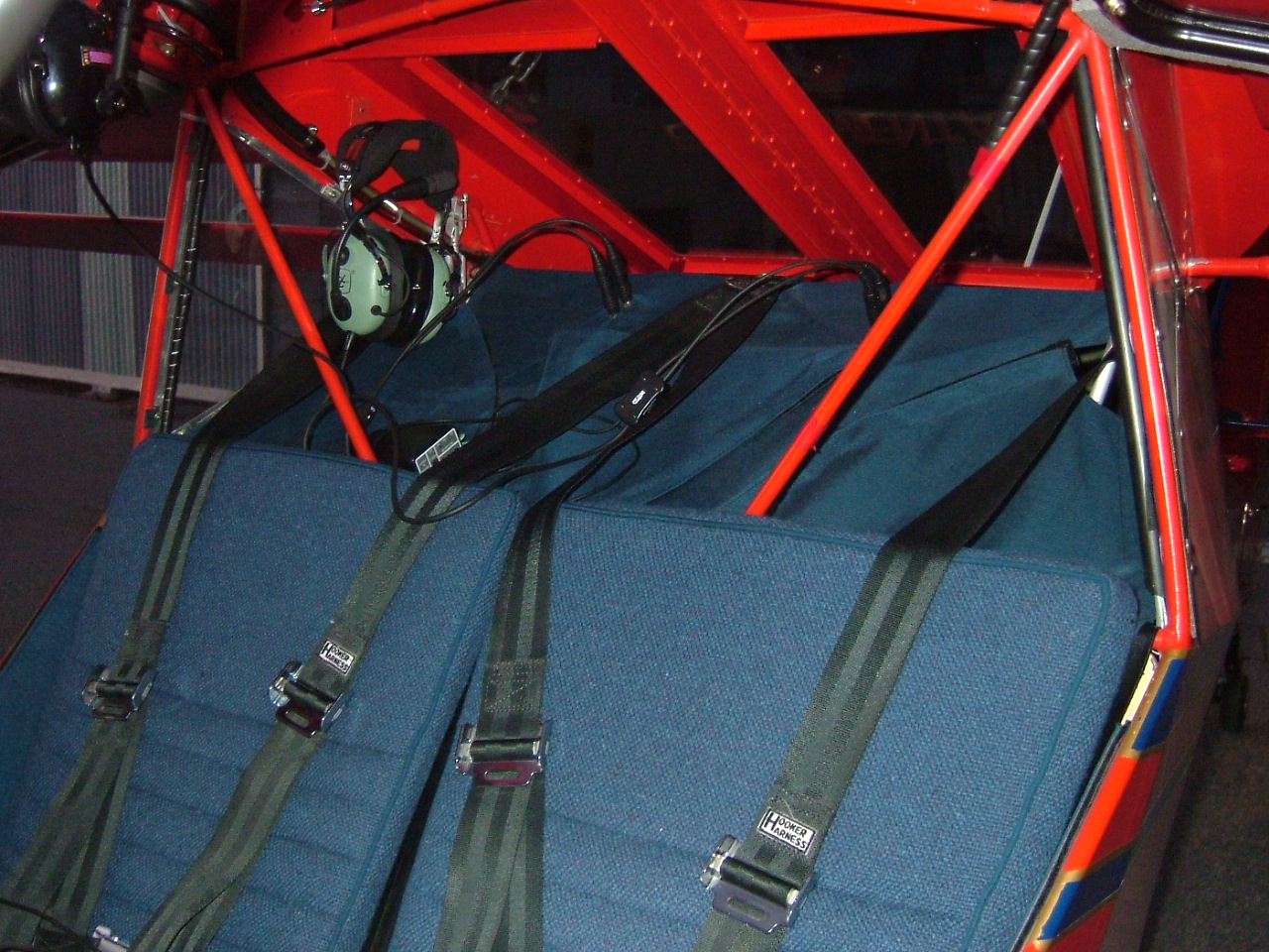

Pete,
This same thing happened with my Model 3. Buesky Aviation makes a slick retrofit kit for the side windows on the earlier models. This is what I used and the look and usefulness of the window was greatly increased. The kit comes with the plastic, aluminum frame and aluminum brackets for mounting. The instructions leave a lot to be desired but the installation is dead simple...I think I did it in an hour or so. Here is a link:
http://www.blueskyaviation.net/catalog.html
I have attached the best and only picture I have that shows (kind of) the windows after installation. You can see how much larger thay are and how much more light can be let in. Man, looking through the pics of my old Model 3 makes me really miss that bird...
 Filesize:  465.31 KB
 Viewed:  593 Time(s)
Darin Hawkes

On Apr 11, 2008, at 2:41 PM, darinh wrote:
Pete,
Darin Hawkes
Series 7 (Painting)
914 Turbo
Kaysville, Utah
http://forums.matronics.com/viewtopic.php?p=176219#176219
http://forums.matronics.com//files/dscf1087_209.jpg

PostPosted: Fri Apr 11, 2008 4:37 pm    Post subject: Re: Small Side window? Reply with quote
Lynn,
I used some 1/16" adhesive backed neoprene foam tape and it sealed very well. Don't remember any air leaks from the windows at all.
Darin Hawkes
