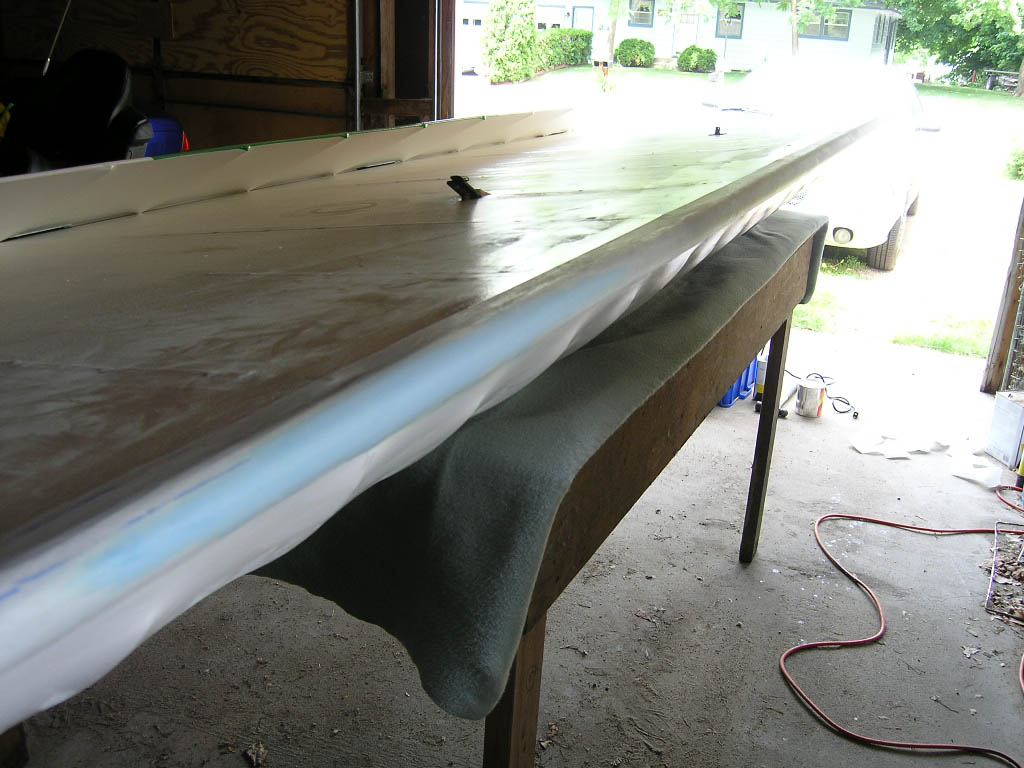

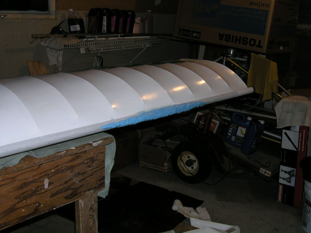

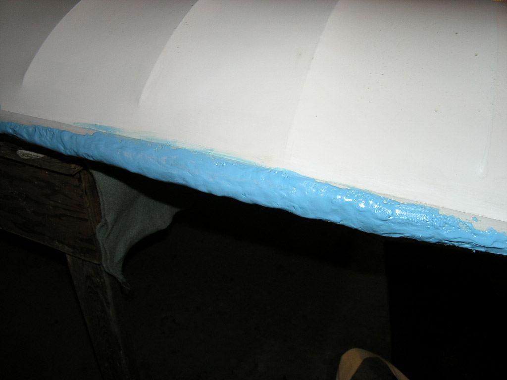

The dent is only cosmetic, but there is a nice way to fix it. Order PolyFiber Super Fill. Remove the leading edge finishing tape and apply the mixed Super Fill over the dented area. Apply more than is needed (see pictures), then sand it to contour with the tube. Be careful to sand in small steps using a light-grade sandpaper. Sand a little and use a rule along the leading edge to check it. It sands very nice. I didn't have to use any template or anything, just eyeballed it. Reapply new finishing tape, dope, paint, and the dent is completely gone like it was never there.
Ralph
