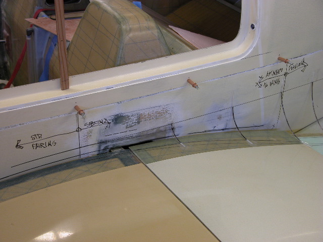

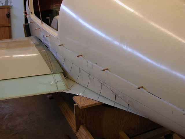

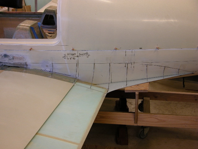

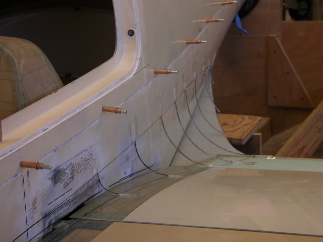

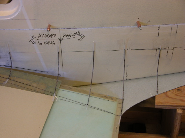

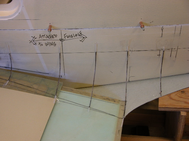

Gentlemen,
While trial fitting the wings and setting the angle of incidence, I
took some time to mock up an enhancement of the fairing in hopes of
reducing interference drag. The gist is to start w/ the radius of the
standard fairing just forward of the spar and extend the tangent point
aft along the fuselage waterline until abeam of the flap trailing edge.
My intention is to cut the supplied fairing just forward of the spar
and increase the radius aft as shown in the pixs. I plan to have a
lapped joint at the trailing edge of the wing (not the flap) and secure
the new fairing aft of the wing to the fuselage, overlapping the flap;
the fairing forward of the trailing edge of the wing would be glassed
to the wing in the normal manner.
I anticipate placing the rear pip pin w/ the use of a modified set of
needle-nosed pliers thru the standard hole.
I have not resolved the issue of trailering as the projection from the
fuselage will create a conflict when the wings are stored alongside,
though I am hopeful that the spar carriers on the trailer can be
relocated to provide clearance and still stay within the overall width
limitation (8 feet) for highway travel.
Might this be: Much ado about nothing?...a promising
development?...beyond the pale?
Thoughtful comments would be appreciated...especially from anyone
qualified to opine about the aerodynamics of such an installation.
thanks, Fred

Fred,
Nice pictures and mockup.
Reducing interference drag is always worth some thought. Some in flight
data, such as tuft tests prior to any modification might prove valuable.
Also, if drag is in consideration, cooling drag is an area where the
Europa could really benefit.
Best regards,
Gilles

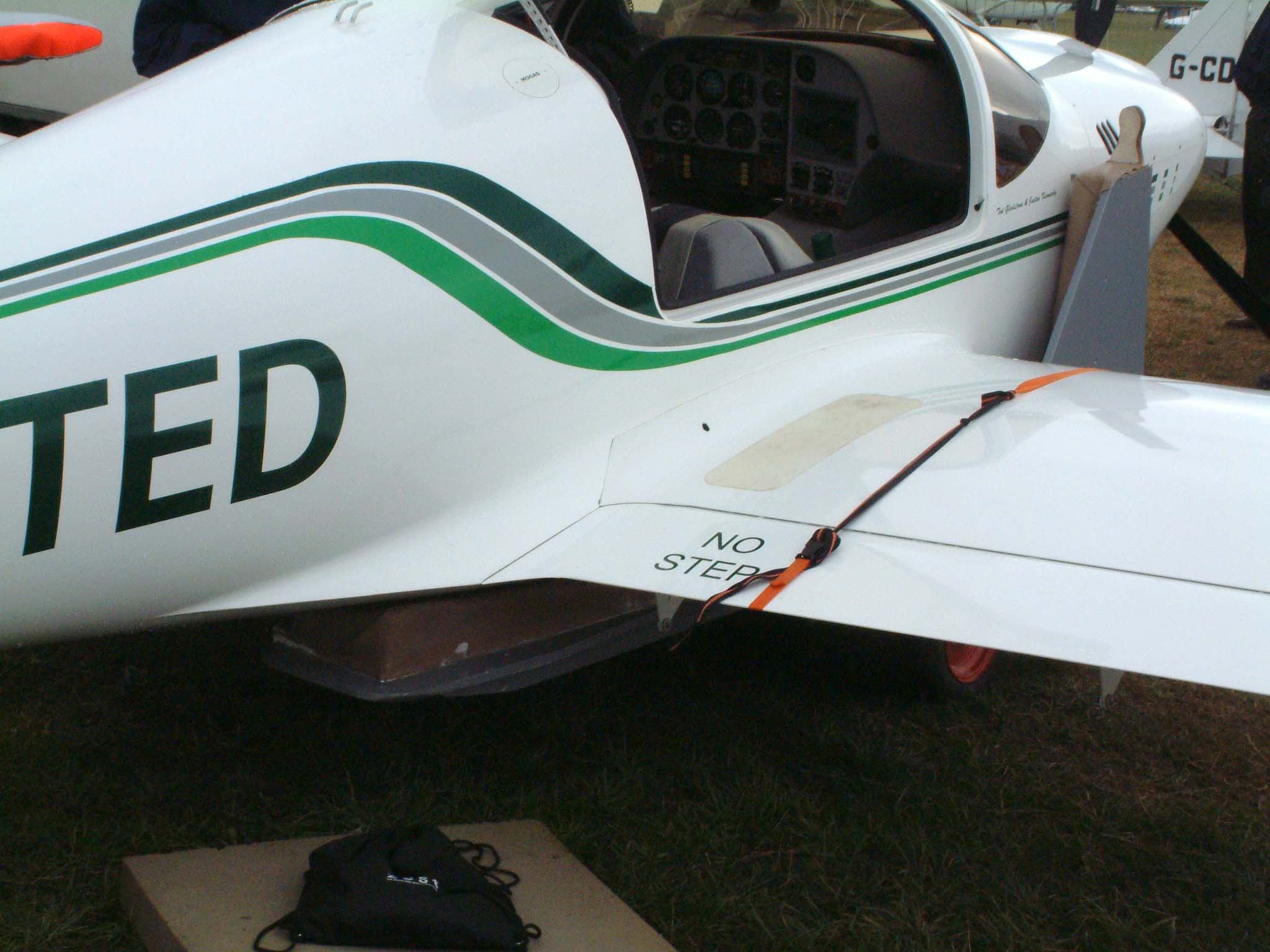

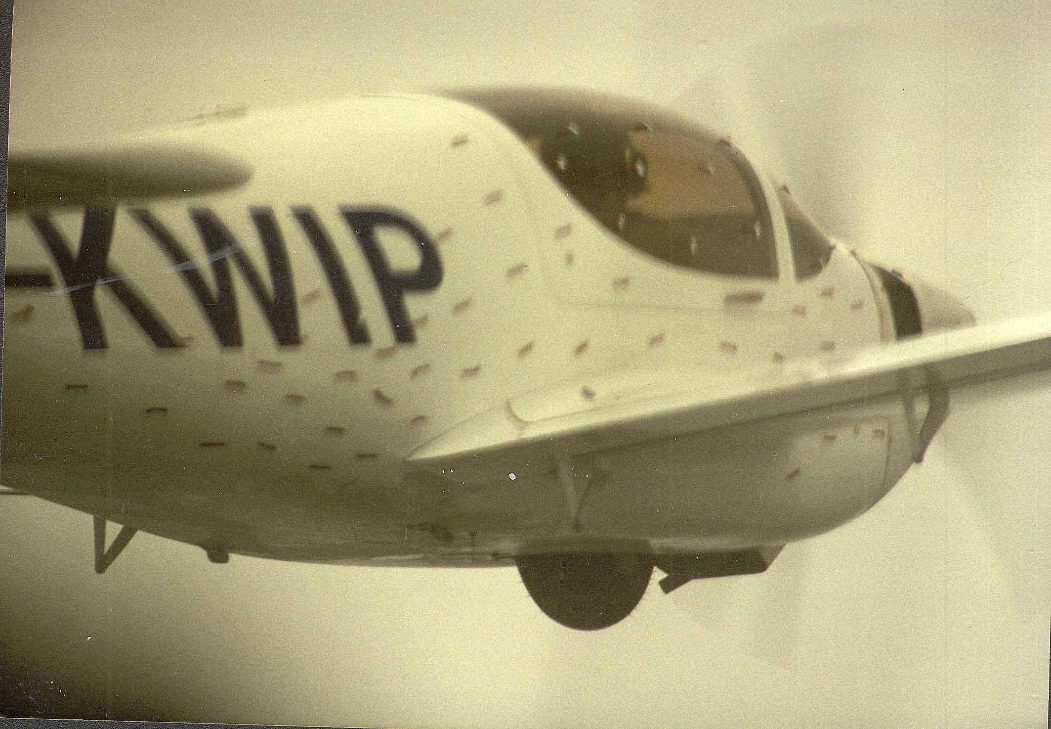

Fred
looks good to me, have a look at the fillet I did 10 years ago, not
perfect and I think yours will be better.
Ted Gladstone claims 4 kts I think.
Just remember the wing root flexes up and down a couple or three mm. so
the fairing must be flexible. Not a problem
Graham

Fred, It might be worthwhile for you to talk to Justin Kennedy (
justin(at)systemwise.co.uk ) who designed some very elegant wing fairings for
his plane which are flying and performing well. William Mills was impressed
enough to take some female mouldings from them with a view to making some
for himself (He had not done so at the time of his crash) Those female
moudings are likely to be made available to anyone interested via the Europa
Club. regards, David Joyce, G-XSDJ

David
I attatched a pik of Justin's fairings, Ted Gladstone was Justin's
partner and I understand did the building or most of it
Graham

Nice looking layout, Fred. Now, if you'd stop mucking around with all
those extras, you'd be flying...
