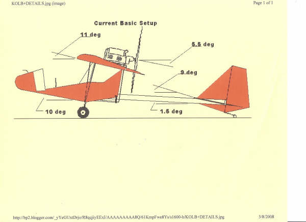

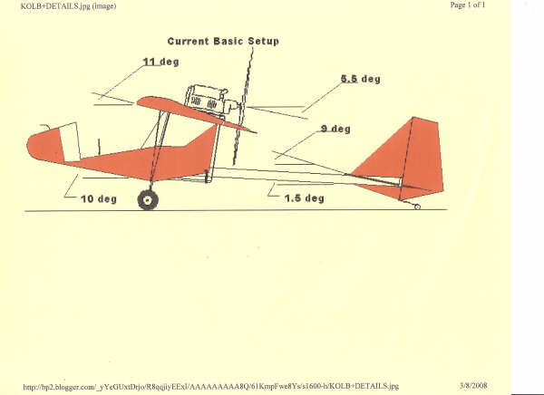

Kolb people,
By any chance, is there an Xtra owner that has a drawing like the one I have attached, but for an Xtra, especially if it includes the angles like this one does.
I found this drawing on somebody's website quite awhile back, and I can't remember who's it was (maybe Jack's). But, what I really need is is one that reflects all the proper Xtra angles, not a Firefly/Firestar.
Additionally, does anyone have the 3 view drawings of an Xtra??
Mike Welch

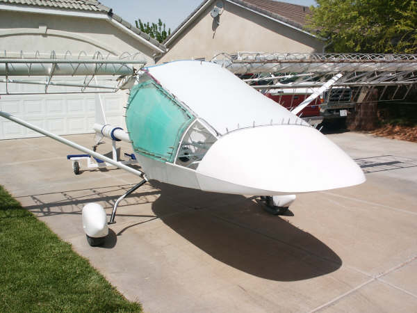

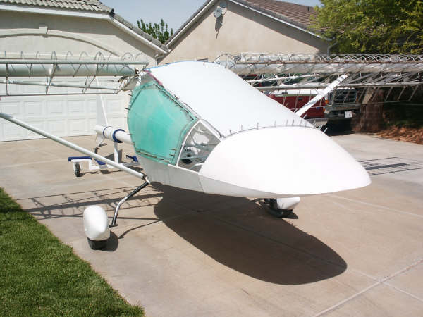

Hi Rick,
Thank you for the reply. It may be possible you misunderstood my need. I already have complete construction plans; they are the original plans that came with my Kolb MkIII, when I purchased the kit in 1998. I have built everything (wings, tailfeathers, controls, etc.) according to the OEM MkIII plans, long ago. (8 years)
The changes I've made to my MkIII (the Xtra conversion) don't have much to do with plans, per se', because
the changes are mostly in the fuselage design modifications.
To make my MkIII Classic to MkIII Xtra conversion, I had detailed drawings/photos and dimensions of
a genuine Xtra fuselage, to allow me to make most of the changes fairly easily. Basically, it was just a matter of cutting & welding, to put it in the most simplest of terms.
So, as far as building the entire plane goes, I have my original MkIII plans. What I was specifically asking for was:
1) a side profile of an Xtra that reflected ALL the angles as was shown on that drawing I attached to my first email request.
2) a three-view drawing of an Xtra. It is my understanding this is required documentation, to register as "Experimental Amateur Built". I would think ALL Xtra owners have this drawing, yes?
Even though I have the 3-view drawings of a MkIII Classic, that came with my plane, it no longer remotely resembles a Classic, anymore than a Kolbra resembles a Firefly. I mean, look at the photo. Does that look like a MkIII Classic? Not in my opinion.
These two items would be most helpful to get from someone. Back when I was growing up in the 50's and the 60's I heard that MkIII Xtra owners were the most helpful of all the Kolb pilots. I forgot which other Kolb owners were the second most helpful, but Xtra owners were the best. I'm sure this is true. (can you say "brown nosing")
BTW, I sent my steel gear legs off yesterday for heat treating to Rockwell 48. Cost was $65, plus $20 for shipping there and back. (Industrial Heat Treat, Salt Lake City, UT 801-363-7318) The COMPLETE cost for the steel gear ran me $155...total. In anyone is interested, yes, my aluminum legs are for sale.
Mike Welch
