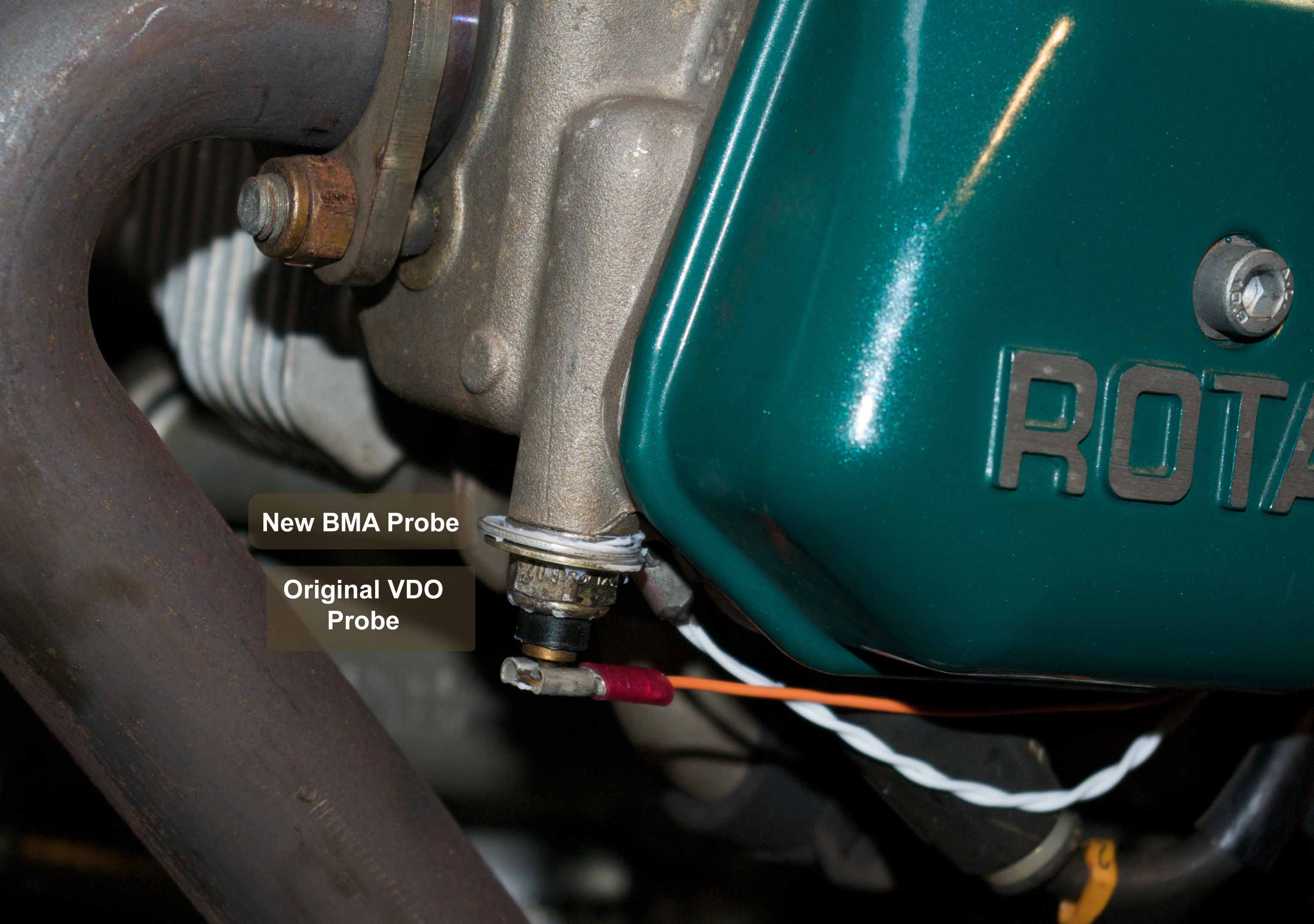

I finally completed my cylinder head temp monitoring system so now
I have 3 sites of measurement: Regular Rotax VDO probes into
the heads of Cylinders 2, 3 going to an analog gauge;
Ring-type CHTs installed under the Rotax CHT probes and monitored by
my Blue Mountain EFIS, and finally the Lockwood/Rotax coolant temp
probe with a Blue Mountain probe going into the EFIS.
So far, I have only done cowl-off, static testing but the results are
interesting:
The coolant temp at 4000 rpm is 20F higher than the Rotax/VDO
which is about 20F higher than the ring probes outside the block.
These will probably change when cowled and at cruise and climb which
I plan to test when I return from SnF.
Ira N224XS

PostPosted: Thu Apr 10, 2008 4:02 am    Post subject: Re: CHTs everywhere Reply with quote
Hi Kingsley,
Be a former quant, yes, I love calibration! In situ the probes all read equal
when the engine is cold.
Hi Jos,
It would be very interesting to compare the ring location I have vs the
spark plug site. I was advised by Kerry at Lockwood not to go there
because the relationship between temps there and the "official" site
were not known or at least documented. I am enclosing a pic of the
two probes installed. When using the VDO probes on 2,3 on my old
BMA EFIS, there was usually a 20F delta between front and back. The
shroud should certainly help but it is very expensive. Homebrew anyone?
