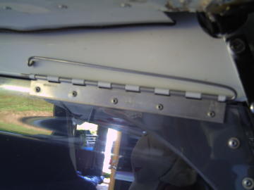

| Quote: | Sorry matt unsure on how to upload pics just made small files and attached
A couple of weeks ago I had a request for pictures of CH701 Bubble doors.
Attached small files of
safety pin type Hinge Doors remove each in ten sconds fit back on in
15secs.
Suction cup door holder has split pin to replace sucker.
Pic of door open
Also door catch lockable.
Thanks Graemecns
