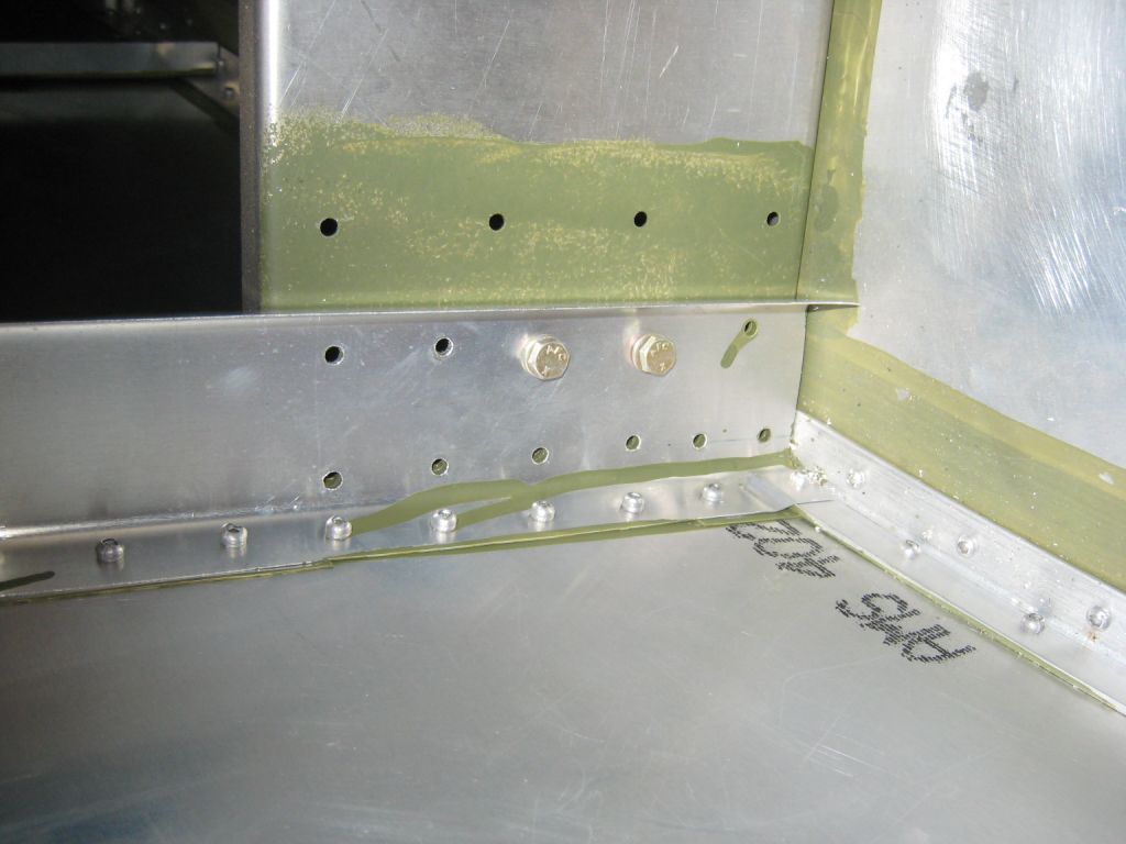

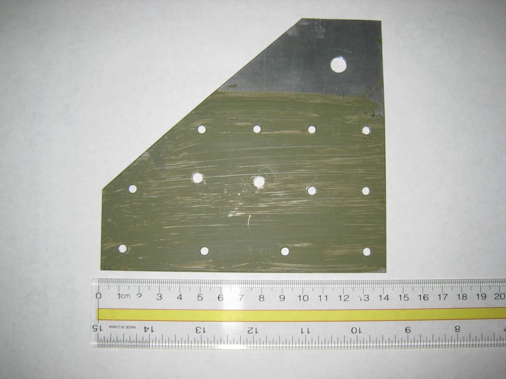

The attached pictures shows what 6B5-2 and 6B5-4 (copilot side) look like in
my QBK.
-- Craig

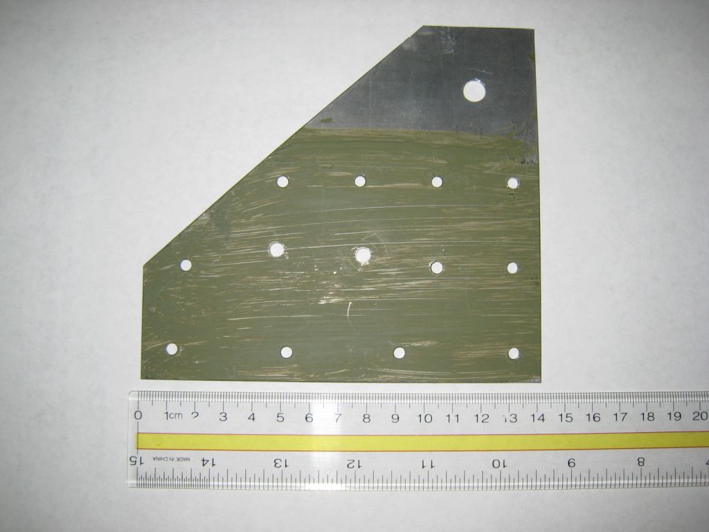

<?xml:namespace prefix="v" /><?xml:namespace prefix="o" /><![endif]--> [img]cid:001901c8a025$33aeffc0$097CFD50(at)zodiac[/img][img]cid:001a01c8a025$33b170c0$097CFD50(at)zodiac[/img] Photo E-mail [url=http://photos.msn.com/Viewing/Album.aspx?PST=8nK2AN1B!1Lc0GYplxDieC*NYbahBn4!ToLA3Q7n0jGP3yZl4ObqRd8afmjN6sh4gw1Z1jtj70R!ofnk2DyDLQ%24%24]Play slideshow[/url] | [url=http://photos.msn.com/viewing/Photos.aspx?pi_Type=SlideshowTask&Task=Download&stppData=&pi_ImagesOnly=1&Folder=nBuRgwTGIGi58ip8u*T7nT31*h6b!CiQalLvepI4dEs%24&User=A2WedJaYKoiDxwoUejv1CqZYhnCWKIT3&pi_NoLogin=1]Download images [/url] Tim,
I think what you are looking for starts on page 6-B-11C-page 4, and 6-B-16A-page 2. Your part numbers are different than mine, so I'm not sure which channel you want to trim. If the plans tell you to trim 6B5-4, then you should trim it. The plans always take precedent over the photo guide. I laid out the holes in the attach plate as shown on the plans and everything fit just fine.
Herb
