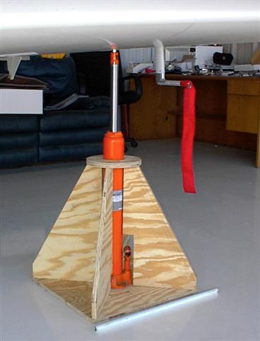

I see a couple of potential problems with your design.
(1) Standard aircraft jacks have mechanical locks and don't depend on hydraulics to hold in place after the lift.
(2) The lift appears to be made and supported only on the steel bolt into aluminum threads; on our QB wings there was a .100 gap between the skin and the bottom of the fixture; the choice was enlarge the hole in the skin or use a block of wood suitably padded with baffling material against the spar. We chose a block aligned along the main spar. BTW, the jack pads that Van supplies should be trashed. They are made of nylon and would engage at most four threads. How Vans can supply a short nylon fitting to support a 100K+ machine amazes me.
(3) wood will become dry and brittle over time and should be checked regularly.

Being a sort of cheap frugal type I made these stands out of $12 worth of ¾ plywood and 2 long rams from Harbor Freight on sale.
Seems to work OK. (base is 18” square.)
Albert Gardner

The comments directed toward my wooden base design jackstand (photo attached) are all valid.
Mechanical locks seemed unnecessary because the only use so far has been to lift the mains just clear of the surface in order to align the wheel pants. I also changed a tire once but immediately placed blocks under the axle. The plane is supported entirely with the bolt which screws in about an inch and a half. On the other hand that’s the same amount the tie-down ring screws in also. I don’t think I’d use this design if I was going to go into the jackstand business but it did seem adequate for personal use and cost about $90 for a pair using Harbor Freight rams. In some ways it’s better than the commercial designs I looked at because the bolt screws into the tiedown ring support and goes into a hole in the top of the ram so it can’t slip off unlike some expensive designs I’ve see in use. “NOTICE: DON’T TOUCH THE PLANE-IT’S ON JACKS!”

Our aircraft at work require mechanical locks be set any time we walk away from the jacks. 1 minute, 1 hour, 1 day. When a jack lifting mechanism fails the lock is the last line of protection. The mechanical lock is a safety feature and our employer tells the FAA that “Safety is #1”.
The instructions and procedures for Jacking an Aircraft are just like doing a preflight run-up. The design of the equipment can be simple, the cost of construction inexpensive. The result, now that is important when it’s my invested capital. YMMV.
