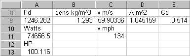

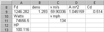

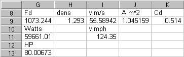

I chose to work the numbers to get an approximation of the cruise performance of 100hp vs 80hp engines.
The Cd x A product was chosen to equal the Zenith website results for 100hp. If 100hp yields 134mph, then
80hp would achieve 124.35mph. This will at least get you in the ballpark. There are so many variables, that it is difficult to
get exact figures.
The Cd x A product would be greater at reduced velocity due to increased angle of attack. The wing lift is greater at reduced velocity
due to the lift vector angle deviating more aft of the normal force. The thrust vector angle also deviates slightly.
The weight of the 80hp engine would be (you would think) lower though.

That's an interesting equation. Do you have more info on it. Reminds me of the rule of thumb, 25% more power to go 10% faster.

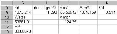

jim.lanier(at)charter.net
PostPosted: Fri Apr 04, 2008 12:10 pm    Post subject: Zodiac XL Cruise Speed with 80HP Reply with quote
Hi Andy,
Sure. Here it is...
Fd = (1/2)(dens)(v^2)(A)(Cd)
Pwr = (Fd)(v) or Pwr = (1/2)(dens)(v^3)(A)(Cd)
dens = 1.293 kg/m^3 at 0°C and 1 atmosphere
Fd = drag force in Newtons (kg m/sec^2) (Isaac and I go way back..we used to go to different schools together Smile )
v = velocity m/s
A = cross sectional area in m^2
Cd = drag coefficient
Pwr = power in watts (kg m^2/sec^3)
[img]cid:part1.02060307.01030401(at)charter.net[/img]
[img]cid:part2.07080208.03080203(at)charter.net[/img]
I don't know what Cd is (or A for that matter), but they are a product in the formula. So although they may both be wrong, their product is OK.
You could say that this is a normalized solution.
Note: You can convert the drag and power formulas to Engish units if you want, but I prefer to do everything in metric and convert afterwards. Note in the spreadsheet examples above
that I converted Watts to HP after the equation was resolved.
Jim

I don't know what is wrong with the calculatinos, but something would have to be. If all the power were used to offset parasitic drag, then the drag increases with the square of velocity. The ratio of velocities would then be the square root of the ratio of power, or (at)sqrt(80/100), using quattro pro, which is roughly89.44%, resuting in an 80 hp velocity of 119.85 mph if the 100 hp velocity were 134 mph. The other main component of drag, induced drag, decreases with increased velocity but is small at velocities significantly above stall speed, so the actual 80 hp cruise speed would likely be a little less than 119 mph.

Hi Andy,
Sure. Here it is...
dens = 1.293 kg/m^3 at 0?C and 1 atmosphere
v = velocity m/s
Jim
get exact figures.
[img]cid:part1.06000300.04080300(at)charter.net[/img]
[img]cid:part2.01090109.07030905(at)charter.net[/img]
Jim
