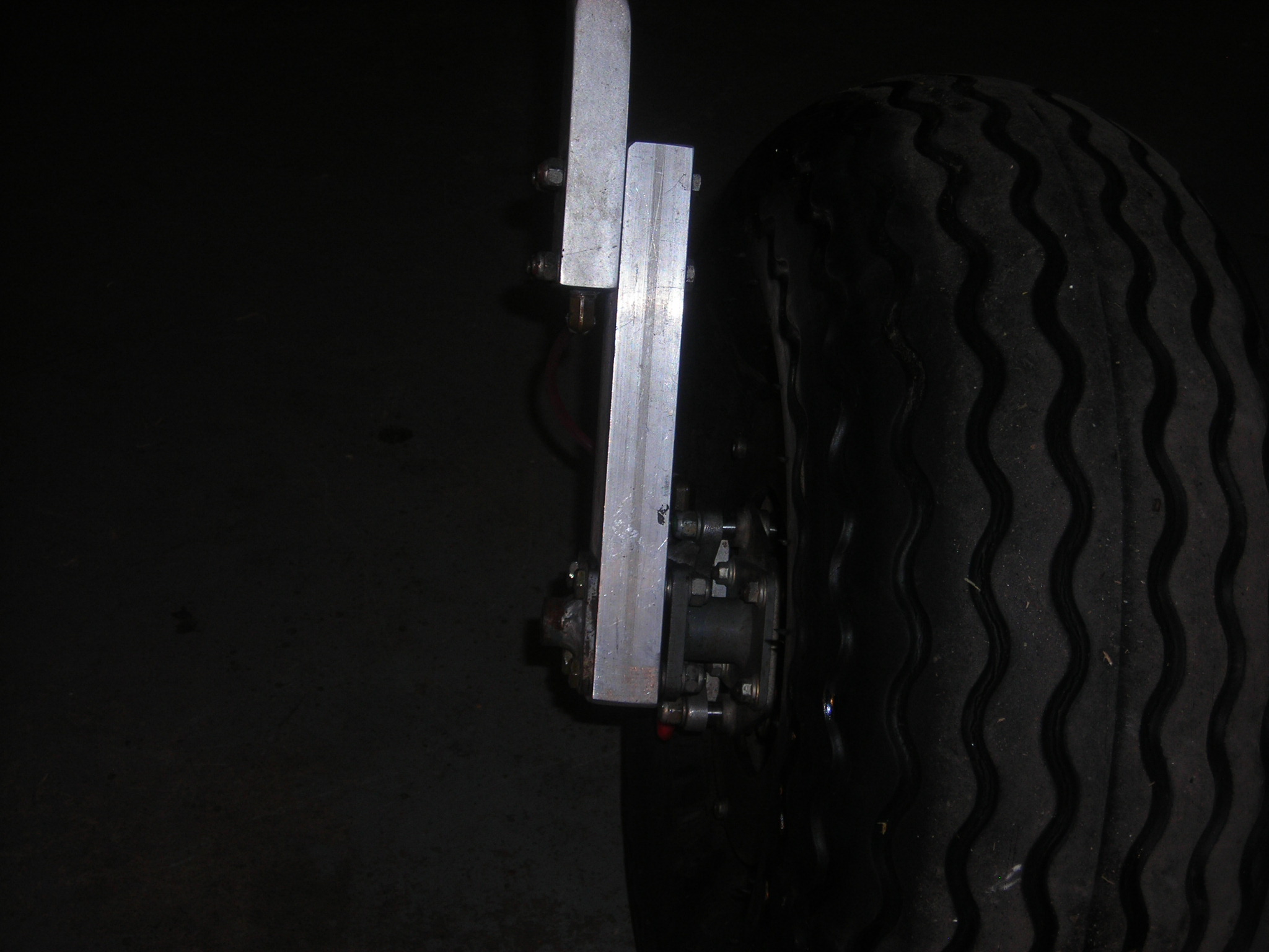

I finally got a chance to extend vertically my Grove gear by 6". I did so in order to have a better angle of attack for take off and landing, as the airplane would want to fly before the gear geometry would allow it to, similarly, the tail would always bang on before the wing was done flying. The change does make a difference. I can not tell you exactly how much, as it's been fairly windy, but, I can definitely get the nose up higher without hitting the tail. I do need to change my sight picture, as I have the tendency to hold the "old" angle so I don't slam the tail. I'm thinking that I can see (remembering that IAS is inaccurate at high angles of attach) about 5mph slower at touch down. Take off is also sooner, as the geometry will allow for lift off at slower speed.
The mod was quite simple, I just bolted a 3/4" piece of aluminum block to the axle holes. The same brake lines could be used.
larry

Curious. The short field takeoff procedure that I was taught involved lots of forward stick to get the tail up as soon as possible. The idea being to minimize drag and maximize acceleration. I take it that you do it differently?
Also, on my Kitfox the AOA on the ground is about the same as power off stall when flaps are deployed. Thus, I too would bang the tail with flaps up. However, with flaps deployed, it stalls right into a three point landing. I take it that your kitfox behaved differently? Any idea what might cause the difference?

I don't think that a single short field technique works on all airplanes. The Avid definitely takes off much shorter in a 3 point attitude. The nominal angle that the wing sat at was 10 degrees while in the 3 point. It now sits about 3 degrees higher. Bringing the tail up would reduce the angle of attach and therefore you would need more forward speed to develop the required to lift off. Ideally, a wing sitting in the 3 point should be at the stall angle of attack or higher so that you could bring the tail up. But, my experience in the Avid is that the take off run is the shortest with 3 point and full flaps. As far as landing, its the same thing in reverse. I don't know what the critical angle of attach officially is, but its more than 13 degrees. Try flying as slow as possible (at altitude). You will probably find full power nose way up 30+ degrees. Obviously, we can't safely land this way, but somewhere around there would be the slowest touchdown speed. Perhaps your tail is not effective enough to get the wing to the critical angle of attack without power, or even with power. I know mine wasn't. I did increase the tail surface and add VGs to the underside. I still have less effectiveness than I would like to see. Power on helps a lot to keep the air flowing over the elevator and is a noticeable difference. The wing wants to fly so much that to experience some of this, you have to get up early. That is while there is no wind or day time heating. The perfect clam of pre-dawn - I love it. Anyway, that's my 2 cents.........

look at my videos on youtube, and you will see what Larry it talking about. I raise my tail on start of roll and then after 75 feet I hammer the taildown and it takes a few feet before I get the wings flying. I have mentioned and asked this forum about lengthening the main gear before and not much talk on it. GladLarry finally got it done with favourabel results. I would like to make a new set of gear higher by 6 to 10 " and get the higher AOA to cut Take off roll further .
Just watch this and tell me how yours compares http://www.youtube.com/watch?v=itqyBYxU0lU
