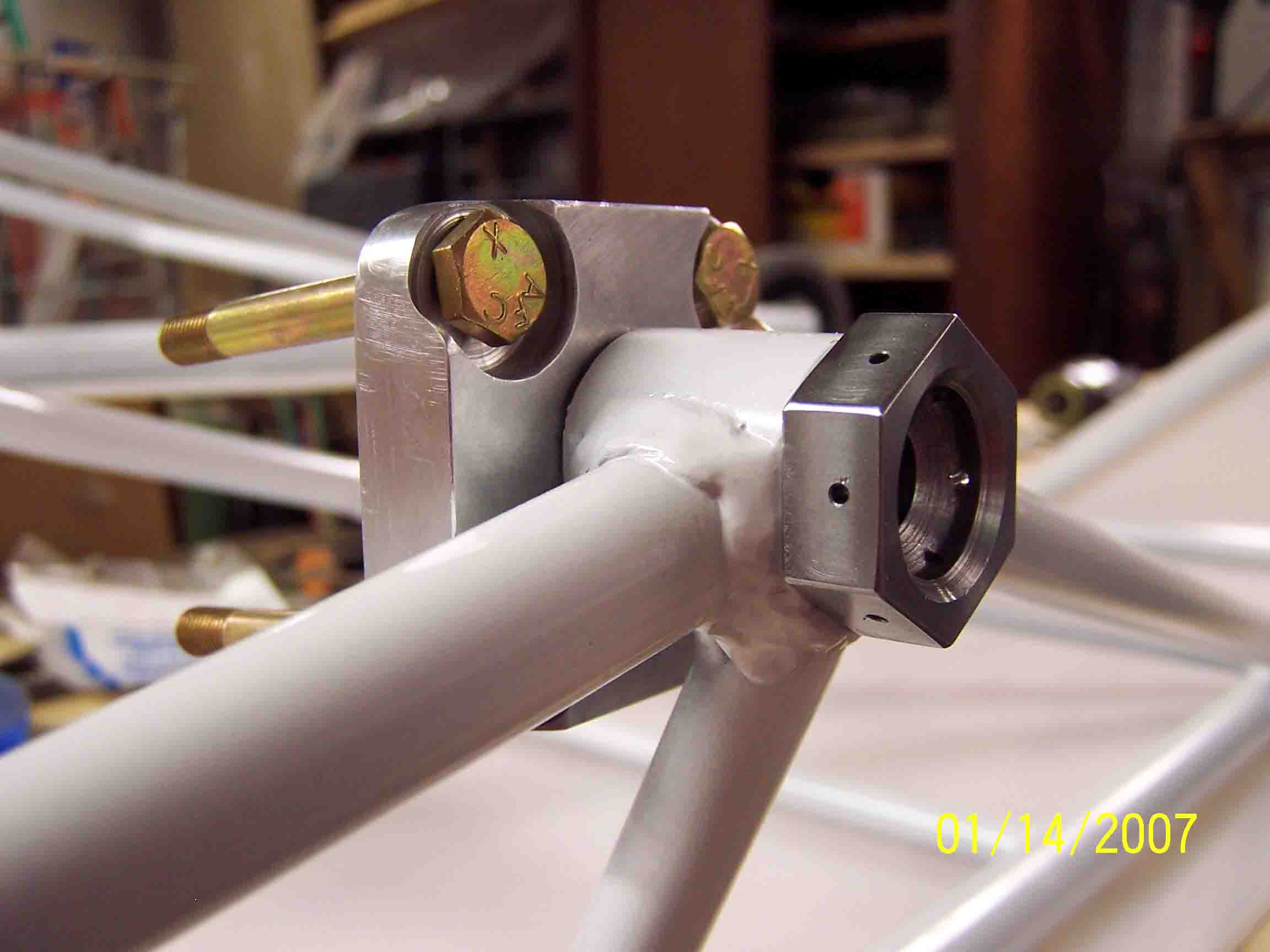

I built mine from round 4130 tubing. Tires are 16" OD, penetrate 2",
but I would make that less next time.
My inner mounts are pictured below, with some of the hardware shown.
I'm looking for pics of outer "axle."
The square aluminum block is bolted to the inner surface of the Grove
gear, and I added a zerk fitting to the ski at the bearing area. The
1/2" outer axle slides into the Grove axle.

_________________ Lynn
Kitfox IV-Jabiru 2200
N369LM |

http://www.matronics.com/Navigator?Kitfox-List_-
============================================================ _-
forums.matronics.com_-
contribution_-
N369LM |

| Quote: | From: Lynn Matteson [lynnmatt(at)jps.net]
With this arrangement, there is no part of the shoe that will try to
undercut the snow and cause drag. This is what I fight now with shoe
area right behind the tire.

| Quote: | From: lynnmatt(at)jps.net
Subject: Re: Kitfox-List: skis
Date: Tue, 25 Mar 2008 13:50:19 -0400
--> Kitfox-List message posted by: Lynn Matteson <lynnmatt(at)jps.net>
I get so much drag with the tires poking through as far as they do,
and if I was to reduce that penetration to 1" instead of 2", I could
close up the hole that the tire protrudes through. Or, another school
of thought is to make the skis hydraulically operated, and instead of
a hole in the shoe for tire protrusion, make a notch like I have seen
on other skis, where the tire fits into a notch. Then the ski is
kinda "L" shaped, with the wide part of the ski out front like the
bottom of the "L", and the tire fitting into the notch which is the
included angle between the bottom of the "L" and the vertical part.
area right behind the tire. I've seen this type of ski in pictures,
and I've surmised that it could be built as a rigid setup, or
possibly as a hydraulically-actuated lowering ski, that would take
the tire drag right out of the picture.
As a sport Pilot, I might not be able to get away with any form of
"repositionable" landing arrangement, however the FAA has approved
repositionable wheels for a couple of models of LSA water-landing
crafts, so the door has been opened.
I think it would be fun to try and make them out of aluminum sheet,
formed and riveted into a structural shape, then apply the nylon/
plastic/UHMW material on the bottom as a means to keep the shoe from
freezing/sticking to the surface.
I've seen pictures of Deke's, and his (no wheels) work well up in his
"neck of the woods" where they get more snow than down south here,
and it probably stays around longer. Down south here...160-some
miles...the snow comes and goes all winter long. Deke might even be
subjected to more lake effects snow, being close to Lake Huron. I am
lower mid-state, and we kind of get what's left over from battering
both sides of the state with snow. So, due to the vagaries of our
snowfall, I need wheels on the plane all the time.
Just thinking out loud some of the reasons for building mine the way
I did/do.
Lynn Matteson
Grass Lake, Michigan
> penetrate 2",
> shown.

| Quote: | > From: Lynn Matteson [lynnmatt(at)jps.net]
Yep! Good thinking, Lynn! I haven't used my skis this winter
because the snow hasn't come ... before now. But my experience is
exctly the same as yours and your L-shape idea sounds very good to me.
