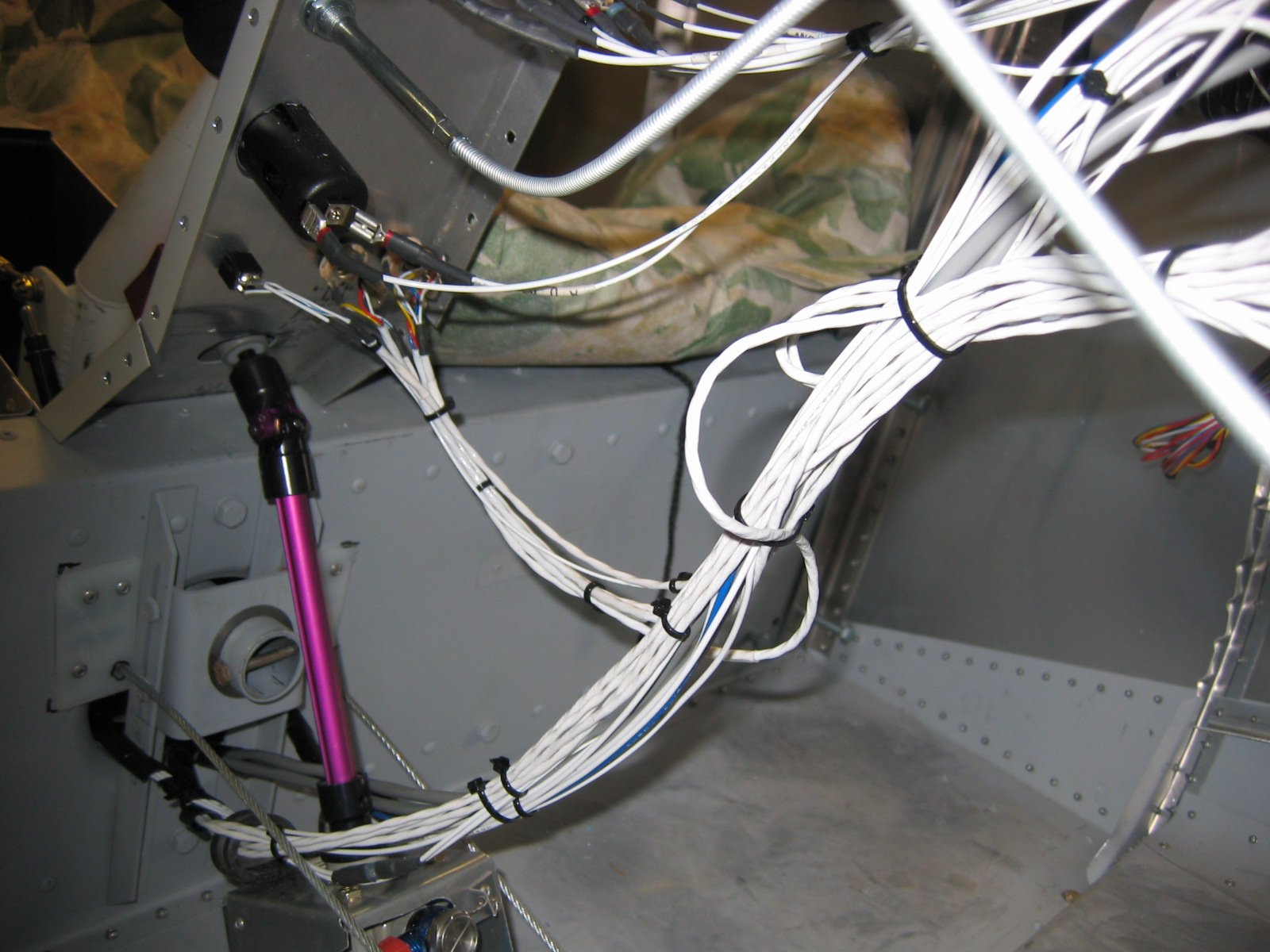

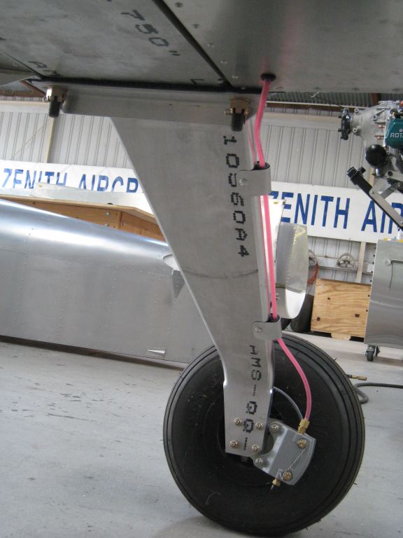

You asked some good questions that have been asked before. Search the archives where there has been a lot of discussion on each of the topics. I will give you my opinion and what I did. I am not flying yet so it is all still theory and subject to change given real world results.

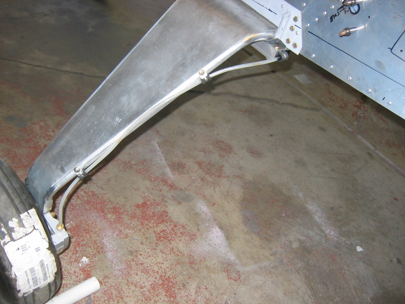

1. You can get wiring from the rear to the panel via three routes. Left armrail, right armrail and through the middle spar opening and center console. I used all three. I kept power items in the center and left the armrails for antennas. I attached a picture of the stuff going through the center spar.
2. I used adel clamps screwed to the rear of the gear leg. The ZAC demo plane used stick-on tabs and some of these have lifted off. I asked ZAC about routing out a channel down the rear of the gear leg to imbed the bake line and they advised against this. See picture attached for what I did.
3. Brake line routing. ZAC says to route through the middle spar opening and out the side skins at the gear leg. I did not think I would have enough room there so I ran them below the cockpit floor and back along the fuselage bottom. Now that I have done this, I don't like the looks of it and may change back. Again, see picture attached.

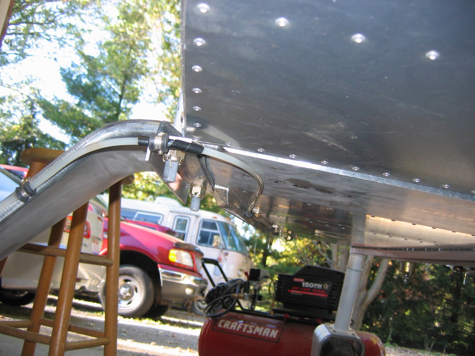

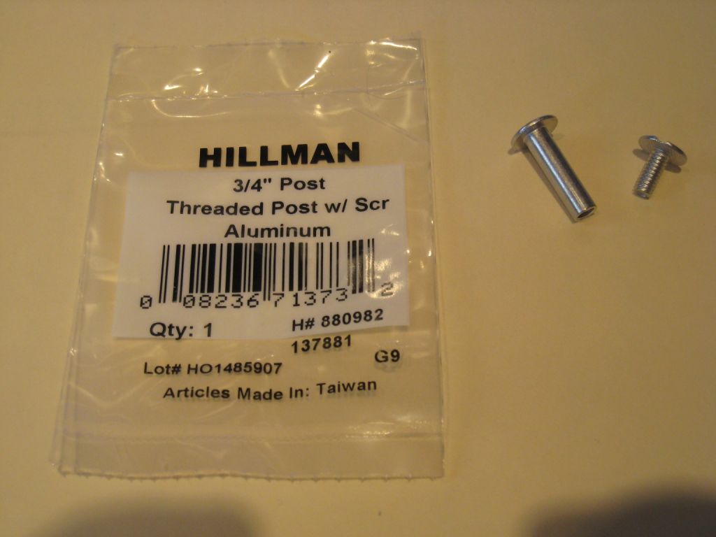

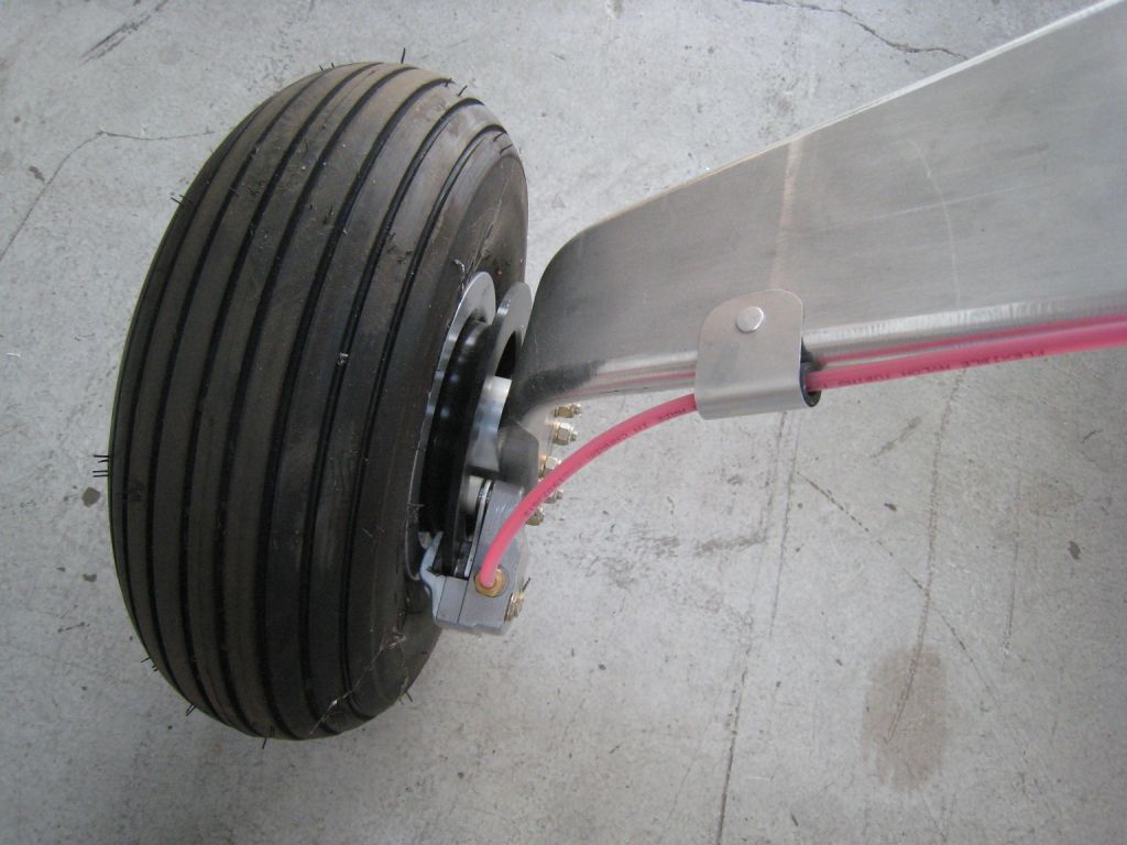

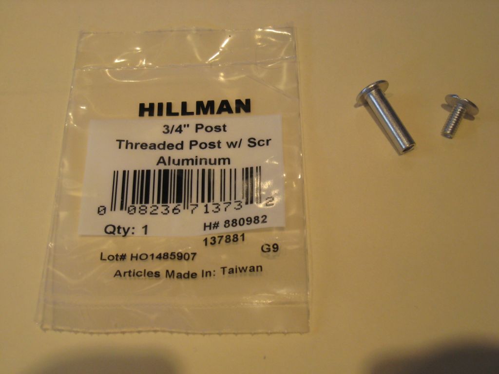

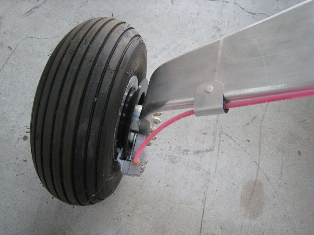

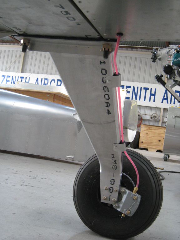

One "pretty" way to run the brake lines down the rear of the gear is shown
in the attached pictures. I don't know what the proper name for the special
"threaded post" nut and bolt shown is. Mine came from Lowes.
-- Craig

dan(at)hillsgun.com
PostPosted: Mon Mar 31, 2008 2:09 pm    Post subject: couple of questions Reply with quote
They are called Chicago screws, I don't know why, Dan.
Heatonhe36(at)msn.com
PostPosted: Mon Mar 31, 2008 4:16 pm    Post subject: couple of questions Reply with quote
<?xml:namespace prefix="v" /><?xml:namespace prefix="o" /><![endif]--> Craig,
Believe it or not, they are called "sex bolts".......Really.
Herb
craig(at)craigandjean.com
PostPosted: Mon Mar 31, 2008 4:45 pm    Post subject: couple of questions Reply with quote
You can also google “binder posts”. Apparently one of their intended purposes is to hold together stacks of three-hole punched paper without a three ring binder.
-- Craig

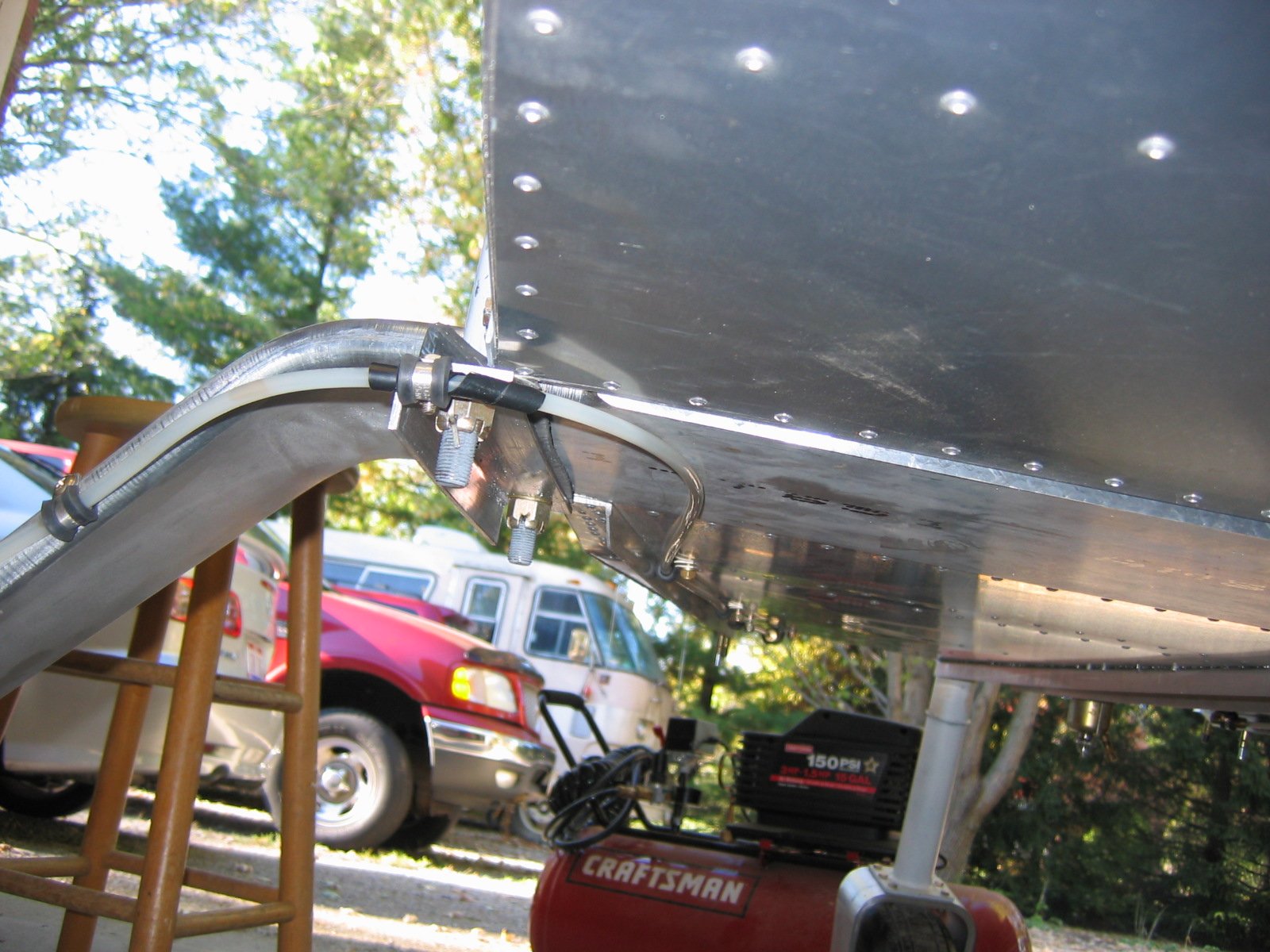

PostPosted: Mon Mar 31, 2008 6:32 pm    Post subject: couple of questions Reply with quote
Hi Bob,
Here is my solution for the brake line routing on the landing gear. It is a small fairing I made that includes little brackets which hold the brake line in place. I routed the lines along the cabin bottom from the front to the area you see in the picture and held it in place with a couple of standard clamps.
Paul
PostPosted: Mon Mar 31, 2008 7:55 pm    Post subject: couple of questions Reply with quote
O.K. to drill holes in the main part of the gear leg? Cessna uses clips. John
Well the pictures I posted were of a plane being built at Michael Heintz’s Quality Sport Planes. I know of two others built there with the same approach. My belief is that the gear is the most robust (over designed?) part of an XL.
-- Craig

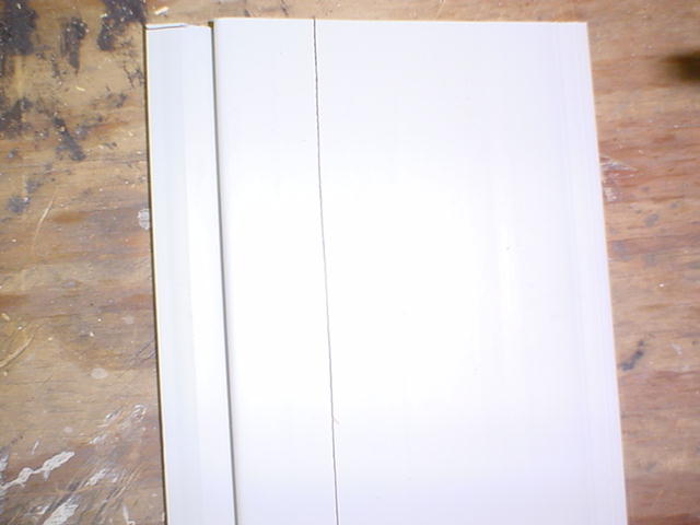

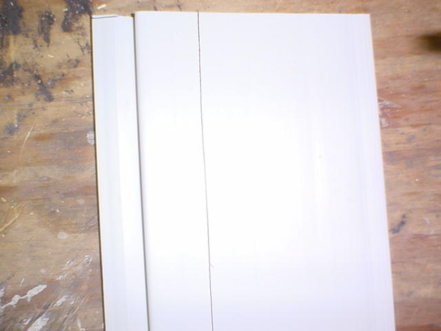

PostPosted: Wed Apr 02, 2008 11:42 am    Post subject: couple of questions Reply with quote
The brake lines can be streamlined and nicely hidden beneath a piece of
vinyl gutter guard that is cut down and attached
with Gorrilla Glue to the rear of the gear legs providing a nice channel to
run the lines.
If the attached pic does not come thru check this site
http://picasaweb.google.com/Papawobo

Gig Giacona
Posts: 1416
PostPosted: Wed Apr 02, 2008 12:03 pm    Post subject: Re: couple of questions Reply with quote
That may well be the best way to do that I've seen.
Good work Gary.
