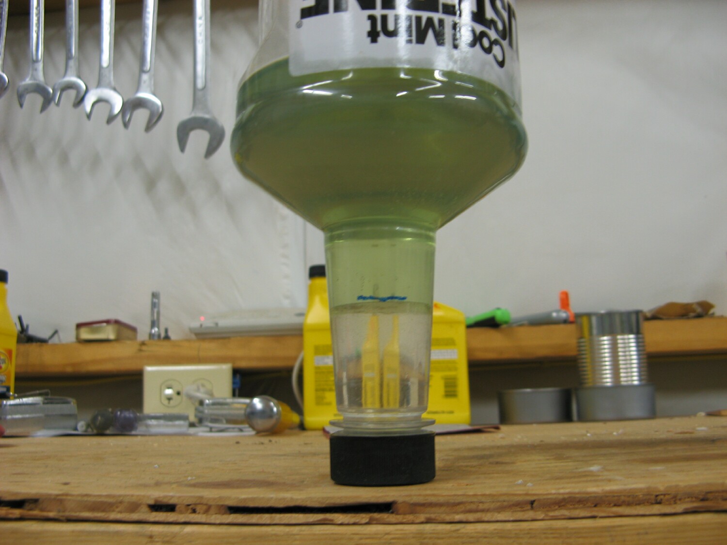

Wash it out with water.
<![if !supportLists]>· <![endif]>In a 20 gal plastic/steel barrel put about a gallon of water (steel is better it can be grounded).
<![if !supportLists]>· <![endif]>Add ten or twelve gallons of gas.
<![if !supportLists]>· <![endif]>Stir well.
<![if !supportLists]>· <![endif]>Let stand twenty minutes to be sure all the water has settled out.
<![if !supportLists]>· <![endif]>Siphon the gas off the top of the barrel into a suitable container through a Mr. Funnel or a chamois/felt to fuel your plane.
Doing this will also remove any dust or other particulate that may be in the gas. The remaining gas will be a few octane rating points lower than the original gas so try a small quantity in your engine first to make sure the engine doesn’t ping especially on takeoff. The water you drain off is very corrosive but bio degradable... don’t use it on your lawn or flowers. Unless you want your grass to come up half cut. J
You can put a drain in the bottom of the barrel (would have to be on a stand) to drain the water off before siphoning the gas. Down side is treating gas at other strips. Dragging the barrel around can be a problem.
Ethanol really becomes problematic at concentrations of 10%. Lower if you leave gas in your plane. If you are out and have to use contaminated fuel for one afternoon I’ go ahead but only in relatively warm temperatures. On returning I ‘d drain my tank treat the fuel and put it back into the tank to dilute any contaminated fuel left in the tank.
If you premix your gas the ethanol won’t damage your tanks but the chances of phase separation, where the eth, water and oil separate from the gas, is higher. When that happens to mixed gas there is a heavy white-grey sludge that won’t burn that will appear in your fuel system. To add insult to sludge the gas floating on top of the sludge is perfectly good to use.

5
6
7
8
9
 Filesize:  7.29 KB
 Viewed:  12937 Time(s)

PostPosted: Thu Mar 27, 2008 7:20 pm    Post subject: Gasoline Question? Reply with quote
This brings up another question, do pumps have to have a decal desclosing an Ethenol or Alcohol mixture? Jeff Classic IV KTZR
shinco(at)bright.net
PostPosted: Fri Mar 28, 2008 1:03 am    Post subject: Gasoline Question? Reply with quote
jeff puls wrote:
[quote] This brings up another question, do pumps have to have a decal
cpops(at)verizon.net
PostPosted: Fri Mar 28, 2008 6:16 am    Post subject: Gasoline Question? Reply with quote
do pumps have to have a decal       disclosing an Ethanol or Alcohol mixture?
Answer is NO! Except in certain states which have mandated this requirement.  It seems that MD and VA have not!

PostPosted: Fri Mar 28, 2008 8:46 am    Post subject: Gasoline Question? Reply with quote
Re E-10 auto gas
As I understand it, certain counties in Maryland (near DC and Baltimore) are
required to dispense ethanol blended auto gas in order to strive for better air
quality so the state can continue to receive federal transportation funding.
Counties outside of the requirement may still be able to dispense either.
So stations outside of the requirement area may or may not have ethanol blend.
Buyer beware.
I find that labelling indicating presence of ethanol may not be posted on the
pumps and I routinely test unless I happen to be able to talk with the station
manager. Do not trust the counter clerk to know, test it yourself if in doubt,
its easy.
I have noticed labelling showing up on some pumps in the Florida Keys, so
ethhanol blended fuel is reaching this area, despite the problems it creates
with boat engines and fuel systems. There may be more boats than cars in the
Keys and lots of snow birds who leave boats unused for months inviting
condensation and atmospheric moisture absorption into the fuel leading to
settleout. I would hate to run low on fuel out on the ocean beyond anchor
depth and switch to a tank that was loaded with settleout. Power boats turn
into "sail boats" and with prevailing winds out of the NE I might get to visit
Fidel and his buddies in Cuba.

PostPosted: Fri Mar 28, 2008 9:05 am    Post subject: Gasoline Question? Reply with quote
B. Jones, What method do you use to test gasoline for ethanol?

PostPosted: Fri Mar 28, 2008 7:29 pm    Post subject: Re: Gasoline Question? Reply with quote
[quote="patreilly43(at)hotmail.co"]B. Jones, What method do you use to test gasoline for ethanol?
Pat Reilly
Mod 3 rebuild
Rockford, IL
Pat, I use a half gallon clear mouth wash bottle. Put about an ounce of water in and mark the water level while the bottle sits upside down. Fill about half way up with fuel and shake it up then set it on its lid for a few minutes. any alochol will absorb the water and settle out with the water and be seen as a level above your line. The picture attached shows no alochol.
 Filesize:  206.92 KB
 Viewed:  636 Time(s)
Tom Jones
Classic IV
Ellensburg, WA
PostPosted: Fri Mar 28, 2008 7:49 pm    Post subject: Gasoline Question? Reply with quote
Tom, OK, That would be the method Noel explained to use on a bigger scale to "wash" alcohol out of gasoline and siphon the gas off the top or drain the water off the bottom.
Pat Reilly
