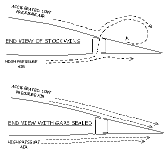

Gig Giacona
Posts: 1416
PostPosted: Mon Mar 31, 2008 10:35 am    Post subject: Re: To Hinge or not to Hinge Reply with quote
The folks that sell gap seals will be surprised to hear that. The stopping of airflow through the hinge is what those things do.
