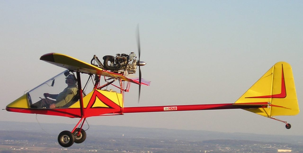

Here is a good in flight picture of my 72 inch IVO prop flex profile.

Prop tips in general should not flex much, the centrifugal force of rotation keeps most props straighter when running than when stopped. What kind of prop is that ???
Mike
Mike, I am not sure where you got your info on prop flex. The tips of an Ivo Prop flex forward in excess of an inch. Other props flex less. On a Kolb with an upswept boom this tends to increase clearance, However, it can dramatically decrease clearance to the back of the wing.
Steve B
