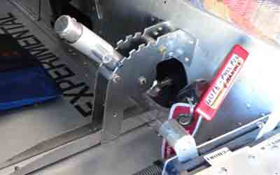

can anyone tell me where they put the ativation handle in there 701?

I put the BRS handle where I could easily install it and reach it quickly.
It is at the bottom front of my seat near the flap handle. Since I also have
a throttle quadrant in this area, I made certain the handle is oriented
forward-aft and not cross-cockpit like the other controls. I also decided to
leave the safety pin in the BRS handle since it can be removed easily if I
have to deploy the chute. See pic attached.
