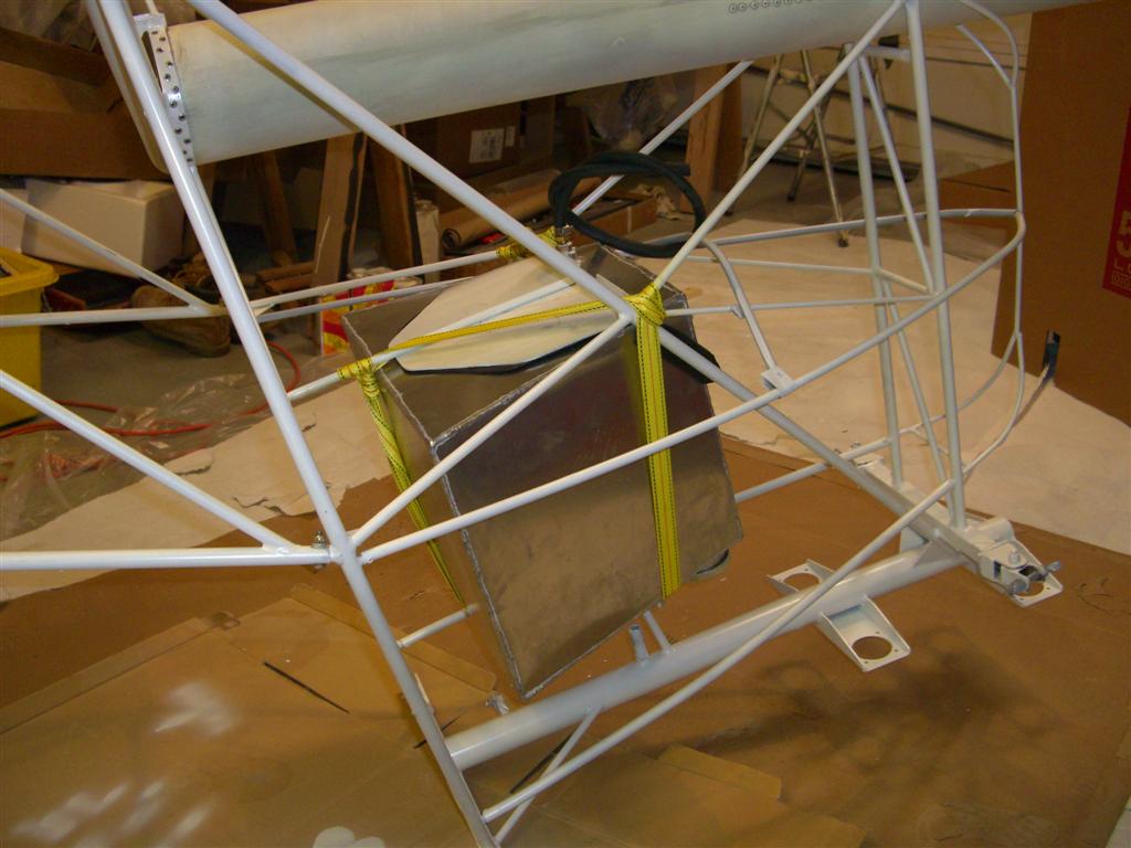

I just had an aluminum tank custom made for my Firestar by these guys.
http://www.alumiworx.com/cart/index.php?act=viewProd&productId=23
It was about $180 shipped for my 8 gallon tank. Prices will vary depending on options, size and shipping. I'm pretty happy with it but they left off the mounting tabs. I'm currently recovering my plane so I haven't filled it with fuel yet. I know it doesn't leak water.
I did make a cardboard tank first and that is a must. I found issues I didn't think of when drawing it out on paper.
