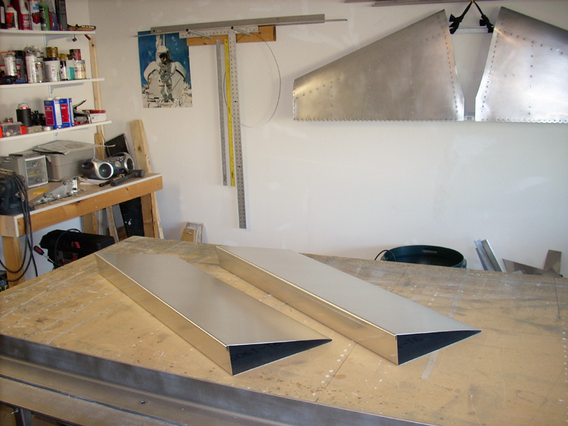

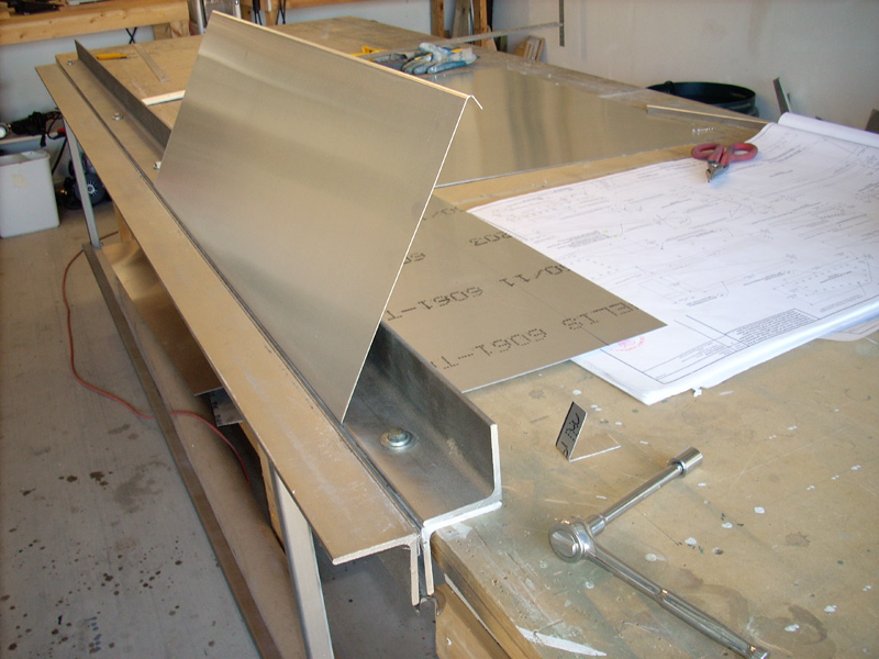

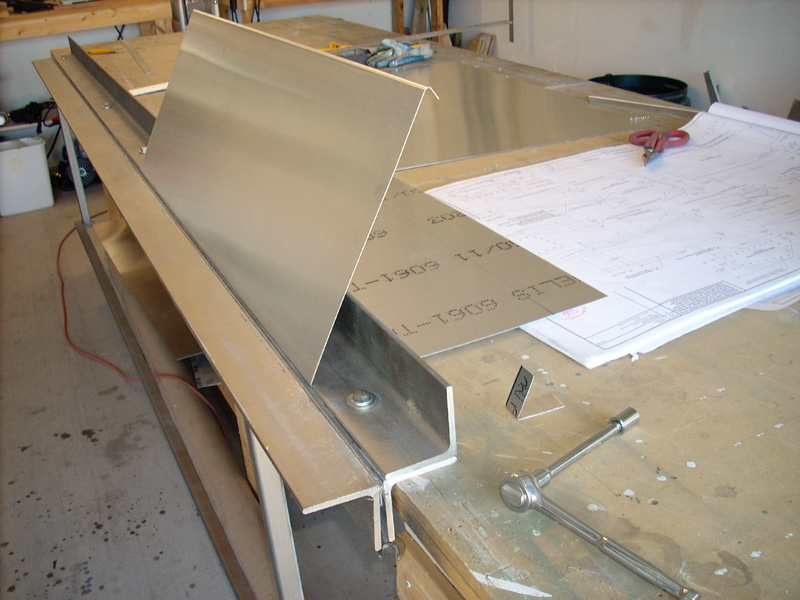

In order to make nice straight bends in thicker stock such as .040 you must have a good quality hinge. I used the stainless ones from Air Parts, Inc.
For your longerons you should make both flanges about 100mm then trim after bending. This is a minimal waste of material and is certainly cheaper than farming out the work.
I have bent every control surface skin, and every piece of channel (including rear spars) using a little creative thinking. For larger pieces, like control surface skins, I always do a test bend with a 2" wide strip of aluminum.
My current version of the brake is 10 feet long. I have 6 bolts. I can bend pretty much anything I need to bend with it.
Yes, I'm still here. I'm building a Sonex (long story). I'm also still a big fan of the 601XL.

Check out my 8' brake. I've bent 6' .040 on it. Extra clamps involved, but it didn't budge in
the clamp.
http://mykitlog.com/users/display_log.php?user=ashontz&project 77&category=0&log 7195&row=154

Thanks. I should draw up some plans for it and sell them. I liked Larry McFarland's brake, but I didn't have a milling machine or lathe at my disposal at the time, so I designed this one to be made with no more than simple hand tools and a bandsaw. I've beefed it up here and there as I've used it and found it's original design flaws and limitations. I can now bend pretty much anything I need on it now. If you go with the rear spar splice it's all you need for a 601HD, HDS, or XL. I think the materials came to about $350.
