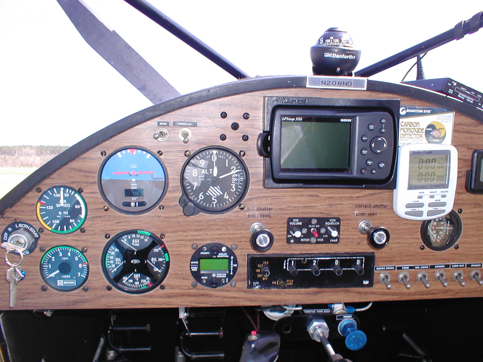

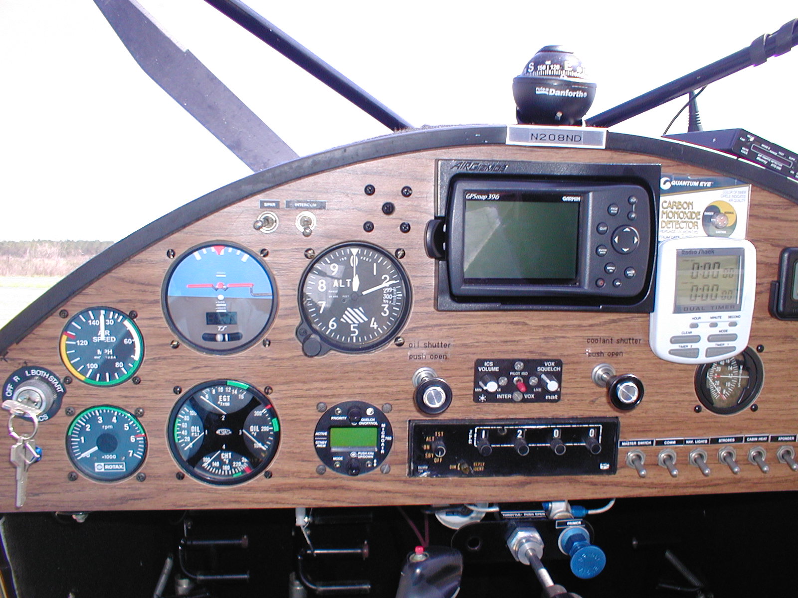

Oil thermostats can be good things.Make sure you purge your oil system after installation.I had the same problem on a Kitfox and have installed a set of shutters at the oil cooler which are operated from a control in the cockpit.It's a lot better than tape over the cooler but probably not as effective as the thermostat.
