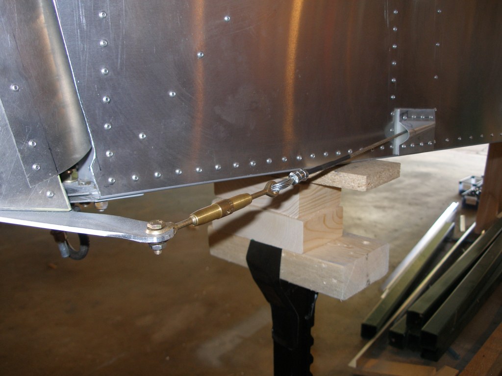

1. As I recall, the bottom of the cutout is aligned with the top of
the longeron.
2. The cable does angle downward a bit as it passes through the
fairlead but not by much. You could leave it parallel or angle it
slightly, it won't matter much.

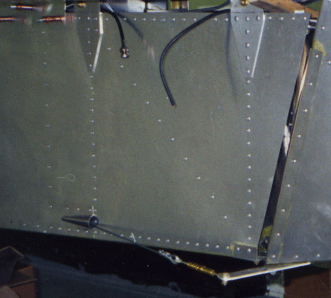

PostPosted: Sat Mar 22, 2008 4:39 am    Post subject: Rudder Cable Outlet Fairing issues Reply with quote
Larry,
Does this help?
Jay in Dallas

PostPosted: Sat Mar 22, 2008 6:52 am    Post subject: Rudder Cable Outlet Fairing issues Reply with quote
Sure does. Thanks.
