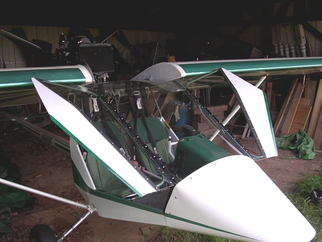

Dana, since they are clear lexan they are difficult to photograph
They are 1/8" and the same scratch resistant sheet that I used for
the windshield and the doors.
Remarkably I only had to buy one sheet for the whole plane.
They are glued with GOOP to the root ends and are very secure. You
can use them to lift the wings.
I remove the wings every year and they require a bit more care in
storage. The nose end of the wing
has to be elevated so the fence hangs free. I'm sure a long period
of weight would cause a permanent set.
They extend roughly 2"" all around but not quite to the very rear.
So far this season has been a non-starter, nursing an old dog back to
health, getting the flu myself.
Maybe next week I'll get started on the next modification.
BB

Hey Bob ,
Those Doors look mighty good !
