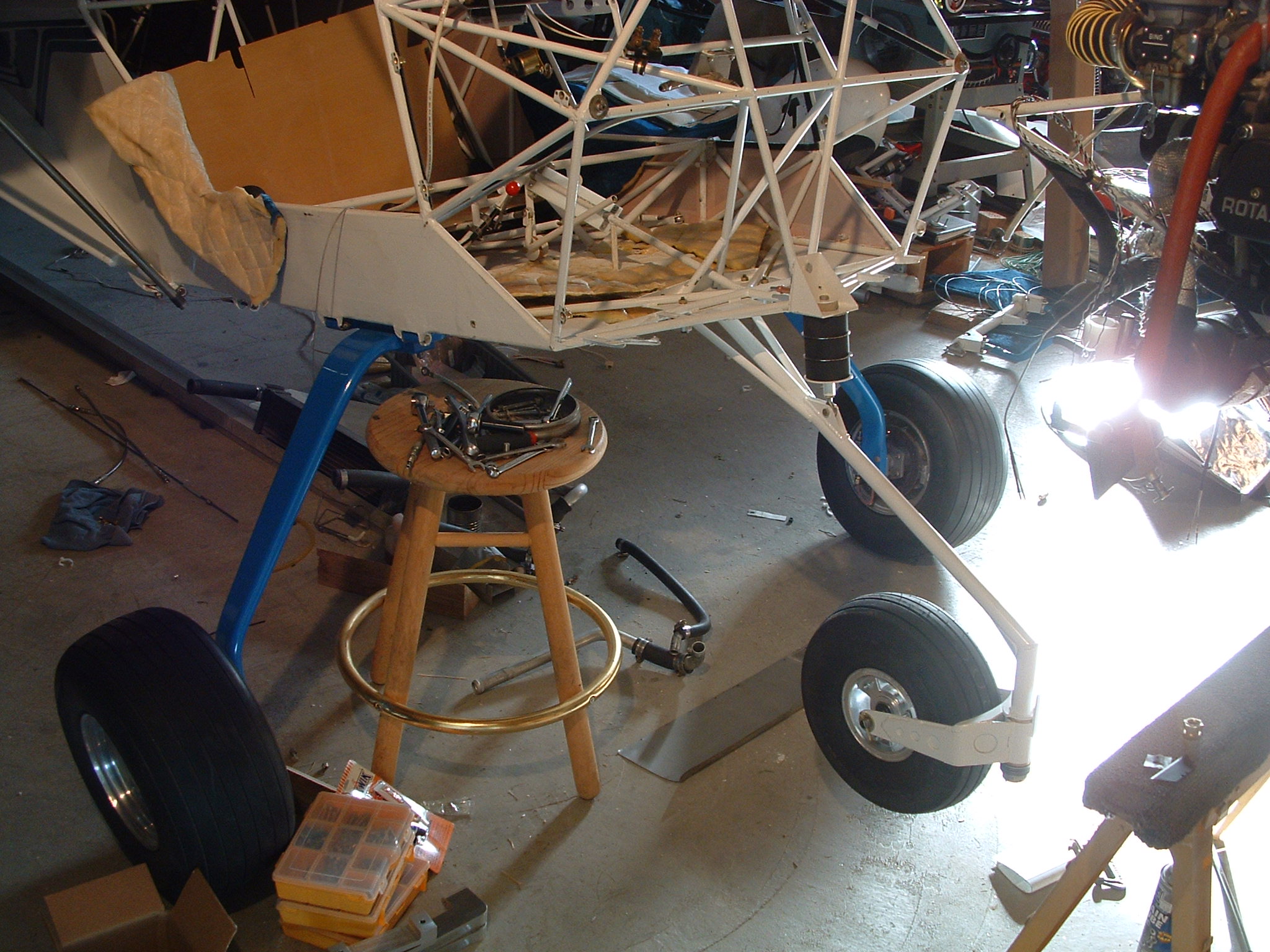

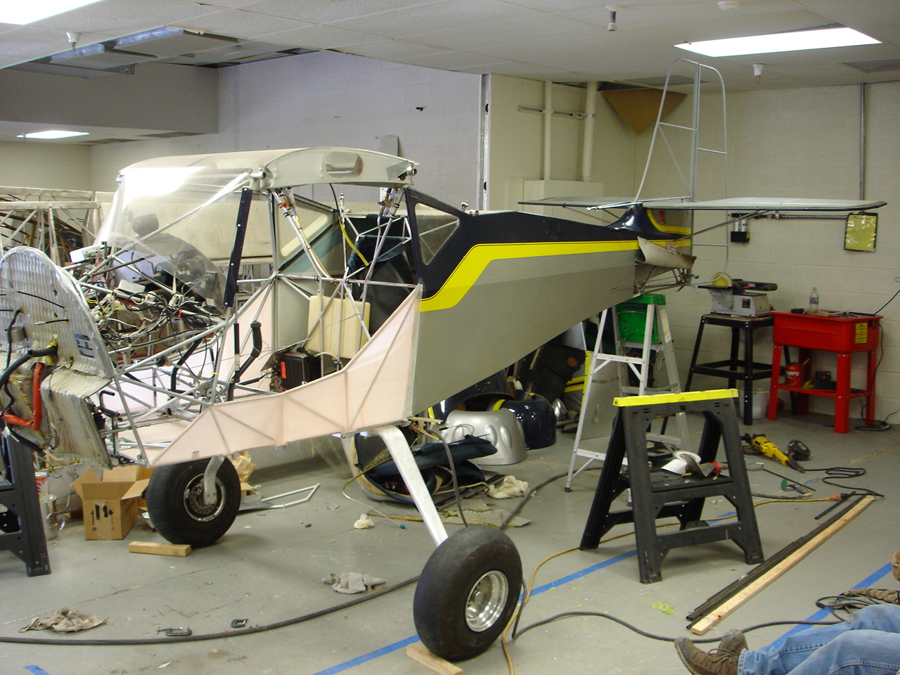

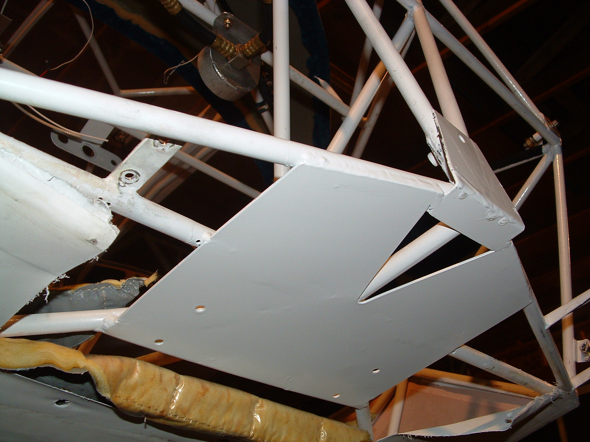

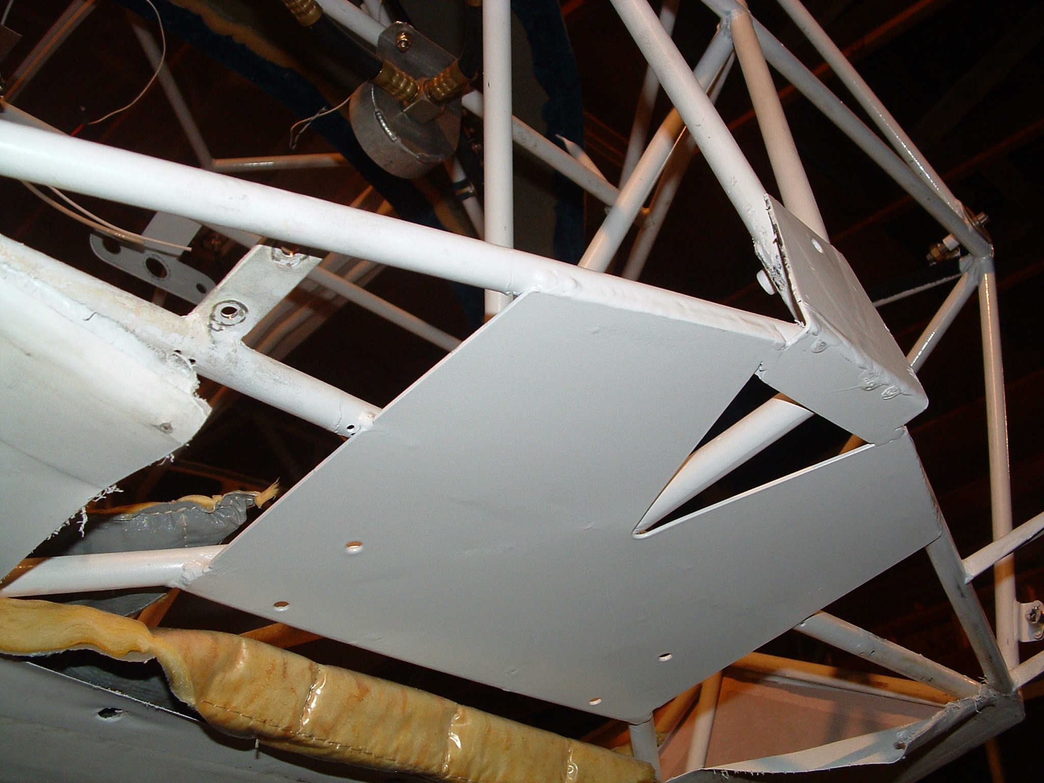

Jose,

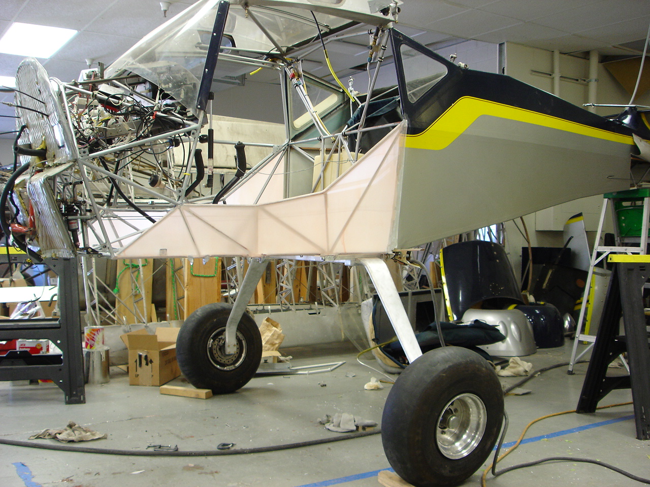

Here are some photos I have that may help. The grove gear should be attached to the rear clips on the airframe. It comes with attachment plates to attach it to those rear clips. If your airframe doesn't have rear clips, John McBean sells them. I purchased some from him just in case mine needed to be moved to a different location. They did not need to be moved.
McBean also sells the complete (wheel & tire included) nose wheel assembly which comes with detailed instructions of how to install. I purchased mine from him.

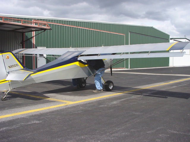

Also, note on photo #6 the addition of height to the vertical stabilizer and the addition of a Model IV rudder. This has really helped give good rudder authority which I found out after purchasing my Model I was one of the major problems that was addressed in later models and finally fixed in the model IV.
Please understand I am not a builder nor am I an engineer and I have no knowledge in airplane design. I just listen to others well. I hope this info is of help to you.
Started with this
 Filesize:  67.59 KB
 Viewed:  810 Time(s)
New main added in rear position

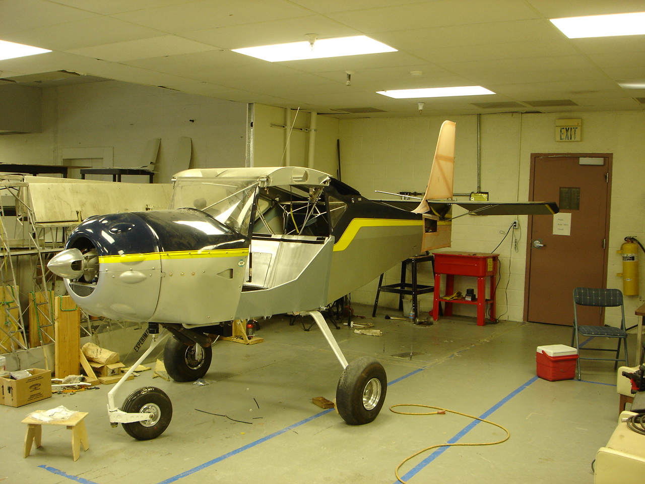

Brace plates for nosewheel
 Filesize:  596.14 KB
 Viewed:  854 Time(s)
Nosewheel installation
 Filesize:  613.63 KB
 Viewed:  725 Time(s)
 Filesize:  624.07 KB
 Viewed:  778 Time(s)

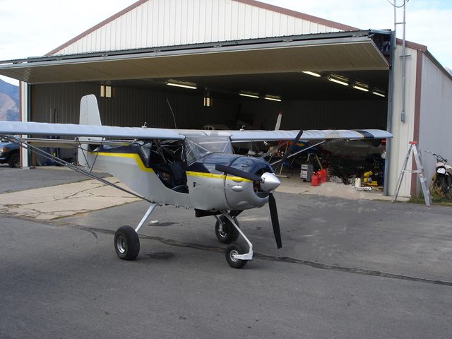

Nose wheel assembly attached
 Filesize:  513.95 KB
 Viewed:  774 Time(s)
Final Completion of Nose wheel addition
 Filesize:  266.98 KB
 Viewed:  1805 Time(s)

PostPosted: Sat Mar 15, 2008 1:55 pm    Post subject: Re: Tricycle Kitfox II-Reminder Reply with quote

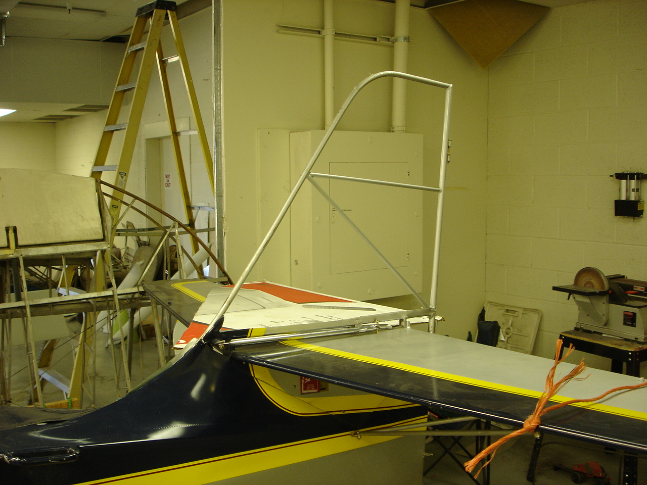

We raised the vertical stabilizer about 10". I purchased a new Model IV rudder from John McBean and then used cardboard from an old box to make a template of an existing vertical stabilizer from a model IV. The attached photo shows the "high quality" red and white template resting on the horizontal stabilizer. Not too scientific, but it worked. The key, of course, was to make the vertical stabilizer the same height as the new rudder was going to be and the same front to back width and design as the current model IV vertical stabilizers.
I did not do the work myself. I hired an A&P to do the work. As long as I was willing to keep the money coming, he was willing to cut and weld.
New Vertical Stabilizer Template

Steve:
I remember your plane on the Dan Denney brochures. Never thought it could look so beautiful as a tricycle.
After studying the pictures I still have a couple of questions. Do you have a picture showing the
Grove gear attached to the fuelage? Our model II fuselage has a clip right under the wing lift strut attachment which, in my opinion, is not as strong as the two clips that attach the traditional landing gear in the taildragger position. I would like to confirm that this is the rear clip that you mention.
Do you think that extending the rudder of your plane was a requirement of the conversion or just an enhancement? I owned this model II for ten years (1997-2007) and always thought the rudder authority was adequate (enough).

Jose,
Thanks. I kind of like the looks of it myself.
The rear clip position you refer to is where my new Grove gear is attached. My rear clips are the same as the front clips. When my plane was on floats, I think this is where the floats attach also. See attached photo of new main gear attachment.
I did the vertical stabilizer and rudder mods to try to bring my plane more up to date as long as I was doing the trigear mod. I guess I wouldn't consider this a required mod, but knowing that it has historically been an issue and very solvable, it just seemed like it should be done and the difference is VERY noticeable.

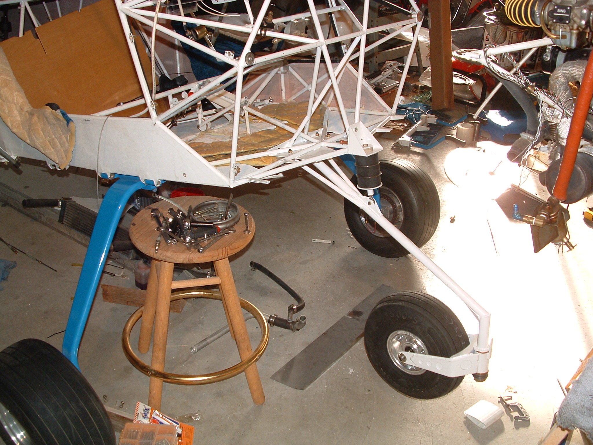

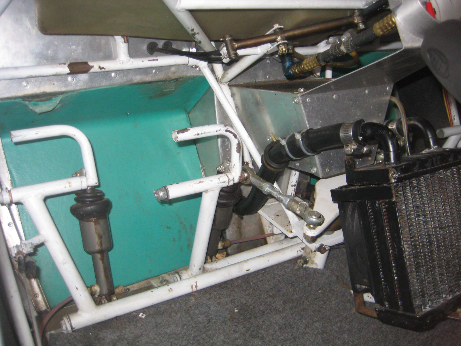

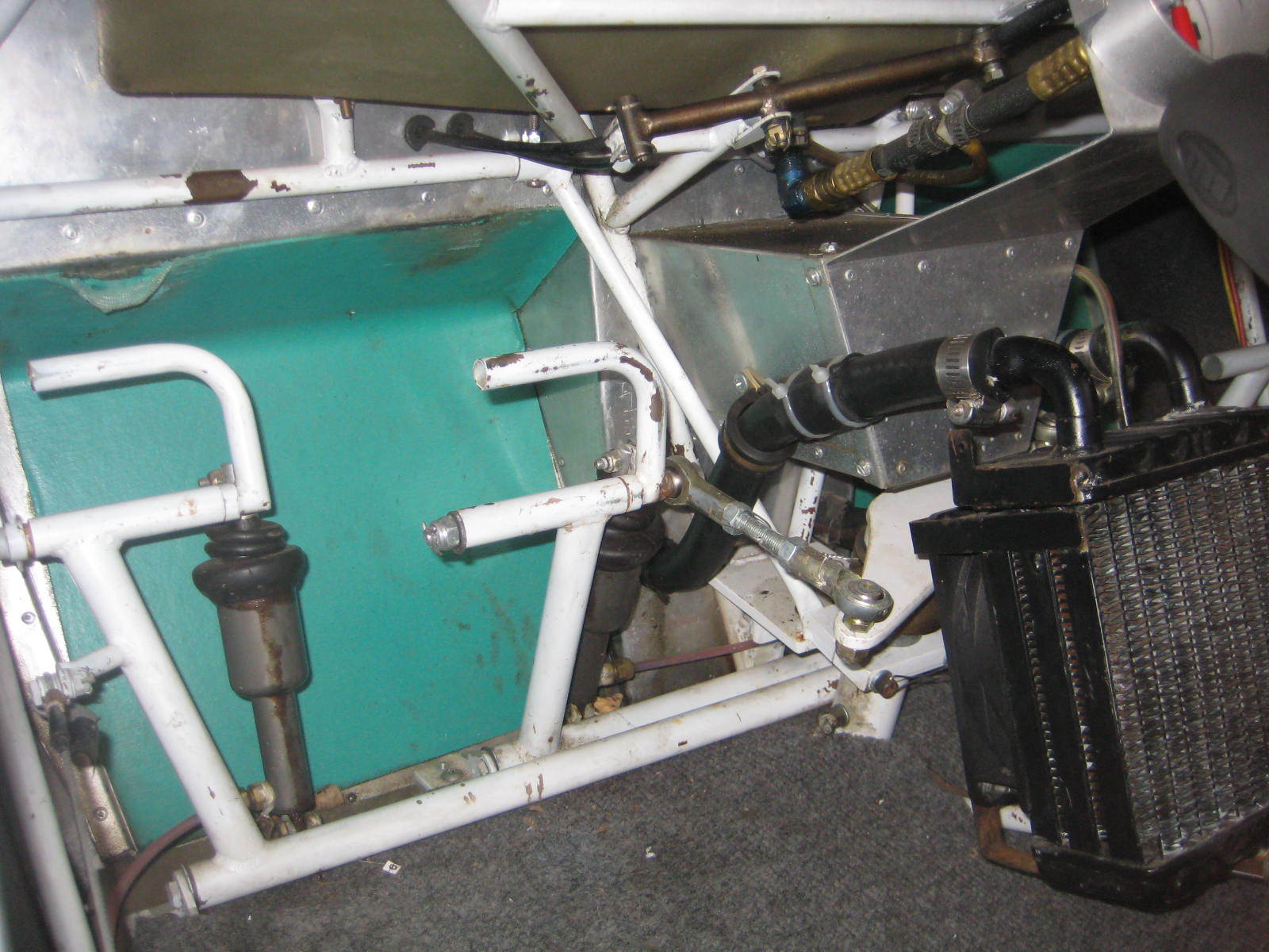

Jose, only got a inside pic

I'm curious now after looking at Steve's pictures. Is the nose gear mount bolt on, weld on, or both? Looks like where the mount attaches to the bottom of the fuselage is it bolted on, or at least the support tubes are bolted on. But also looks like the shock mount on the front of the frame is welded on to where the two cross braces come together.

Dave:
Thanks for the picture. Looks like a good alternative. I prefer the loose nosewheel system due to the simplicity of the installation, but the planes new owner prefer to have full steering. We may end copying your installation. Any additional picture showing details of the installation that you may send in the future will be valuable.
