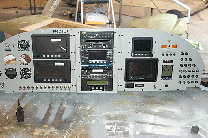

Chris, Stein built my panel using his three piece panel that is an inch or so taller. I have a PS engineering audio panel, DVD/Radio, 430, sl30, 327 and GRT EIS all in one stack. I agree with Jesse, no way I want to do any work from under the panel. I had to do some rewiring myself and even being able to pull the center section out a ways, it was still difficult. From under the panel it was impossible. If I remember right the SL30 is the deepest item…..center rib considerations.
Rene'
801-721-6080
