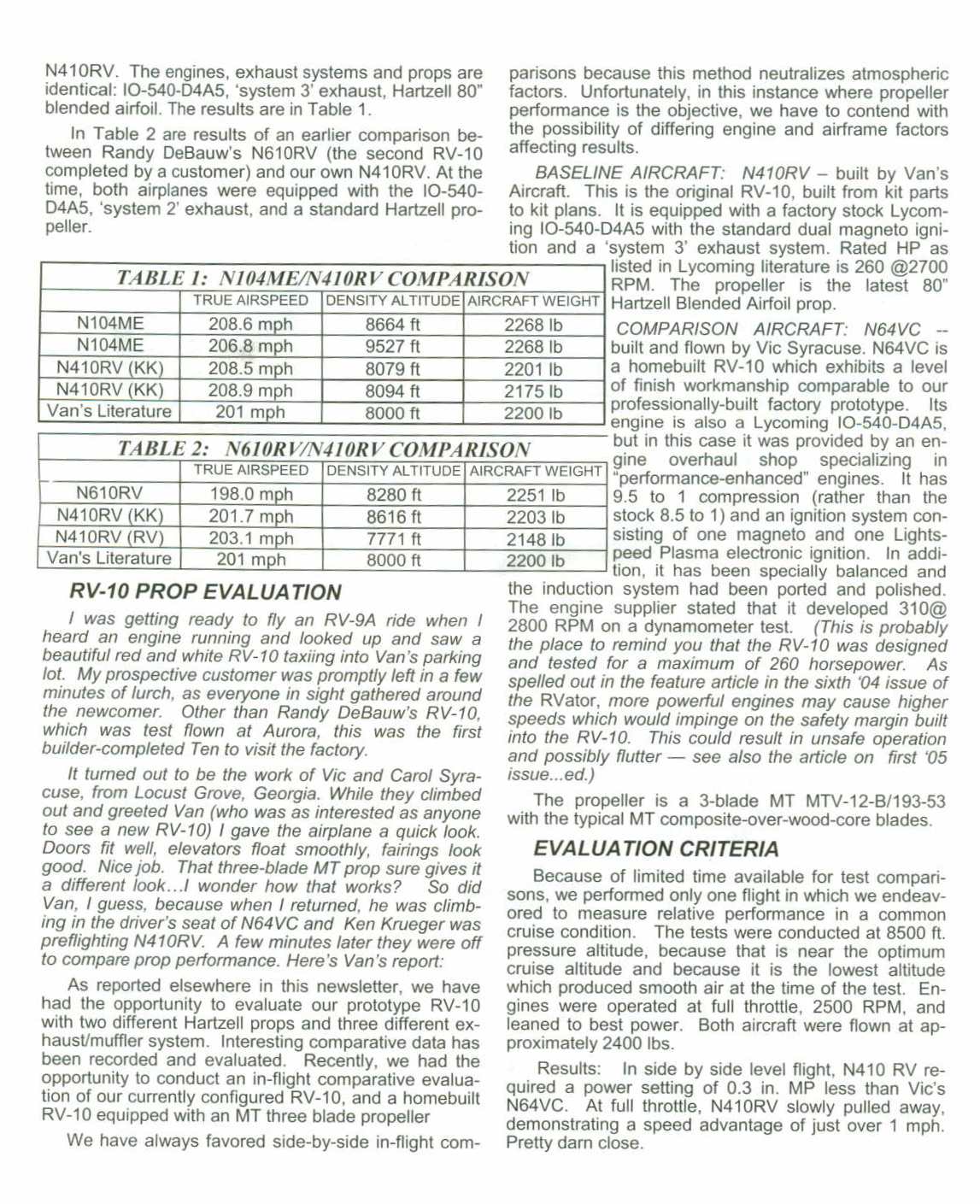

rv10builder(at)verizon.ne
PostPosted: Thu Mar 13, 2008 6:38 am    Post subject: Performance of Hartzell Blended Airfoil Reply with quote
this got bounced last night.
Have the full report on my site if any one is interested http://rv10builder.net/test.aspx
Pascal
