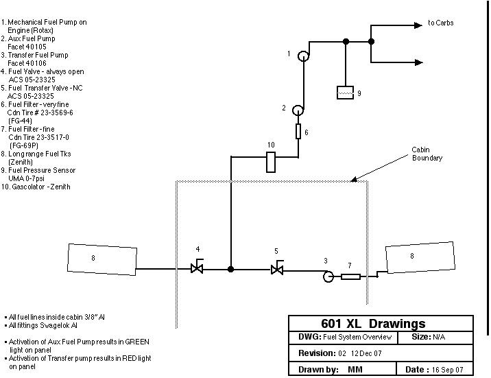

PostPosted: Fri Mar 07, 2008 6:18 pm    Post subject: Fuel System Questions Reply with quote
John:
Like you I am going to use the 1/4" line from the tanks to the fuselage
then go with 3/8" Al inside the cabin, and after the gascolator, which is
mounted in the engine compartment (on the firewall), go with 3/8" tubing
to the Rotax fuel pump.
My reasons for 3/8" are:
1. reduced (significantly) friction losses in the line which means lower
pressure drop from the tank to the pump so less chance of vapor lock
2. 3/8" is much stiffer then 1/4" so a more robust system
3. My last kit (Ultravia Pelican PL) used 3/8" from tank to engine (same
engine) and it just seems like a good idea to me to do the same on the XL.
I am using Swagelok Al fittings for all connections. We used Swagelok
fittings exclusively at the Nuclear Plant where I worked (good
reputation).
The Swagelok fittings come in any size combinations youn can imagine
including from 1/4 inch rubber to 3/8" Al. You can Google Swagelok to get
your nearest distributor.
Mike
