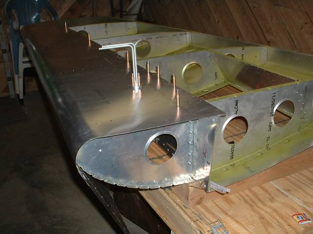

I'm about to finish the left outer wing panel of my HDS.
Does any of the gents here know where to position my pitot tube?
I intended to place it just outboard of rib #7 behind the main spar. Does that sound reasonable?
Same question with the aileron trim tab. I intend to place it between rib #8 and#9. Is there any advantage/disadvantage between a recessed style Trim tab and a board (like on Larry Mc's website) ?

Pete-
Pitot installation location is on page 33 of the old manual. Picture
attached. Hope there isn't a date stamp on it!
