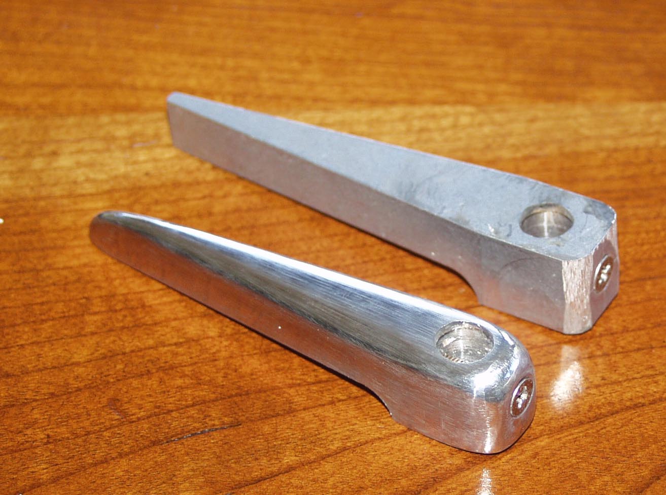

Here's a little before and after I did just now while waiting for the wife to get more beautiful.
I'm thinking that for sorta a lock, instead of leaving the "button" sticking out on the outside to push in to release it, I might shave it off so that it's recessed, weld a cap on it, and then you can insert any key, etc. in it to depress it. Not much, but somewhat of a deterrent -- and more aerodynamic, weather tight.
Later, - Lew

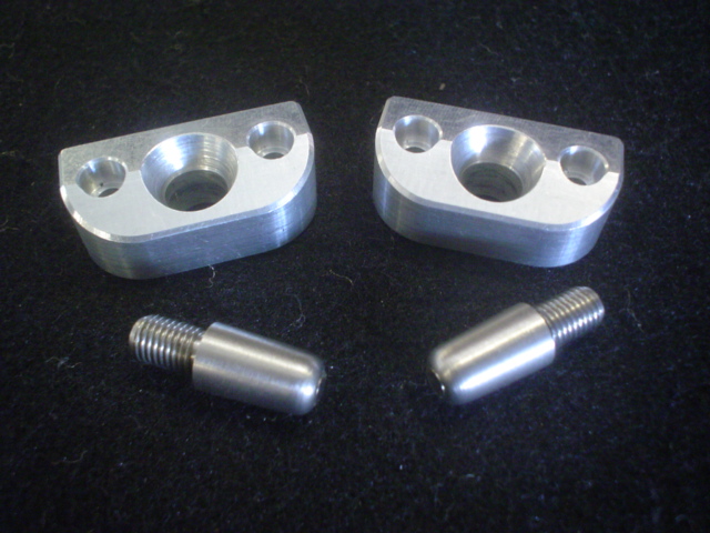

One of the problems i found was the way they mounted from the backside which made it difficult to mount and adjust. i made a similar part but made it screw in from the front. i fabbed a backplate with platenuts and ovaled out the holes in the doorframe to allow future adjustments.
steve dinieri
