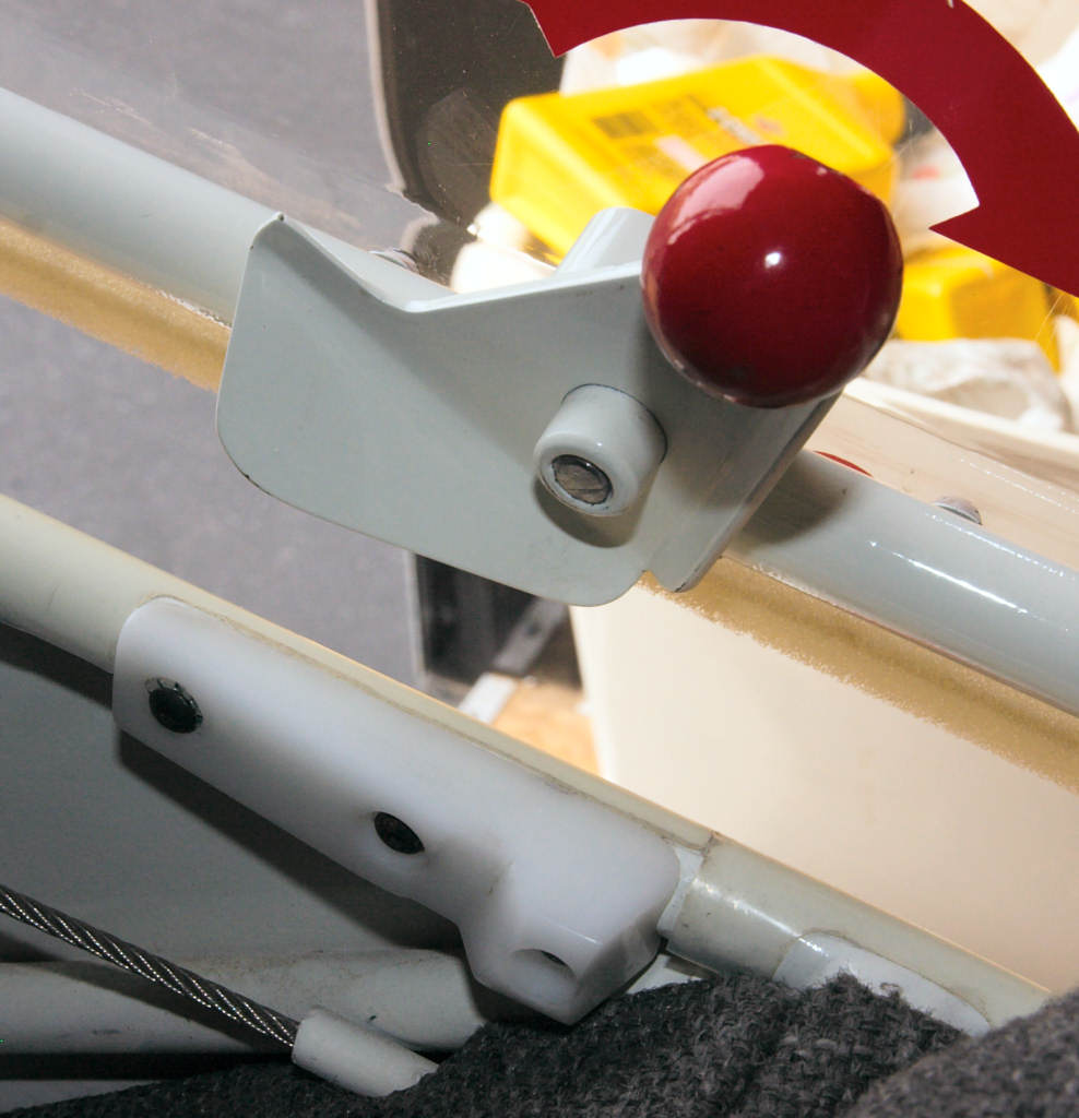

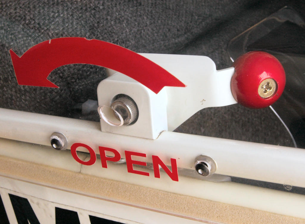

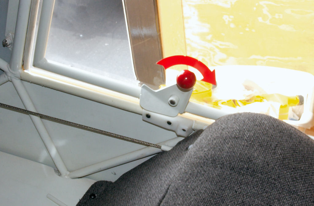

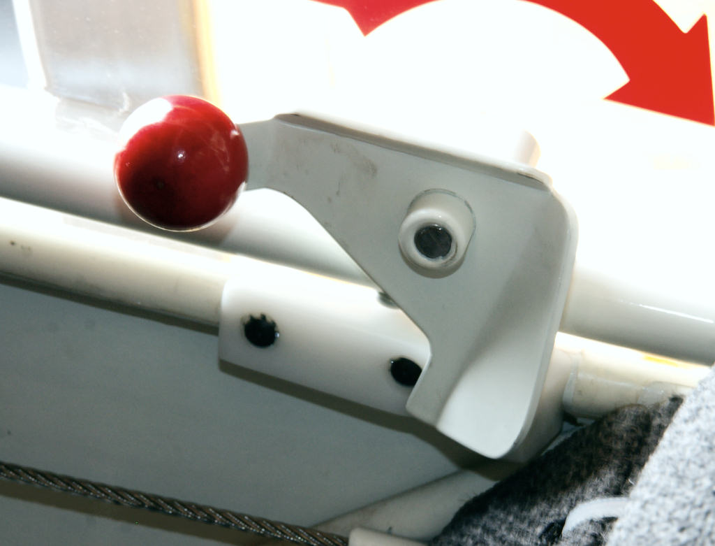

Attached please find the promised door latch pictures. The
lug in photo 2 was bought with Murle's kit. I couldn't make his kit
work because the latch wasn't long enough to reach my sill. (It could
have been made to work with some tube bending and counter-sunk
screws.) I made this latch because it self aligns and "snaps" when
closed. I used wave springs to provide enough friction to keep the
latch where you left it last.

Guy,,,That is some nice work..Steve Shinabery N554KF KF2

My window is recessed along the forward edge, flush along
the top edge, and overlapping along the bottom and aft edges. My
window doesn't bow because it's a bubble door, and therefore
incredibly stiff, with or without the frame.

Now that is a nice simple latch.
good looking too.
no linkage and SIMPLE.
I think it would be decent for egress as well on float plane ops if you end up inverted. Sad Sad Sad

Oh my. I can't even imagine what they would cost. It took
forever! I could tool it and make 1000 to get the price down, but I
don't think the market's that big. Oh well.
