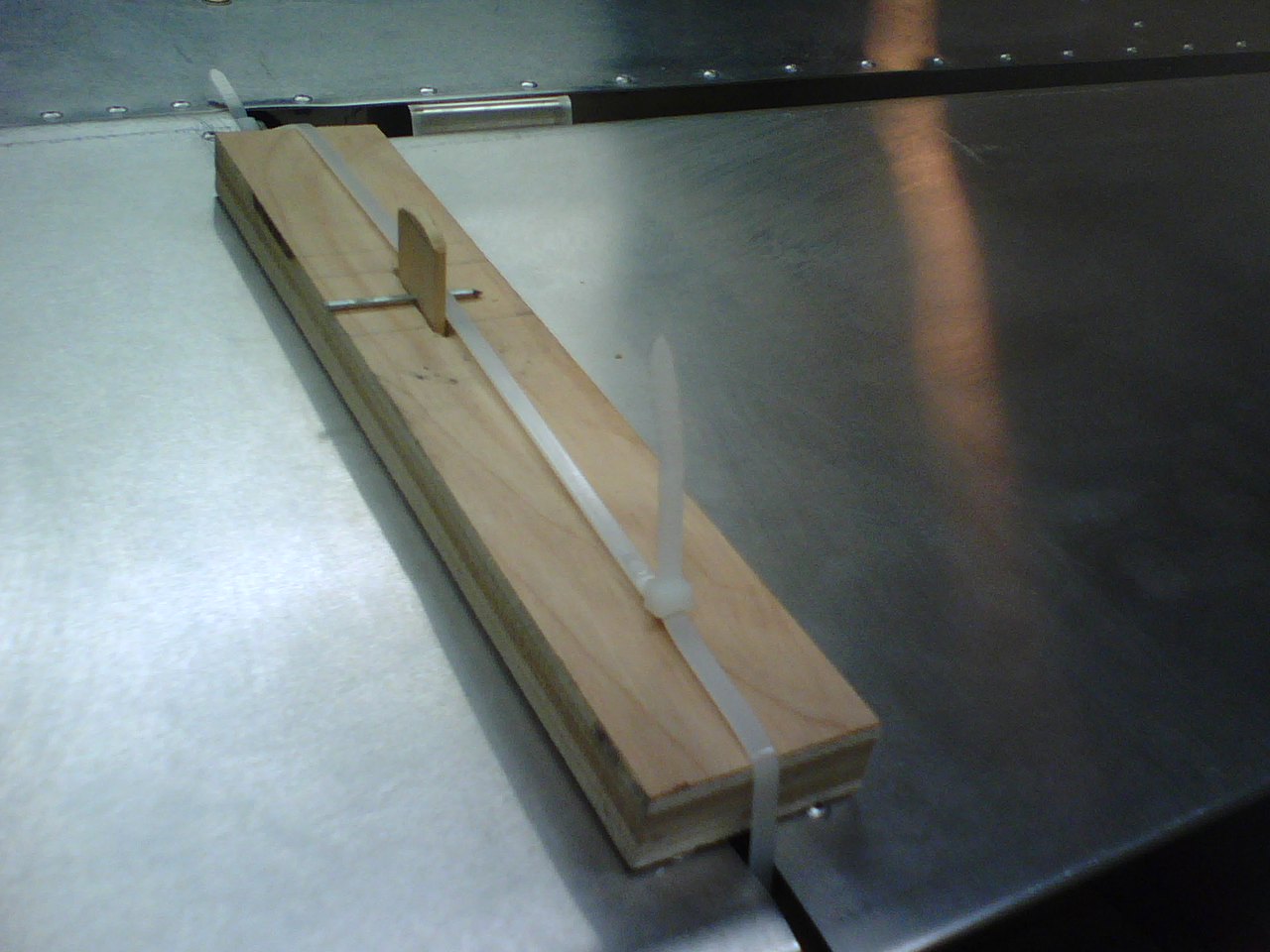

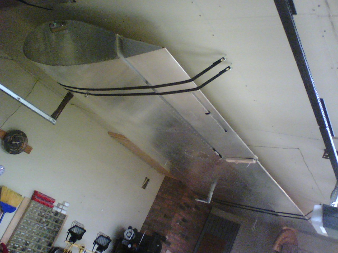

Right or wrong my left wing is riveted and hanging from the ceiling with straps. All the plumbing and electrical is in and functioning.
Fixture to hold flap and aileron together. The ty-wrap goes around the head of the bolt on the aileron and pulls the wedge forward.

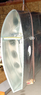

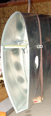

I store the wings with the nose ribs facing down. They are in little
carts made with harbor freight wheels and plywood from the Zenith
shipping crates. This doesn't put any load on the ailerons.

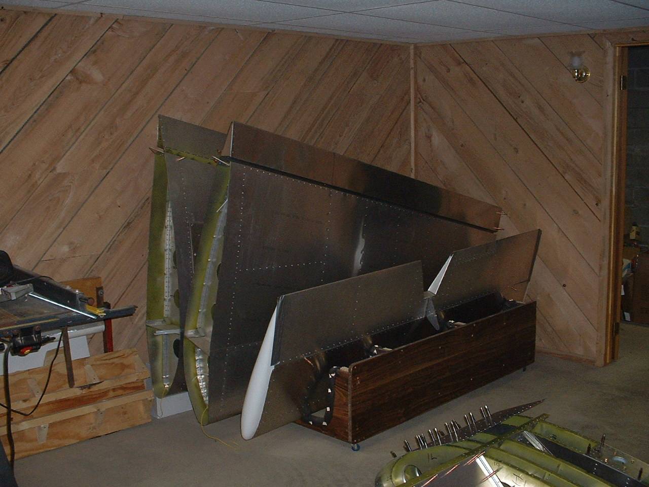

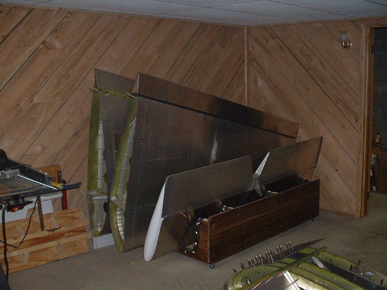

Since I'm polishing, I left the ailerons clecoed to the wings so I could polish them before making cuts to install the aileron trim.
My storage rack is the same basic concept as Paul's or Larry Macs- nose down.
My wife's aunt said "Anybody want an old entertainment center?" and it hit me. Take the doors off, put casters on the back corners, cut cradle openings and line them with water pipe insulation and you're done- 3 hours build time shown in my log. Total outlay less than $15 for bed casters and a bag of pipe insulation.
This is an old picture- all assemblies I've brought upstairs over the years have shown no ill effects from storage in this manner. If you have curious little kids or big dogs you might want to go with the overhead option.

You guys have all found good solutions to the storage issue. In my case, I'm hanging them from the rafters in my hangar (at home) using lengths of rejected seatbelt webbing. I hung them nose up with wood blocks set in the rear spar channel to distribute the forces.
Someone on the group described using a shop crane and sling to support the wing while fitting it to the fuselage. Knowing my luck I just figured I'd damage something if I left the control surfaces on while trying something like that. If I was sure I'd have enough help on hand I wouldn't worry about it. I fit the flaps and ailerons beforehand, so all I did was pull the hinge pin on the flaps and de-cleco the ailerons. All the wiring & etc (less control cables) is in the wings and the aileron pushrods are pretty close to desired length. Hopefully it won't be a big deal to do the final installation.
