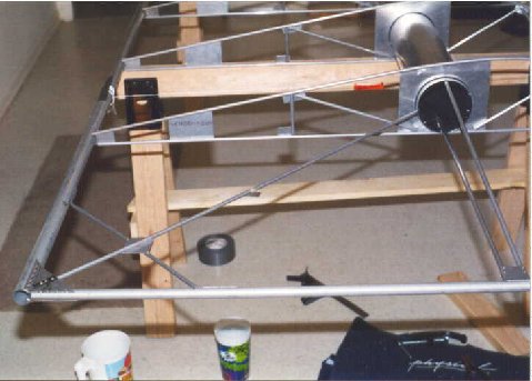

PostPosted: Tue Feb 26, 2008 10:43 am    Post subject: bow tip diagonal braces (was structural failure) Reply with quote
Hi Ben,
My plans didn't call for tie-wraps, here is a picture of my braces.
Will Uribe
El Paso, TX
FireStar II N4GU
