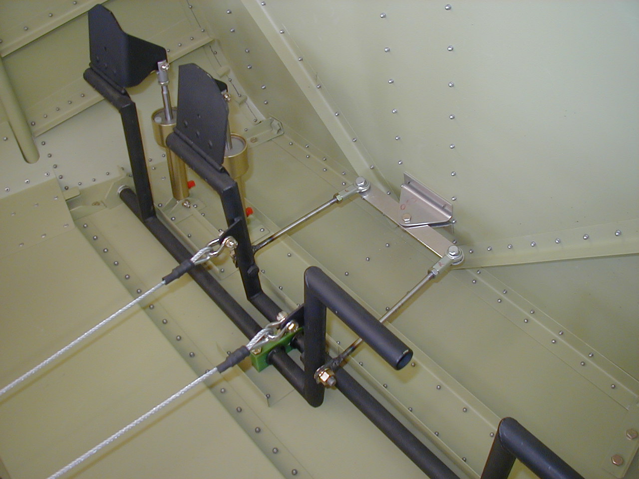

Another neat option for keeping the pedal from flopping is this balance bar (picture attached) that another TD builder came up with. I saved the picture off a website for future reference and don't remember who the builder was (owner of photo: feel free to identify yourself and claim your elegant solution!).

billsewell(at)gmail.com
PostPosted: Thu Feb 28, 2008 5:41 am    Post subject: Attaching rudder springs for TD 601XL? Reply with quote
Looks like a picture from my site. Here are some more: http://n601bz.com/ch601xl/Fuselage/Control_Cables/043005.htm

craig(at)craigandjean.com
PostPosted: Thu Feb 28, 2008 9:57 am    Post subject: Attaching rudder springs for TD 601XL? Reply with quote
The V block on the nose gear (and maybe the two-spring approach for a TD) would self-center. I don’t think the balance bar would do that. Is that true and is it a real issue?
PostPosted: Thu Feb 28, 2008 12:12 pm    Post subject: Attaching rudder springs for TD 601XL? Reply with quote
In flight the air flow over the rudder tends to center the pedals, on the ground keeping the airplane going in a streight line tends to keep them centered (assuming of course that everything is correctly aligned).
