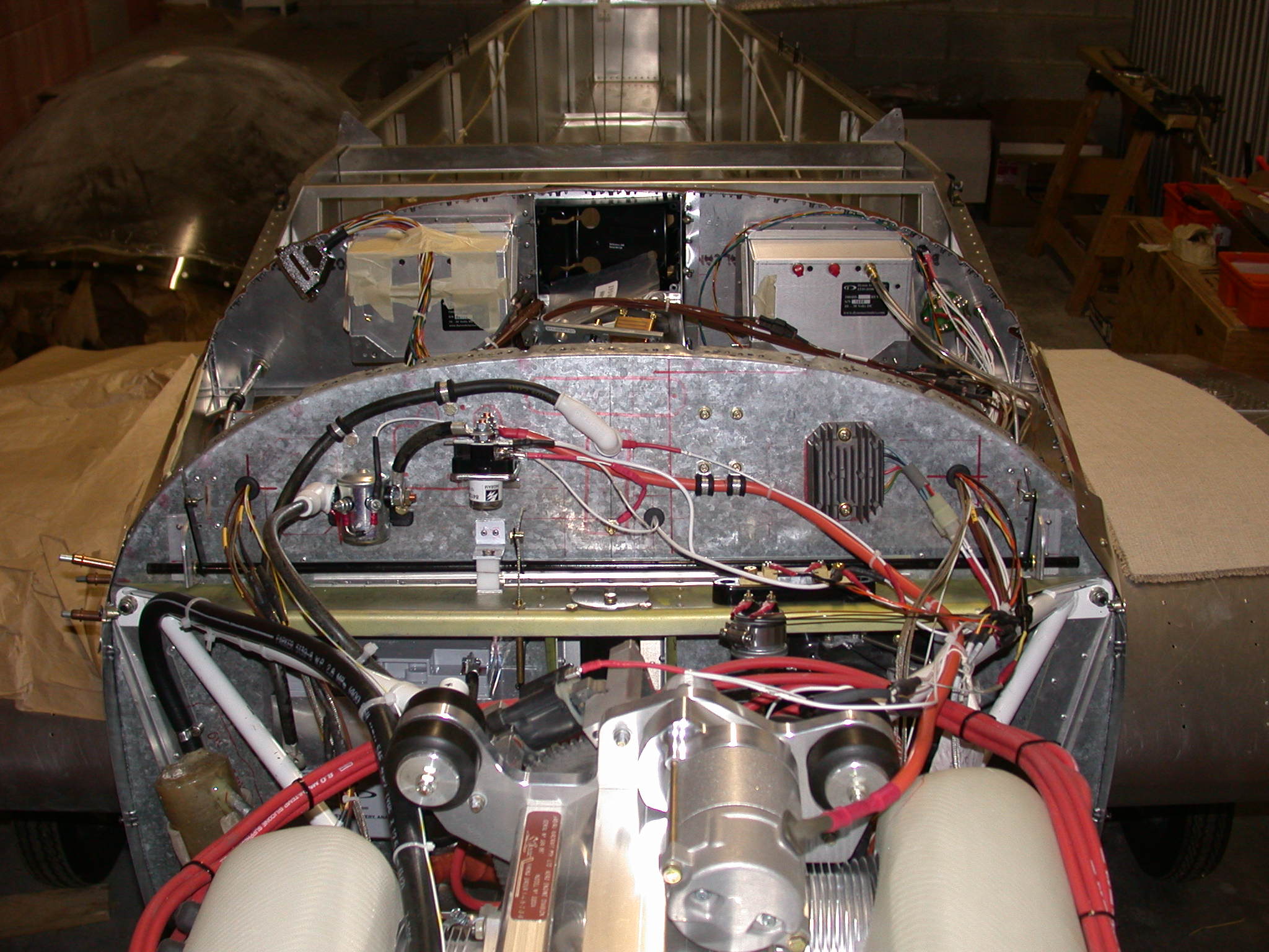

jeffrey_davidson(at)earth
PostPosted: Mon Feb 18, 2008 5:34 pm    Post subject: Electrical setup for my 3300 Reply with quote
As I remember, it came from B&C Specialty and had the diode already wired up
saving just a bit of extra work. I have also used Terminal Town, Aircraft
Spruce, and others for electrical stuff. And yes, I mounted the two
solenoids close together. A picture is attached.
Jeff
