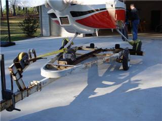

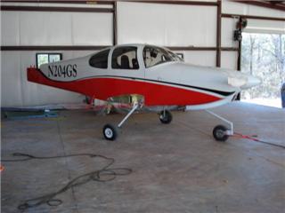

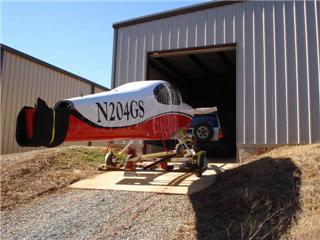

Yesterday I moved the plane to the hanger for final assembly. The trailer
is now available for anyone in the SE US to move their plane if there is
anyone interested.
Gary

Would you kindly elaborate a bit? How did you get the plane onto the
tailer? Is there a channel that the nosewheel ran in?
Is there some way those who are especially interested could get a
look at the wheel mountings in a little higher resolution (like email)?
Marlys and John Ackerman 40458

Very ingenious use of a boat trailer and a great looking plane. I do worry the hanger door in the second picture is too narrow once the wings are on;)
Vern Smith (#324)

Gary,
What is the scoop on the front air filter/scoop. That's a mod I
have not seen before. I am using an SJ cowl so I looks totally different
than mine.
BTW you should probably check to make sure the N number is large
enough for the FAA.
You are almost in the air!
Robin
speckter(at)comcast.net
PostPosted: Wed Feb 20, 2008 1:23 pm    Post subject: Moving Day Reply with quote
Doesn’t your 10 have folding wings?
Gary

PostPosted: Wed Feb 20, 2008 1:24 pm    Post subject: Moving Day Reply with quote
I have a Barrett cold air induction and fabricated my own cowl.
Yes the N number is 12"
Gary

The trailer is a tilt bed. I tilt the trailer to load the nose wheel into a
channel like for motorcyles. Then untilt it and pull the mains up on ramps
into the wheel pads with the boat winch. The ramps come with the trailer is
anyone is interested.
I have very high rez pix for those who are interested.
Gary
