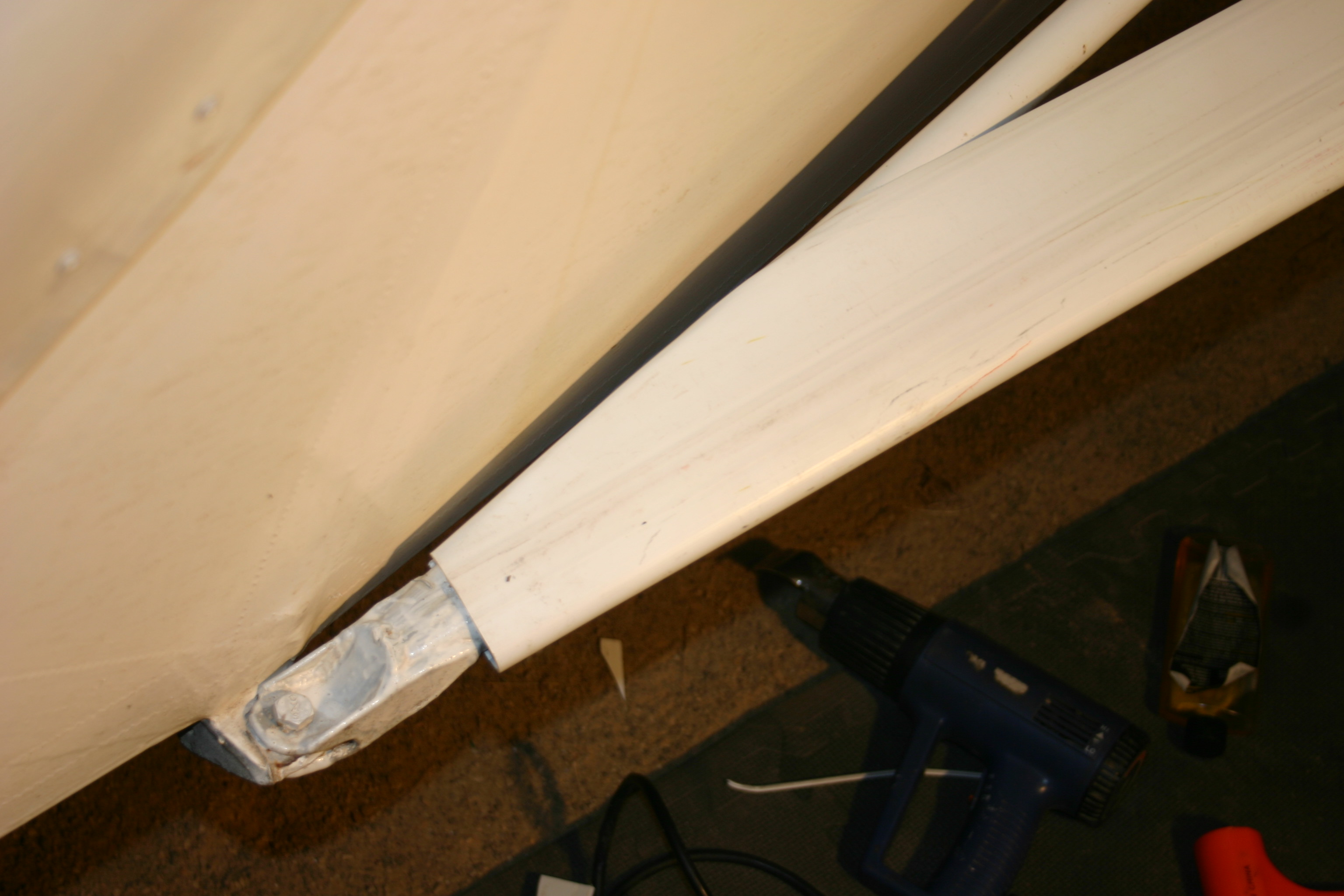

Was wondering what is out there to put on the Jury and Hoz. Stab tubes to clean them up. I really want something that does not require putting wood on them and covering with fabric. I have started installing the PVC covers on the Struts. Looking better.

Lee, Where did you get the PVC for the strut covers? What is the material designed to be used for ?

Blue Sky Aviation has light weight PVC foils for the small struts. They also have rod end covers.

Mine were made from 4130 streamlined tubing from ACS, PN
03-11300. They were slipped over then end, (where applicable,) then
filled with expanding foam. Joints were glassed.
