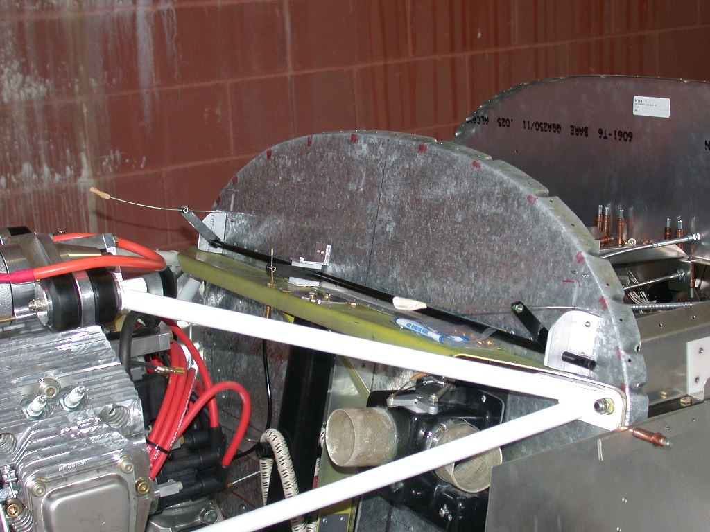

through a hole in the shelf down to the carby. I picture of my installation
in progress is attached.

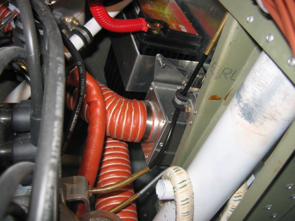

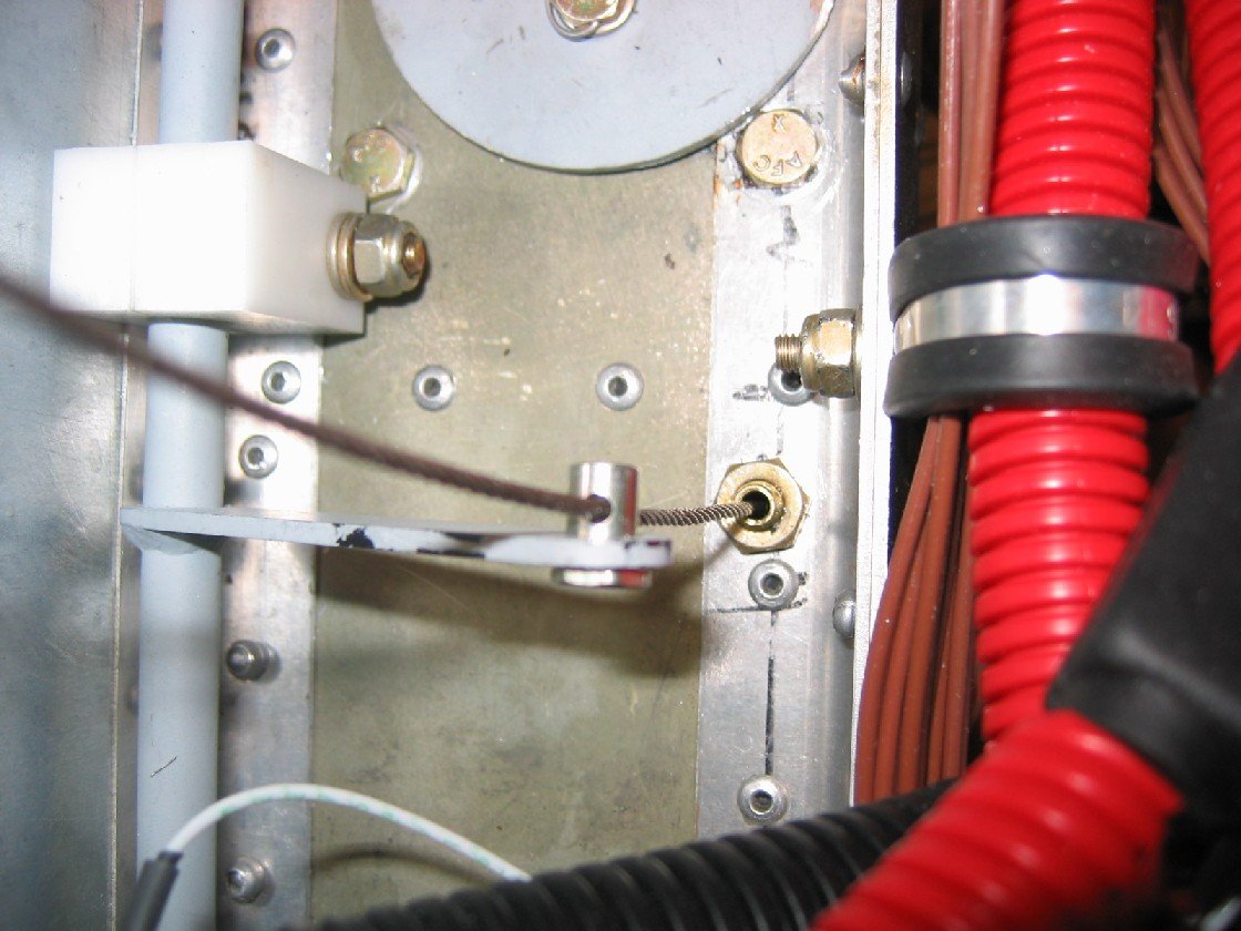

I don't have much to add to what Jeff already said other than to add a few close-up pictures of mine with the new firewall shelf configuration. I did not measure my degrees of motion, but there is enough to fully actuate the throttle from stop-to-stop with some to spare. Also, the brass cable adjuster going into the carby needs a bend to avoid the nose gear strut. As recommended by Jabiru, I used a tube bender. Just make sure not to make your bend right where the brass transitions from thick wall to thin wall. I will break there if you do. Look down the inside of it to see where it transitions.
