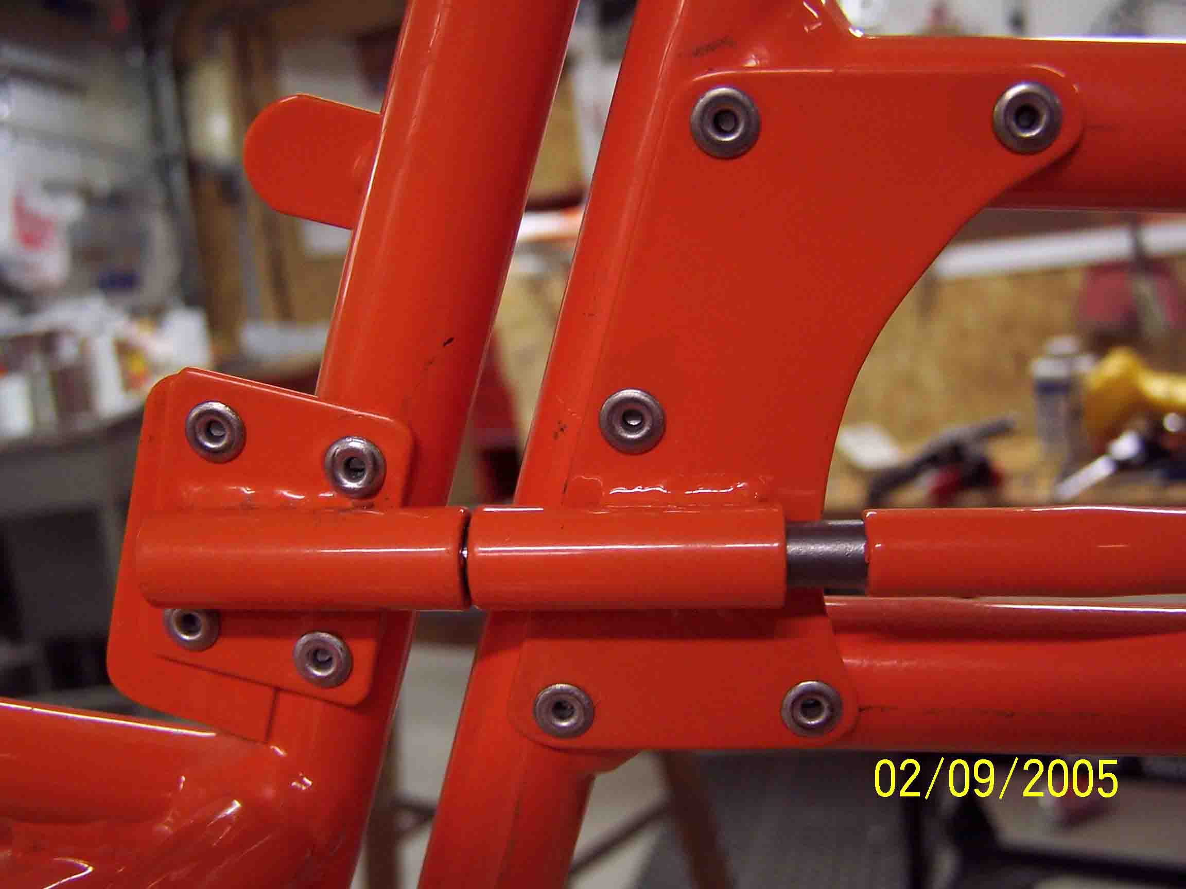

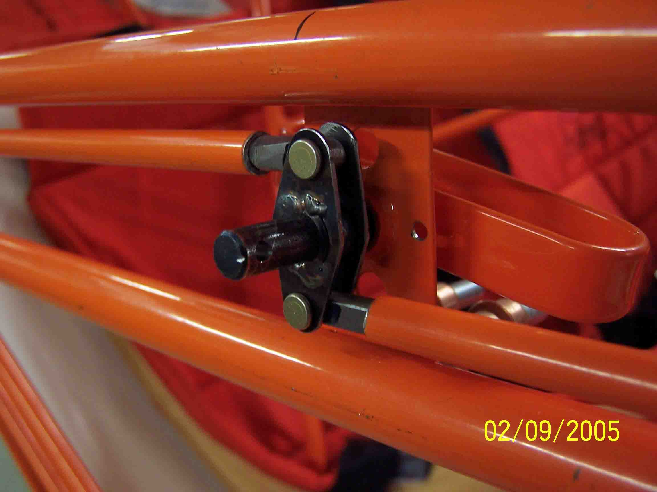

PostPosted: Mon Feb 11, 2008 4:39 pm    Post subject: weight Reply with quote
Do you suppose that John McBean still sells the double-pin door latch
kits? I've got 'em on my Speedster, plus the bottom latch...three
points of contact with the door jambs, and the double-pins are almost
foolproof. I doubt that the door would EVER come open short of
wadding up the fuselage.

Lynn, Are there any photo's or drawings of the "double pin" latch?

Here are two shots that I have, Pat. The kit that I had required
several parts to be made from stock that was furnished. Instructions
came with the kit as supplied in 1994.
Above: This is the bellcrank that transmits the center, turning
motion into fore-and-aft rods that engage pins into sockets in the
fuselage.
Above: On the left is the fuselage socket (fastened with 4 SS
rivets), with the pin engaged, and on the right is the guide
(fastened with 5 SS rivets)
and the actuating rod. I hope this makes sense. It's hard to get the
overall picture of how it works because I zoomed in a little too
close when I shot it.
Lynn Matteson
Grass Lake, Michigan
flying w/470+ hrs

Not to be a critic, but riveting into the airframe tubing isn't really a good
idea, nor necessary since you already have the tab there.

PostPosted: Tue Feb 12, 2008 2:42 pm    Post subject: weight Reply with quote
Lynn,
That is the best latching system I have ever seen! I wonder why they did
away with it? Jeff CMH Classic IV
