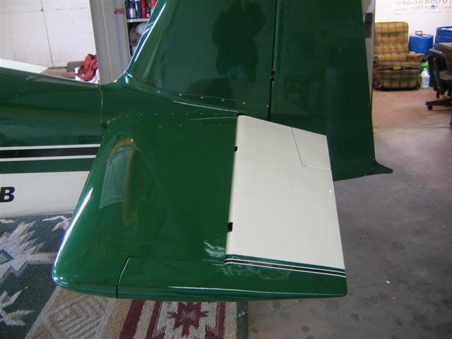

Paul... I did a aluminium tab on the bottom of the rudder... easy to adjust... with a shape that gives the plane a little longer look (I think ha).. However, some say not the best place for the tab efficiency... See attached shot...

| Back to top |

Very nice look...works well I assume?

Yes..seems to work pretty good... Took couple flights to adjust..and ball in center... It's pop-riveted on the left side of the rudder bottom with 3 rivets..
