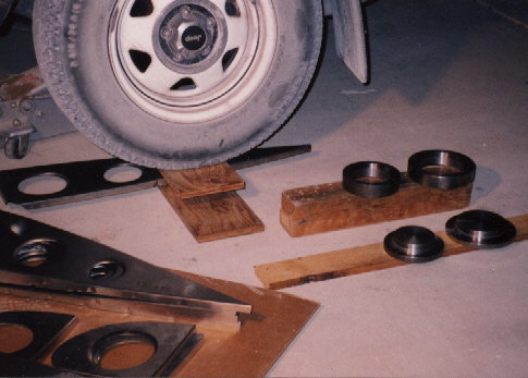

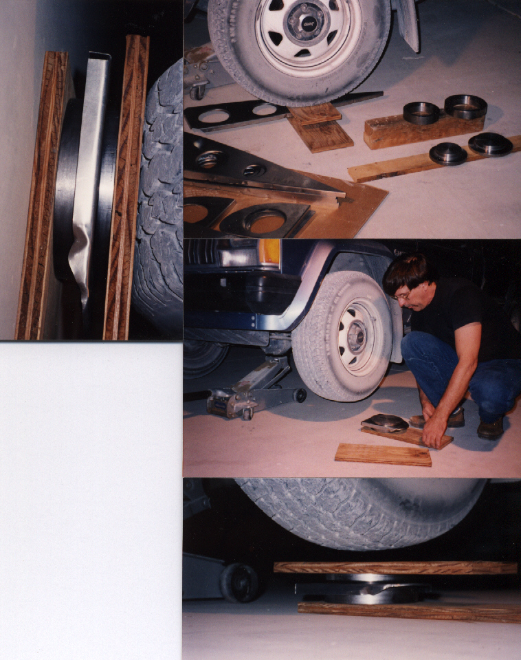

Theres a website..zenith ch701ch801.com. click on
side bar where it says builders links
then click home made tools. Theres a new site
called Flanging Dies Construction.pdf by Ron D
Leclerc. Shows how to make flanging dies step by
step and pics to boot. Do not archive

PostPosted: Wed Feb 13, 2008 2:08 pm    Post subject: Hole Flanging Reply with quote
What metal dies are those Ron?
Randy, Las Vegas

PostPosted: Thu Feb 14, 2008 10:15 am    Post subject: Hole Flanging Reply with quote
What pain?
At the time I didn't have a 3/4" bolt, nut & washers, I didn't have "metal
plates" prepared. It would have taken longer to find or buy and prepare all
that stuff than what I did which cost me "ZERO".
I had the jack, the junk Jeep pickup and a couple of pieces of plywood.
Once the jack was in place and the wheel jacked up, all that it required was
cracking the jack handle, a nice slow descent, then jacking back up about 1"
each time to move the dies to a new hole. It took far less effort than
pumping a handle on a shop press along with staging proper height benches on
each side of the press to support the parts! But I did have to bend over,
but I can always use the exercise.
And, I didn't have to "juggle" any of the parts around. With your "nuts &
bolts & plates" how long does it take to get things positioned for each
press, especially one in the middle of a 12' wing spar web?
Another added benefit for a klutz like me is that working on the driveway,
at zero altitude above field elevation, I didn't drop a single part or die!!
Of course, if you set the dies on edge, they roll down the driveway grade
and you have to chase them the first four or five times until you learn to
set them flat.
By the way, I could have loaded all the parts in the truck and used the
three or four shop presses I had available to me at the airport, but why go
to all that pain?
This all happened a long time ago, I now have a 20 ton shop press at my
plant, and "Old Blue" the Jeep is long gone, the dies are out on the "Zenith
List" circuit, hopefully helping other builders. I believe dies, properly
made of other materials, do a fine job. But I'm pretty darn sure these dies
will not crack!
To those who have not seen the full size pics of this "kitchen sink
technology" here they are again. I know this is "old hat" to veteran
listers, so I apologize in advance for the repetition and download time.
This all happened before I owned a digital camera. The pic is a scan of
film snapshots shich I call: "Gravity powered lightning hole flanging
press".
Best regards to all,
Randy, Las Vegas
