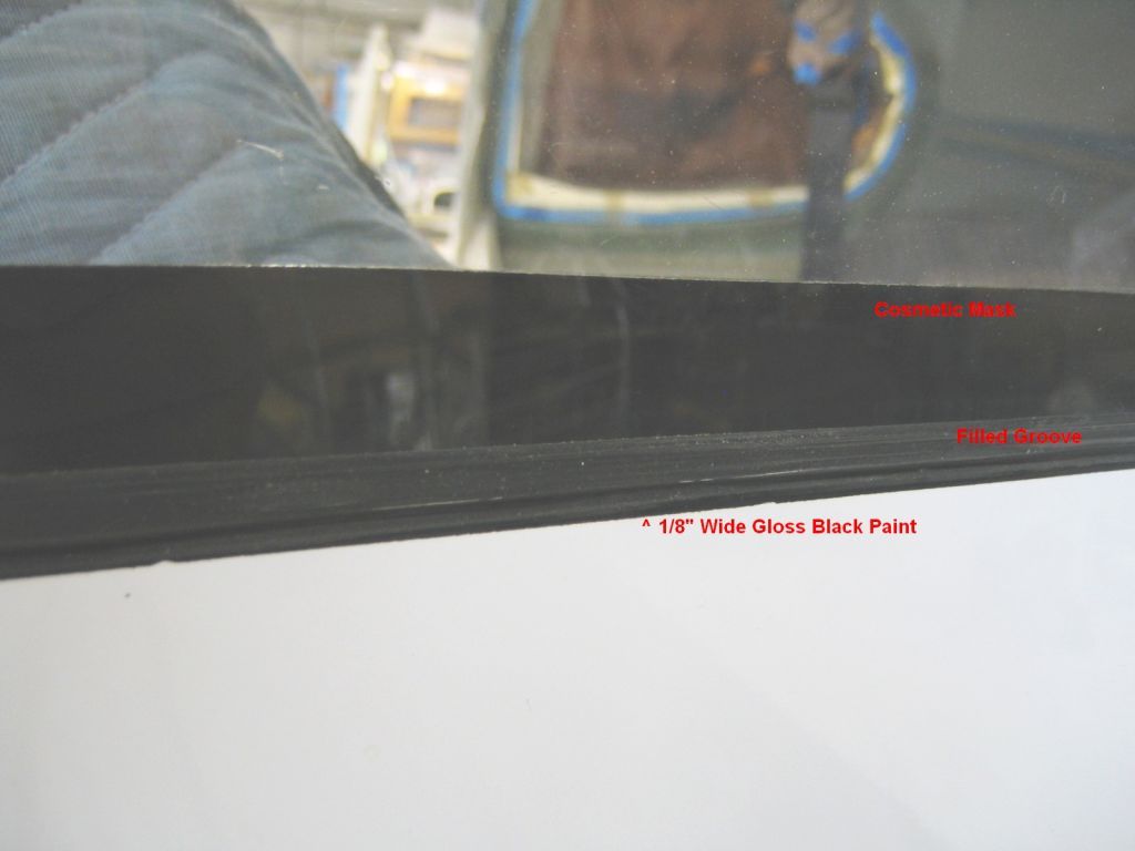

4. could you provide a close up picture of the finished edge?

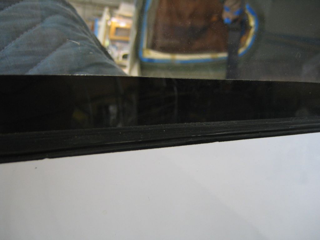

Here are some pictures. The black all blends together so one picture is
edited and labled so you can see the different parts. Real lilfe looks more
like the unlabled picture.

Thanks for the information and pics. Zooming in on the pics gives
enough detail to see how the bead lines up on the outside. I think
with your help I can make it look good. I ordered 4 tubes from
