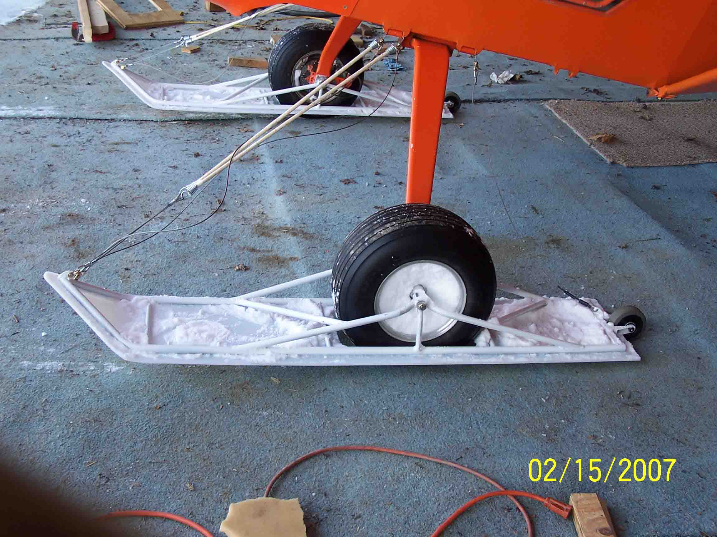

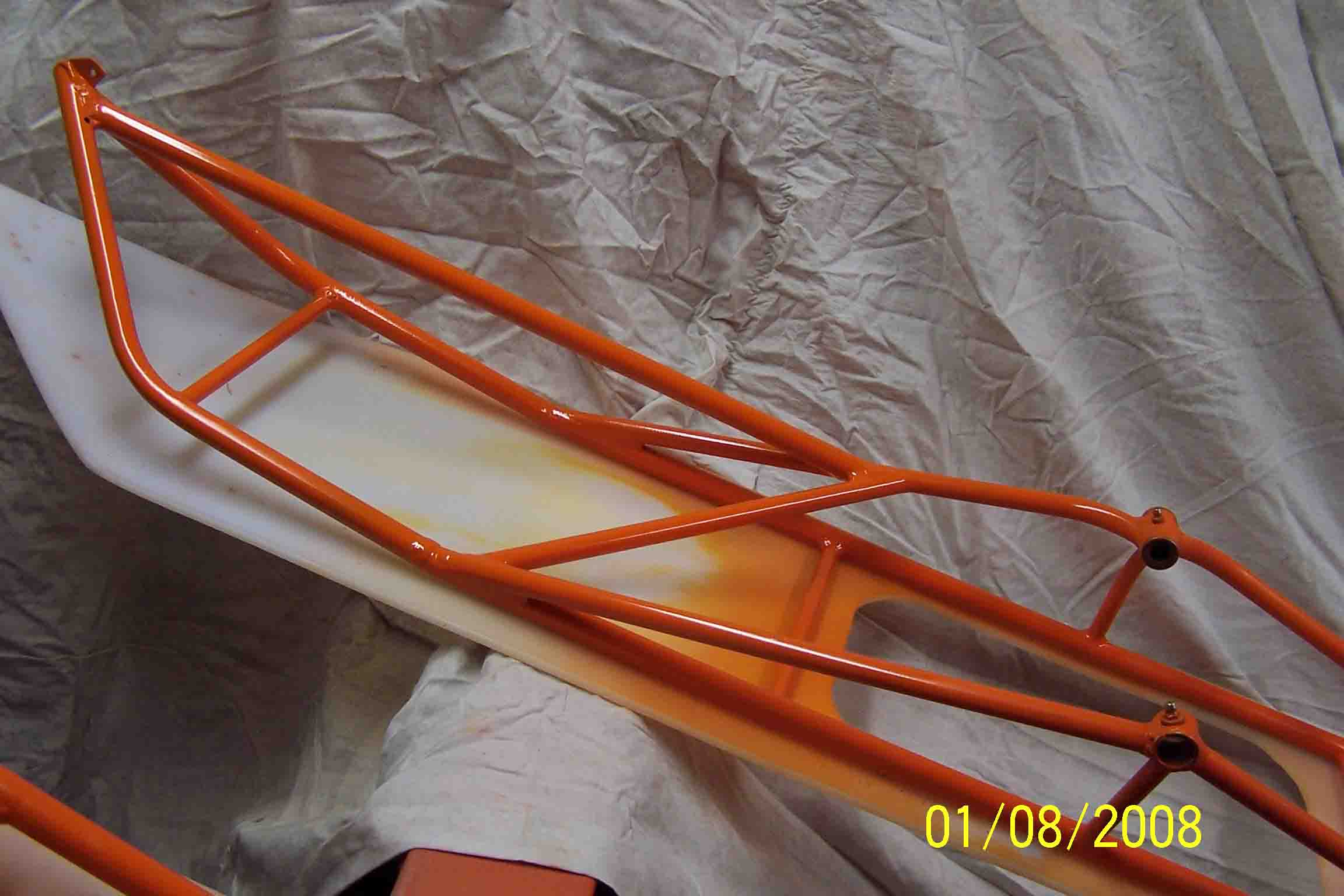

I built a set after looking at pictures and drawings of other folks'
skis. Michel over in Norway sent pics of his, and John Perry, and
Dave in Canada helped as well. I just borrowed the best of all the
ideas and went with that. I think that the pics John sent me were of
skis built for an Avid. Here's mine:
Above: Here's the skis as built
This is just after adding a brace to the tip. I had an encounter with
a frozen snowbank that dictated adding this brace. The "encounter"
bent the skis up just in front of the original diagonal braces, and
actually made the skis slope up more, and I liked that, so I added
this new brace to insure that the shape didn't change when the next
encounter occurs....and it probably will. : ) Of course I cleaned up
the overspray after the painting was done, and re-riveted the shoe to
the ski.

Lynn, Thanks for the pics. Look similar to the ones I have pics of.
