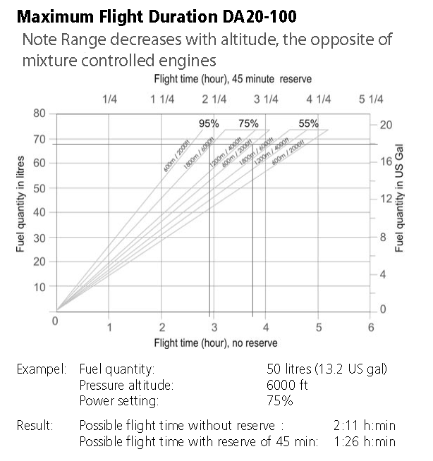

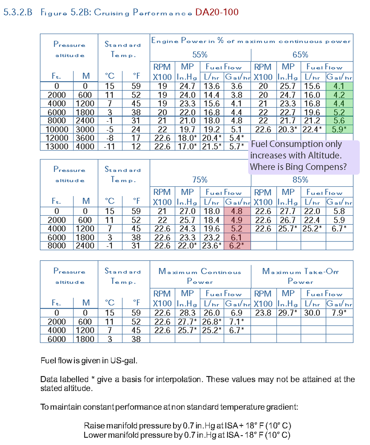

I just happened upon the new Katana DA20-100 POH with official
performance charts of the certificated 912 and 912S engines. The AC
also has a Hoffman CS 2 blade prop. The charts clearly show
progressive increase in fuel flow with altitude at a set %max power.
This is of course the exact opposite of Lycomings and Continentals
and the Rotax/Bing claims.
Can someone please show me how this interpretation is wrong (no
handwaving please, just documented facts).
Maybe the GreenSky HAC or real fuel injection is the way to go!
I attach some charts which show the data

Are you sure you have the right charts? The second chart
shows a range of 1900 - 2380 RPM which seems unlikely
for a 912.

Followup-
JStewart: Think prop rpm, not engine RPM
NB: The data I appended was for the DV-20-100, not the DA-20
engine is the rotax 912S3

I think you are an experienced thoughtful guy, but what does it mean
to have an opinion on these carburetors <"In my opinion, the Bing carb provide *some degree* of altitude compensation due to the constant
vacuum design. ">. On the other hand, what you told Ivan is absolutely
true from my hands on experience with both engines,
We are not talking about health food nonsense or placebo. We must talk
engineering, these are deterministic systems, they either work
or they do not work.
The DATA says they do not work, in fact, they perform WORSE
than just leaving full rich on a Lycoming.
I may well be wrong due to lack of sufficient data, but the DATA
so far says the 912S3 is CONTRACOMPENSATING.
Please explain to me my error. Opinions can not count
Has anyone performed actual, careful engine performance flight
test. I'd like to, but my new EFIS has the output of my FloScan
bouncing all over creation to the point where it is unusable.

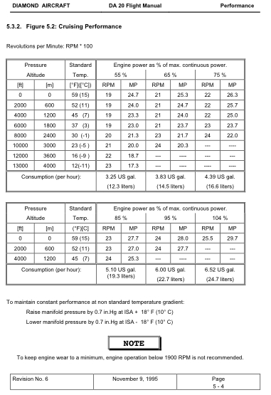

I do not know where you got your data but attached is a snapshot of the cover page from my Katana Manual and the page with the performance and fuel consumption table data.
See attachments.
As you can see there is nothing indicating a variance in fuel flow AT A CONSTANT POWER SETTING regardless of variations in altitude.
Per my training, knowledge and experience, fuel flow is a nearly linear function of power being produced, regardless of altitude at which it is being produced. I have never had a fuel flow meter on any of the airplanes I've owned with the 912 series engine but have flown a good bit of cross country time in them at known power settings at widely varying altitudes, and the fuel required to fill the tank after these flights has always been within 1/2 gallon of my projections based on time and power setting during these long continuous power flights at varying altitudes. Also, the EGTs on my 912 read pretty constant at a constant power setting at varying altitudes.

Hi Tom,
Again, the data was for the DV-20-100 912S3
not the DA-20 912.
Yes my DA-20 manual looks the same (I have about 150 hours in them)
but the manual does not specify what altitude the measurement was
made, and since my time was in a rental, I did not bother to try.
Re the DA-20 manual, certainly you dont believe the carbs compensated
up to the max altitude of 13000? Nobody I spoke every claim claimed
they compensated for altitude over 8000, including Eric Tucker who
I spoke to at Oshkosh 2005 at some length when he was hanging out at
the CPS booth.

Steve,
I think we both know what a carb is supposed to do.
You are just off track when you compare aircraft to motorcycle
applications. I cant think of the last time I gunned my rotax throttle
at the stop line Wink
The constant "depression" in Euro-speak or constant pressure in USA
English is in fact supposed to provide altitude compensation, the goal
in the case of the Rotax, to run just rich of peak at all altitudes.
This is the stated and advertised goal of using the Bing 64 instead
of a single conventional carb.
What is in fact happening is that the engine IN FACT is running richer
and richer with DA when it should should reduce fuel flow to match the
reduced air mass charge.
As for increased TAS with DA, well you don't need a Rotax for that!
A rubber band motor will do exactly the same thing!

rampil a écrit :
Hi Gilles,
to have an opinion on these carburetors . On the other hand, what you told Ivan is absolutely
Ira,
Not sure what your point is, but what I'do first is double check the
printed data.
Especially when they seem indicate something contrary to engine physics.
I may have missed something, but could you provide a link to this
particular manual ?
Well, unless someone can prove the following data wrong now, this
Altitude compensation is a complete crock.
I'd say it the other way "unless you can prove our engines and carbs are
wrong, these data you're referring to are not reliable".
Best regards,
Gilles
http://contrails.free.fr

Gilles,
I wish it were so simple as to have wrong data.
Here is the URL you seek for your own official copy straight
from Austria.
http://www.diamond-air.at/dv20_afm_bas+M52087573ab0.html
I refer you to page 73 in the PDF corresponding to page 5-04 on paper.
- The Matronics RotaxEngines-List Email Forum -
http://www.matronics.com/Navigator?RotaxEngines-List
Ira N224XS
Gilles.Thesee(at)ac-greno
PostPosted: Sun Feb 10, 2008 3:39 pm    Post subject: Disappointment in Rotax 9 series Reply with quote
Ira,
Had a look at the manual.
Concentrated on the 75 % power numbers. The 8000 ft numbers are in close
agreement with every other 100 hp Jabiru/Rotax engine : in the 22-23
L/hr ballpark. At this altitude, 75 % power is obtained with full
throttle and max allowable RPM. Nothing wrong with those data.
Now at lower altitudes, one can choose between different MP/RPM
combinations. The lower the RPM and the higher the MP, the lower the
fuel burn for a given % output. So it is normal to burn *less* at those
settings. Any atmospheric engine behaves like that.
So I'd rather say : at lower altitudes it is possible to burn slightly
less fuel for a given % output. At 1000 ft you also can use the 8000 ft
settings. You'll burn a little more fuel because you'll be at part throttle.
But at 75 % any atmospheric 100 hp engine will burn about 22-24 L/hr at
8000 ft : Lyc, Conti, Rotax, Jabiru or whatever.
At 75 %, our 914 (same carbs) burns around 22 L/hr.
Best regards,
Gilles
