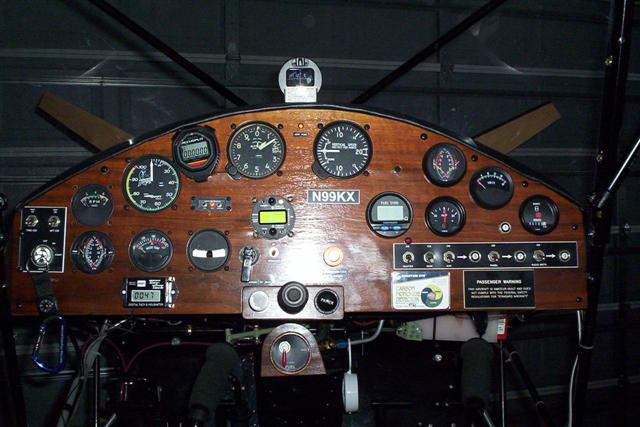

I made the same decision after my ill-advised IMC adventure on the way home from OSH last year. Did not know that the 2 1/4" doesn't feature a ball, but it makes sense as small as it would have to be. That complicates things for me, however, having no 3 1/8" openings to spare and little room to add a new hole. I was hoping to pick one up at Sun-n-fun in April but don't really want to have to reconstruct my panel to accommodate it.

As an FYI...if the 2" unit would accommodate your panel, you could get a free standing ball/bank indicator. They attached directly to the face of your panel. Aircraft Spruce has them for around $30-40.
http://aircraftspruce.com/menus/in/bankindicators.html
This would be a simple fix and allow you to use the 2" ADI.

Yeah, I have one of those Travis. I was hoping to replace it with the ADI. So either way, I need another hole in the panel. It's tight, as you can see.
Marco,
Check out ACS. They have balls that mount to the face of the
panel. You could put the ADI where the 2" ball is now, and put a face
mount ball below it. Plenty of room.

PostPosted: Fri Feb 08, 2008 5:58 am    Post subject: Need advice on TruTrak ADI Reply with quote
Marco,
I removed my 2" ball and installed the UMA airspeed in that hole then installed the TruTrac ADI(with GPS &antenna) where the old 3 1/4 " airspeed was. It works great and everything is within a 6" space.A Garmin 396 is next to the ADI             Dick Maddux
