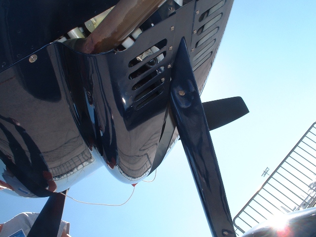

The slot for the lower cowl needs to extend all the way forward, stopping 4.25" from the leading edge of the intake. This allows the cowl to be dropped down then slid forward. I took a picute of Wayne Egerton (Sorry for the spelling Wayne)I plan to install an aluminum panel on mine to cover the front portion of the slot from the gear leg up...Deems has done similar to his cowl.
Rick S.
